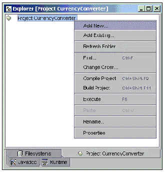

6. Select the Project tab in the Explorer window. Right-click the project name and choose Add New to add new components to the project or choose Add Existing to add existing components to the project.
The Explorer's Project tab displays the name of the current open project. When you first create a project, Mobile Edition IDE opens that project. When you add a new component to the project, you first select a template from the list of available templates, such as a MIDP
MIDlet or MIDP
MIDlet Suite. The appropriate wizard guides you through the steps to create that particular component.

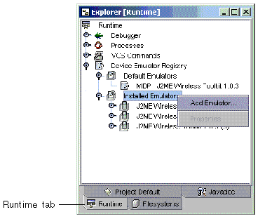

To add an emulator to the Device Emulator Registry:
1. Install the emulator on your system according to the emulator vendor's instructions.
2. In the Explorer window, expand the Device Emulator Registry node. Right-click Installed Emulators and choose Add Emulator.
3. From the Select emulator installation directory dialog box, navigate to the directory that contains the emulator. Then click Add.

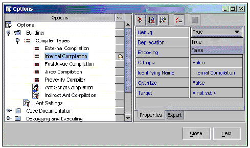

1. Set the Internal Compiler Debug property to False and compile the MIDlet code without debugging information.
You should optimize the MIDlet code before packaging and deploying it. Do this by recompiling the MIDlet code without debugging information. Recall that you set the Internal Compiler's Debug property to False and then recompile the source code. You can find the Internal Compiler from the Tools
Options window, within the Building
Compiler Types node. See Deploying a MIDlet Suite.

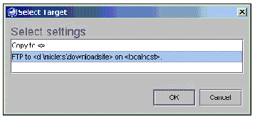

7. To deploy the application, select the MIDlet suite in the Explorer window and choose Tools
Copy File. The Select Target dialog box opens. Select "FTP to <d:\midlets\downloadsite> on <localhost>" and click OK.
The application is sent to the specified FTP site.

Before you deploy the application, you need to recompile the application with debugging turned off. This reduces the final code to its smallest size. Normally, you take this step after completing the debugging process. (See Chapter 2 for instructions on how to debug your program.)
While you are developing and testing applications, you should have Mobile Edition IDE's preverifier compiler set so that its Java compiler uses internal compilation. This setting enables you to use the debug functionality. When you have completed testing the application, you remove this debug functionality by turning off the internal compilation's debug property and recompiling the code.
Keep in mind that by default, the preverifier compiler uses internal compilation. This means that you might have to remove debug functionality and recompile the code even if you did not explicitly debug your program.
1. From the main window, choose Tools
Options
Building
Compiler Types and then right-click Internal Compilation to see its property sheet.
In the property sheet, click the Debug combo box and set its value to False.
