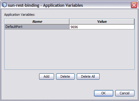

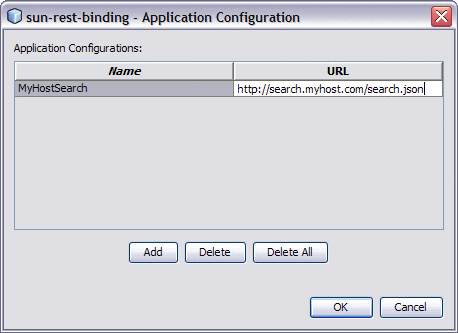

Allows you to define application variables and configurations so you can port your REST applications from one environment to another.

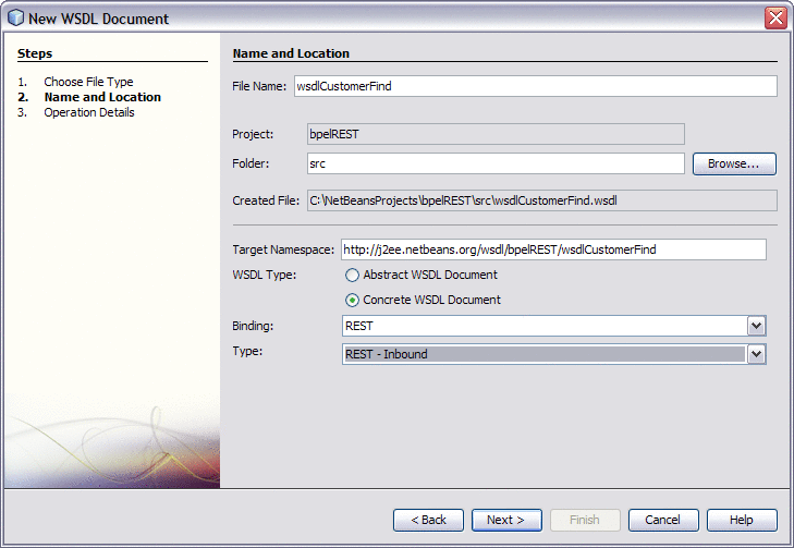

In the NetBeans Projects window, right-click the project or a folder within the project where you want to add the WSDL document.
Point to New and then select WSDL Document.
The New WSDL Document Wizard appears.
Enter a name for the WSDL document, and verify or update the folder location for the file.
Select Concrete WSDL Document.
The Binding and Type fields appear.
For the Binding, select REST; for the Type, select REST – Inbound.
Click Next.

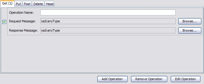

The Operation Detail window appears with the Get tab displayed.
To add a GET operation, do the following:
On the Get tab, click Add Operation.
New fields appear on the wizard.
Enter a name for the operation, and click the Browse buttons to select the request and response message types.
Click Edit Operation.
The Edit Operation Properties window appears.
Enter values for the fields described in Table 1.
To add PUT, POST, DELETE, and HEAD operations, repeat the above steps from the appropriate tab on the wizard.
For the Binding, select REST; for the Type, select REST – Outbound.
Click Next.
Enter values for the fields described in Table 2.

Application Configurations allow you to configure the external connectivity parameters (URLs) for a JBI application and, without changing or rebuilding the application, deploy the same application into a different system. For example, if you have an application that is running in a test environment, you can deploy it to a production environment using new connectivity parameters without rebuilding the application.
The connectivity parameters for the REST BC are normally defined in the WSDL service extensibility elements. When you create and apply application configurations for these parameters, the values defined for the application configuration override the values defined in the WSDL elements. You apply the configurations to the Composite Application by entering the application configuration name in the Config Extension Name property for the appropriate endpoint.
Perform the following procedures to implement application configurations for the REST BC:
Once you create an application configuration, you can modify it as described in To Change Application Configuration Values.
You can create several application configurations, which are all referenced by the names you define. Make sure the REST Binding Component is started before you begin this procedure.
On the NetBeans IDE Services window, expand Servers > GlassFish v2.1 > JBI > Binding Components.
Right-click sun-rest-binding, and then select Properties.
The Properties window appears.
Click the ellipsis next to Application Configuration.
The Application Configuration Editor appears.
Click Add.
A new row appears in the configuration list.
In the new row, enter a name and URL.

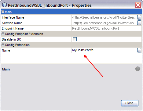

Open the Composite Application Service Assembly in the CASA Editor.
Right-click the endpoint to which you want to add the application configuration, and then click Properties.
In the Name property under Config Extension, enter the name of the application configuration.
Click Close, and then click Save All on the NetBeans toolbar.
Once the application configuration values are defined and added to the endpoint, deploy the application.

Application variables allow you to define a list of variable names and values along with their type. The application variable name can then be used as a token for a WSDL extensibility element attribute for the REST BC. For example, you could define a string variable named ServerName with a value of MyHost.com. To reference this in the WSDL document, you would enter ${ServerName}. When you deploy an application that uses application variables, any variable that is referenced in the application's WSDL document is loaded automatically.
If you start an application and a value is not defined for an application variable, an exception is thrown.
You can define the following four variable types:
String – A string value, such as a path or directory.
Number – A numeric value.
Boolean – A Boolean true or false. When you define a Boolean variable, a check box appears in the value field. Select the check box if the variable value should be true; otherwise, deselect the check box.
Password – A login password. The password is masked and appears as asterisks.
Variables allow greater flexibility in WSDL documents. For example, you can use the same WSDL document for multiple runtime environments by using application variables to specify system-specific information. The variable values can be changed from the binding component runtime properties for each specific environment.
To change a property when the application is running, change your Application Variable property value, then right-click your application in the Services window under Servers -> GlassFish -> JBI -> Service Assemblies, and click Stop in the popup menu. When you restart your project, your new settings will take effect.
Click the ellipsis next to Application Variables.
The Application Variables Editor appears.
Click Add.
A list of possible variable types appears.
Select String, Number, Boolean, or Password, and then click OK.
A new row appears in the application list.
In the new row, enter a variable name and then do one of the following:
For a Boolean variable, select the check box if the variable value should be true; otherwise leave it deselected.
For all other variables types, enter the variable value.
If you created a password variable, the value you enter appears as asterisks.
The variable can now be reference from WSDL documents using a dollar sign and curly brackets to indicate the variable; for example, ${MyVariable}.
