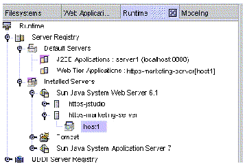

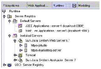

(Solaris only) If you created a non-root instance of Web Server during installation, your Server Registry looks something like this:
IDE Runtime window's Server Registry showing web server instances under Sun Java System Web Server 6.1 node.
3. Expand your Sun Java System Web Server instance node to see the virtual server.
4. Right-click the Virtual Server instance and choose Set As Default from the contextual menu.
5. Expand the Default Servers node to verify that the Web Tier Applications node shows the new server instance as the default.
Runtime window's Server Registry showing expanded Default Server node with new instance as the Web Tier Application default.
