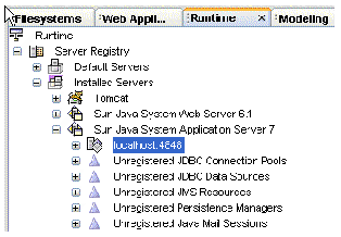

4. (Optional) Expand the Installed Servers node and expand the Sun Java System Application Server 7 node.
In this screen shot, the node localhost:4848 is your Admin Server instance.

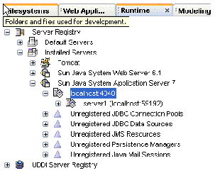

5. (Optional) Expand the localhost:4848 node to see the application server instance server1.
