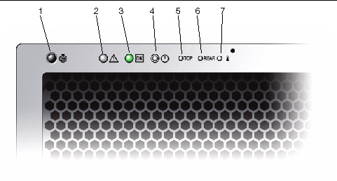

1. Verify that power cords have been connected and that standby power is on.
In standby power mode, the Power/OK LED (3) on the front panel flashes.
FIGURE 2-1 Front Panel Controls and Indicators
2. Use a nonconducting stylus to press and release the recessed Power button on the server front panel. See FIGURE 2-1.
When main power is applied to the full server, the Power/OK LED next to the Power button lights and remains lit.

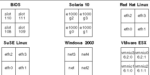

These servers each have four 10/100/1000BASE-T Gigabit Ethernet ports connected to individual Network Interface Cards (NICs). The chassis labeling of the physical ports is shown in FIGURE 1.
FIGURE 1 Ethernet Port Chassis Labeling Designations
The logical device naming for the NICs is reported differently by different interfaces and operating systems.
See FIGURE 2 for a diagram that explains how operating systems and interfaces name the four NICs shown in FIGURE 1.
FIGURE 2 Sun Fire X4500 NIC Naming Conventions

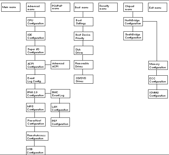

TABLE 2-1 contains summary descriptions of the seven top-level BIOS setup screens.
FIGURE 2-2 summarizes the BIOS menu tree. See Section 2.12, BIOS Setup Menu Screens (X4500) for examples of each of these screens.
See Section t, To Install a PCI-X or PCIe Card (FRU) for the locations of the PCI slots.
FIGURE 2-2 BIOS Utility Menu Tree (X4500)

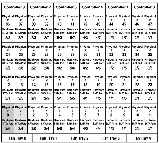

TABLE 2-2 shows the devices and PCI slots, and the order that the BIOS detects them. See To Install a PCI-X or PCIe Card (FRU) for the locations of the PCI slots.

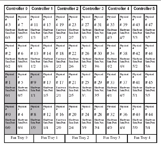

The following graphic shows the drives mapping scheme of the system. The boot drives are 0 or 1. (Default boot drive is in slot 0 and the default mirrored drive is in slot 8.) It is required to use one of these drives from which to boot the system.
FIGURE 2-3 Sun Fire X4500 Drives Map

TABLE 2-3 contains summary descriptions of the seven top-level BIOS setup screens for the Sun Fire X4540.
FIGURE 2-4 summarizes the BIOS menu tree. See Section 2.16, BIOS Setup Menu Screens (X4540) for examples of each of these screens.
FIGURE 2-4 BIOS Utility Menu Tree for Sun Fire X4540
BIOS Setup Utility screens, summarized as a menu tree with the 7 top-level screens listed horizontally and their sub-screens listed vertically.
TABLE 2-4 shows the devices of the X4540 server in order of boot detection.
There are six on-board LSI controllers with each controller connecting to eight drives.
BIOS shows the drives in F2 Setup as follows (this information is obtained from the LSI BIOS option ROM):
SCSI: #0200 ID00 SCSI: #0300 ID01
This means the SCSI controller is on bus 02h, device 0, function 0, drive ID 0, or the SCSI controller is on bus 03h, device 0, function 0, drive ID 1.
The following graphic shows the drives mapping scheme of the system. The boot disks are 0, 1, 8, and 9. (Default boot drive is in slot 0 and the default mirrored drive is in slot 8.) It is required to use one of these disks from which to boot the system.
FIGURE 2-5 Sun Fire X4540 Drives Map

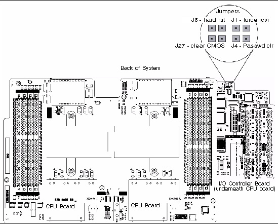

This procedure describes how to reset the Administration password (the root password) for the ILOM Service Processor to the default after it has been set during initial setup.
1. Shut down the server to standby power mode by using a ballpoint pen or other nonconducting stylus to press and release the recessed Power button on the front panel.
See Section 2.2, Powering Off the Server.
2. Disconnect the AC power cords from the server.
3. Remove the cable management assembly if necessary:
4. Remove the system controller as described in To Remove the System Controller (CRU).
FIGURE 2-6 Loosening Captive Screws and Removing the Cover
5. Push the system controller cover toward the rear and lift the cover off.
6. See the CPU board and the I/O controller board.

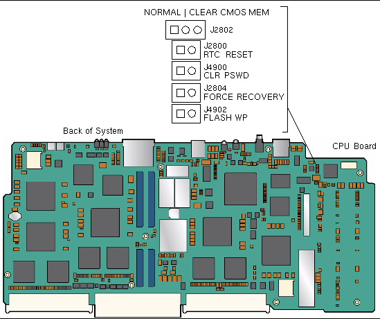

The jumper is located on the I/O controller board, as shown in FIGURE 2-7 (X4500) or in FIGURE 2-8 (X4540).
FIGURE 2-7 Location of Jumpers on the I/O Controller (X4500)
FIGURE 2-8 Location of Jumpers on the I/O Controller (X4540)
| Note - The hard rst jumper changes the reset button from a soft reset to a hard reset. It is used for hardware debugging only. |
7. Install the jumper across the header pins:
The jumper’s function is to clear the ILOM SP password.

14. Repeat Step 1 through Step 9 to remove the jumper. (Remove the jumper in Step n instead of inserting it.)
| Note - If you do not remove the passwd clr jumper, the ILOM SP and BIOS passwords will reset every time you power-cycle the server. |

You can use this jumper to clear the server’s CMOS settings in the case of a system hang. For example, if the server hangs because of incorrect settings and does not boot, use this jumper to invalidate the settings and reboot with defaults.
| Note - Clearing CMOS settings resets the BIOS settings, including the BIOS password. |

See the CPU board and the I/O controller board, as shown in FIGURE 2-7 (X4500) or in FIGURE 2-8 (X4540).
6. Install the jumper across the header pins labelled Clear CMOS.
The jumper’s function is to tell the system to clear the current CMOS settings at system reboot.
7. Wait 10 seconds, then remove the jumper.
This jumper removes battery power from the chipset where the CMOS settings are stored, thereby removing the CMOS settings.

Currently, the devices and PCI slots are detected by the BIOS during startup in the following order:
1. On-board SATA controllers 0 through 3
3. On-board SATA controllers 4 and 5
To work around the problem for booting devices without exhausting all the option ROM memory:
