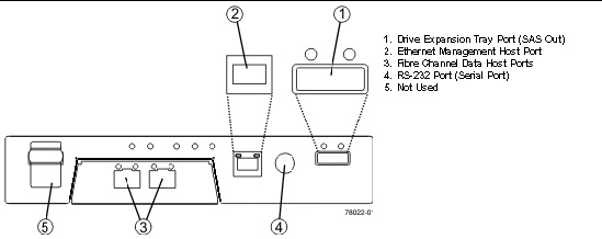

This Fibre Channel (FC) controller tray provides the following capabilities:
When fiber-optic cables are used to connect to the data host, a Small Form-factor Pluggable (SFP) transceiver is required to make the connection.
FIGURE 1-6 Sun StorageTek 2540 Array Ports
You can connect the Sun StorageTek 2540 Array to either copper host interface cables or fiber optic host interface cables. If you use fiber-optic cables, you must install an SFP transceiver in each interface port on the controller where a fiber-optic cable is to be installed. The SFP transceiver is required to translate the optical signals from the fiber-optic cable into digital signals for the controller.
| Note - The SFP transceiver shown might look different from those that are shipped with your controller tray. The difference does not affect transceiver performance. |
FIGURE 1-7 SFP Transceiver for the Sun StorageTek 2540 Array

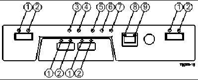

FIGURE 1-11 Locations of the Controller LEDs on the Sun StorageTek 2540 and 2510 Arrays
1 |
At least one link has an error, or an incompatible connection has been made.[1] |
2 |
3 |
4 |
Indicates that all data has been written to the disk and the cache is empty. |
5 |
6 |
7 |
8 |
9 |
10 and 11 |
Both LEDs on indicate a 4-Gb/s data rate from the management software host. Left LED on and right LED off indicate a 1-Gb/s data rate from the management software host. Right LED on and left LED off indicate a 2-Gb/s data rate from the management software host. |
Both LEDs off indicate no link to the management software host. |
10 |
11 |

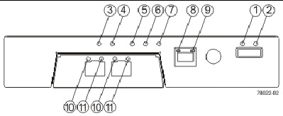

FIGURE 1-12 Locations of the Controller LEDs on the Sun StorageTek 2530 Array
1 |
At least one link has an error, or an incompatible connection has been made.[2] |
2 |
3 |
4 |
5 |
6 |
7 |
8 |
9 |

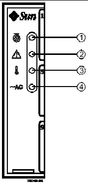

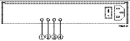

The power-fan assembly LEDs for the Sun StorageTek 2540 Array, the Sun StorageTek 2530 Array, the Sun StorageTek 2510 Array, and the Sun StorageTek 2501 drive expansion tray are identical.
FIGURE 1-13 Locations of the Power-Fan Assembly LEDs
1 |
2 |
3 |
4 |
