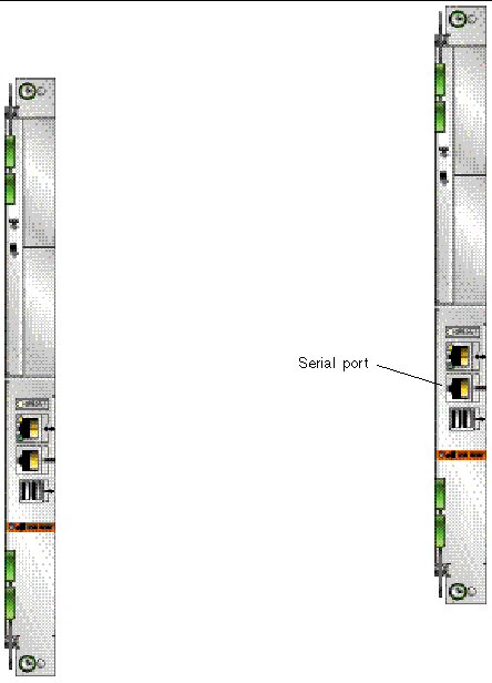

Front panel ports are typically used for maintenance and troubleshooting purposes in installed and running systems. External I/O cables are connected to the Sun Netra CP3220 blade server or to the Sun Netra CP32x0 ARTM.
To connect each of these following cables:
| Note - Although the front panel Ethernet port does not support gigabit Ethernet, it can be connected to a gigabit switch capable of 10/100/1000 MBASE-T Ethernet. |
| Note - The front and rear serial ports use the same physical wire, so only one serial port, either the front or the rear, can be used at a time. |
1. Connect a shielded serial cable to the serial console port on the front panel of the Sun Netra CP3220 blade server (FIGURE 2-3) or the Sun Netra CP32x0 ARTM.
2. Connect the other end of the serial cable to the serial port of the system serving as the serial console.
FIGURE 2-3 Serial Port on the Sun Netra CP3220 Blade Server
3. Use one of the following to establish a full-duplex serial terminal connection with the Sun Netra CP3220 blade server:
For example, if you are using a UNIX system as the system console, at the UNIX prompt in a command tool or shell tool, or serial port A, type:
2. Connect the other end of the serial cable to the serial port of the system serving as the system console.
3. Set the serial communications settings to 9600 baud, 8 bit, 1 stop bit, no parity, and no handshake.

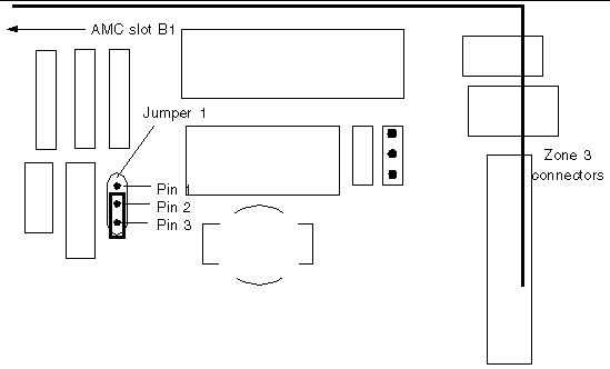

Reset jumper 1 to clear the CMOS settings, which restores the default BIOS settings.
Jumper 1 is shown in FIGURE 2-10. The jumper housing should be stored in the P1/P2 position, which is the run position.
FIGURE 2-10 Jumper 1 in the Run Position
TABLE 2-4 provides information on the pin functions on jumper 1.
BATT_CLR (resistor to GND, used to drain capacitive charge and clear the CMOS memory) |
To reset the jumper and return the CMOS settings to the default settings, perform the following steps:

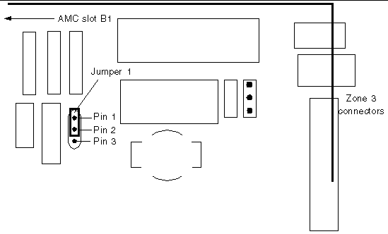

1. Remove the jumper housing from the run position (P1/P2) and move it to the reset position (P2/P3).
FIGURE 2-11 Jumper 1 in the Reset Position
2. Wait at least one second for the CMOS settings to reset and then move the jumper housing back to the run position.
3. Reinstall the blade server.
Use the procedure in Section 2.2.3.2, Installing the Blade Server Into the Shelf.
| Note - The blade server will operate normally only when the jumper housing is in the run position. |

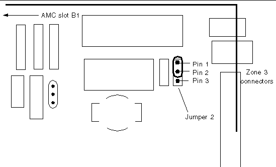

The color of the Out-of-service (OOS) LED can be set to red or amber by moving jumper 2 to the appropriate position. Amber is the default color for the OOS LED.
To change the Jumper 2 position to red:
1. Remove the jumper housing from the default (amber) position (P2/P3) and move it to the red position (P1/P2).
FIGURE 2-12 Jumper 2 in the Red Position
2. Reinstall the blade server.

1. Use a spudger tool or other stylus to press and release the recessed Reset button on the front of the Sun Netra CP3220 blade server (FIGURE 2-13).
2. Confirm the progress of the reset by monitoring the BIOS POST messages.
FIGURE 2-13 Sun Netra CP3220 Blade Server Front Panel
