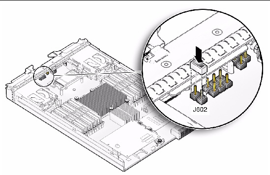

2. Locate the J602 pins on the server module then place a jumper on pins 2 and 3. See FIGURE 4-1.
FIGURE 4-1 Placing Jumper on Pins
