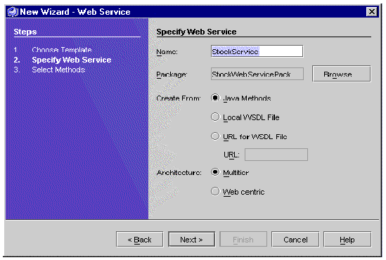

The New Web Service wizard is illustrated in FIGURE 2-1.
 FIGURE 2-1 New Web Service Wizard
Screenshot showing new web service wizard. Buttons are Browse, Back, Next, Finish, Cancel, and Help.
Note - The wizard has radio buttons that enable you to choose the web service architecture: Multitier (the default) or Web centric. The distinction between these architectures is explained in Sun ONE Studio 4 Java Web Services. If your application uses only EJB business components, both architectures work. Multitier is preferred because it puts the generated support structure in the same EJB container as the business components.
2. Ensure that the Create From Java Methods radio button is selected.
The alternatives, Create From Local WSDL File and Create From URL for WSDL File, are explained in Creating a JAX-RPC Web Service from WSDL.
3. Ensure that the Package field specifies the correct location in which to create the web service.
If a Java package is currently selected in the Explorer when you open the New Web Service wizard, the name of the package appears in the Package field of the wizard. You can click Browse in the wizard to find and select a package of your choice.
4. In the Name field, type a name for the web service.
If you enter the name of a web service that already exists in the package designated in the wizard, the IDE displays a highlighted message: A web service with this name already exists in package.
5. Click Finish to create the web service, or click Next to add method references.
If you click Finish, your new web service is displayed in the Explorer. It appears under the designated package as a node with a blue sphere icon (Web service icon).
If you click Next, the IDE displays a Methods browser. Select one or more methods and click Finish in the browser to add method references to your web service. Then click Finish to create the web service.

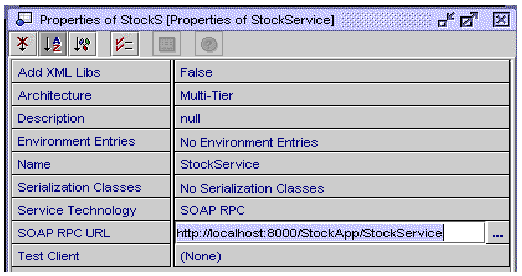

6. In the Explorer, right-click the web service and choose Properties.
The SOAP RPC URL property has the following default form:
http://hostname:portnum/webserviceName/webserviceName
Set the values of hostname and portnum to match your server installation. The first instance of webserviceName in the URL is called the context root or web context. You can change it to any value of your choice, but it must match the web context property of the J2EE application WAR node that you create in a later step (see Assembling the J2EE Application).
Note - If you have more than one web service, make sure that each of the SOAP RPC URLs is unique.
FIGURE 2-2 shows the properties of a web service in which the context root of SOAP RPC URL has been changed from the default value to StockApp.
 FIGURE 2-2 Web Service Properties With Context Root Set to StockApp
Screenshot showing web service properties with SOAP RPC URL property highlighted.

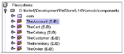

Be sure to select EJB methods from the logical EJB node (the node with the bean icon Bean icon), not the nodes that represent the EJB bean class or the home or remote interfaces. By adding a method from the logical EJB node, you provide the runtime information needed to call the method. FIGURE 2-3 shows examples of logical EJB nodes.
 FIGURE 2-3 Logical EJB Nodes in the Explorer
Screenshot of Explorer display showing several logical EJB nodes.

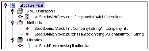

References added to a web service are displayed in subnodes of the web service, as illustrated in FIGURE 2-4.
References are organized as follows:
 FIGURE 2-4 Web Service References
Screenshot of Explorer expansion of web service node, showing XML operations, methods, and libraries.
The IDE prefixes references with the names of the packages containing the referenced objects. The IDE prepends the arrow symbol (->) to XML operation references and JAR references.

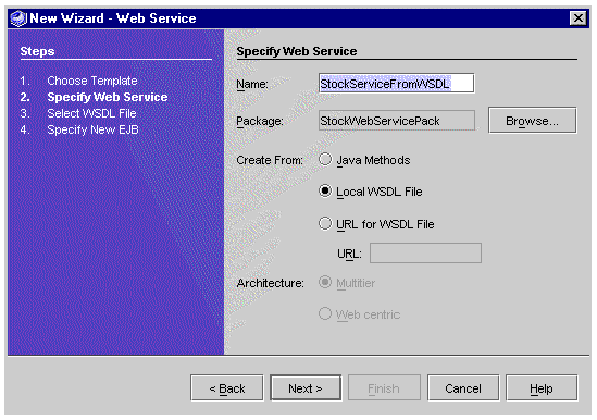

To create a new web service from WSDL:
1. Open the New Web Service wizard.
In the Explorer, right-click the Java package in which you want to create the web service, and choose New right arrow Web Services right arrow Web Service.
You can also navigate to the same wizard by choosing File right arrow New Template right arrow Web Services right arrow Web Service from the IDE's main window.
The New Web Service wizard is illustrated in FIGURE 2-5.
Note - Alternatively, you can right-click the desired WSDL node in the Explorer, and choose Create New Web Service. In this case the procedure is simplified. The IDE opens a window in which you can enter a target directory and package. The generated EJB session bean is put in the same package as the web service.
 FIGURE 2-5 New Web Service Wizard

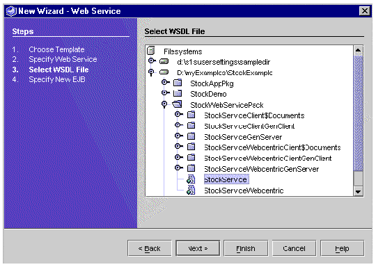

2. Check the radio button for Create From Local WSDL File, click Next, and select the desired WSDL file from the browser, as illustrated in FIGURE 2-6.
Alternatively, check the radio button for Create From URL for WSDL File, enter a URL, and click Next.
 FIGURE 2-6 New Web Service Wizard: Select WSDL File
Screenshot showing new web service wizard, Select WSDL File. Buttons are Back, Next, Finish, Cancel, and Help.

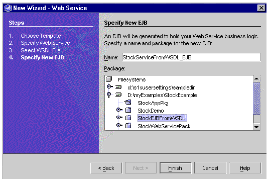

The IDE displays the Specify New EJB window, as illustrated in FIGURE 2-7.
 FIGURE 2-7 New Web Service Wizard: Specify New EJB
Screenshot showing new web service wizard, Specify New EJB. Buttons are Back, Finish, Cancel, and Help.

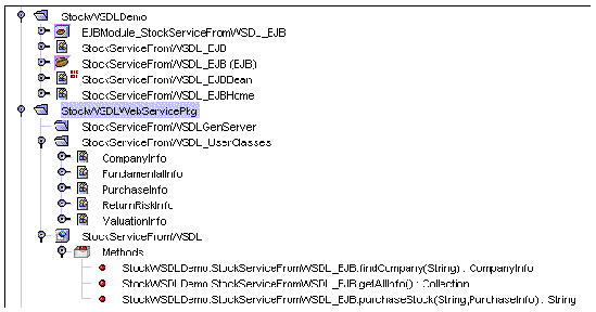

3. Specify the desired EJB name, select the target package, and click Finish.
The IDE creates the new web service and the new EJB, placing each in the package that you designated in the wizard, as illustrated in FIGURE 2-8.
The new web service and EJB session bean have the methods designated in the WSDL. The web service references those methods in the generated session bean.
Note - The WSDL does not contain the web service business logic. Therefore, the generated EJB session bean is not complete. You have to code the business methods and then compile or validate the EJB classes.
 FIGURE 2-8 Web Service and EJB Nodes Generated from WSDL: Explorer View
Screenshot showing Explorer display of web service and EJB node generated from WSDL.

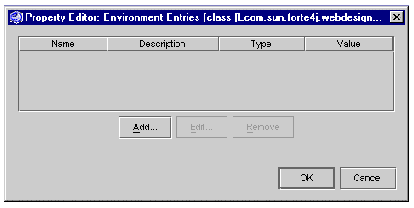

Adding Environment Entries
Environment entries are data that you store in your web service's EJB module deployment descriptor. Environment entries are available to your web service for use as parameters to the methods that create or find target objects.
If a method specified in the Method, Constructor, or Static Method fields of the Resolve Objects dialog box takes a parameter, you can map that parameter's value to an environment entry. Because environment entries are stored in the deployment descriptor, they can be configured at deployment time to values appropriate for the runtime environment.
To add an environment entry:
1. Right-click your web service node and choose Properties.
The IDE displays the web service properties, as illustrated in FIGURE 2-2.
2. Click the Environment Entries property value, then click the ellipsis (...) button.
The Environment Entries dialog box is displayed, as illustrated in FIGURE 2-9.
 FIGURE 2-9 Environment Entries Dialog Box
Screenshot showing Environment Entries property editor. Buttons are Add, Edit, Remove, OK, and Cancel.

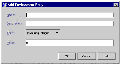

3. Click Add.
The Add Environment Entry dialog box is displayed, as illustrated in FIGURE 2-10.
 FIGURE 2-10 Add Environment Entry Dialog Box
Screenshot showing Add Environment Entry dialog box. Buttons are OK, Cancel, and Help.
4. Fill out the fields in the Add Environment Entry dialog box.
5. Click OK.
The environment entry is created. The next time you generate runtime classes for your web service, the environment entry will be propagated to the web service's EJB module deployment descriptor.

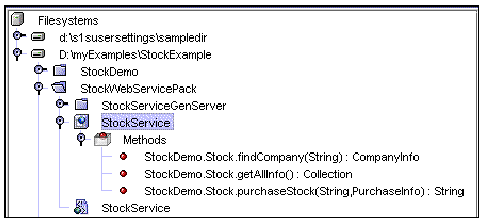

Your web service's runtime classes are generated and compiled. The resulting Explorer display is illustrated in FIGURE 2-11.
 FIGURE 2-11 Web Service Hierarchy of Nodes
Web service Explorer display after Generate, showing Methods node and GenServer node.
A WSDL node appears in the Explorer hierarchy, at the same level as the web service node and in the same package. The WSDL node has the same name as your web service, but it is distinguished by a different icon, with a green sphere (WSDL icon).

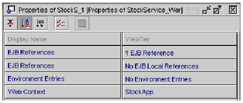

5. Edit the Web Context property of the web service WAR node, if necessary.
A default web context property is assigned to the web service WAR node. The value of this property is part of the URL used to access your web service. The value must match the context root value in the SOAP RPC URL property of your web service (see FIGURE 2-2).
To edit the default setting:
a. Right click the web service WAR node and choose Properties.
b. Click the Web Context property, type a new value, and press Enter.
FIGURE 2-13 shows the properties of a web service WAR file in which the Web Context value has been changed to StockApp, to match the context root value in the SOAP RPC URL property of the web service.
 FIGURE 2-13 Web Service WAR File Properties With Web Context Set to StockApp
Screenshot of Web service WAR properties showing the Web Context property.

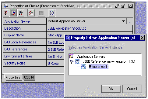

6. Edit the Application Server property of the J2EE application, if necessary.
This property should specify the desired application server instance for deployment. The property defaults to the default application server of the IDE, which you can set in the Explorer window's Runtime tab.
To edit the property, right-click the J2EE application node and choose Properties. Click the Application Server property value, and click the ellipsis (...). The IDE displays a dialog box in which you can select any available application server instance, as illustrated in FIGURE 2-14.
 FIGURE 2-14 Application Server Instance for Deployment
Screenshot showing J2EE application properties with Default Application Server selected and Property Editor displayed.

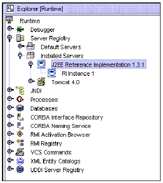

Configuring the RI Server
Note - If you are using the RI server that comes installed with the Sun ONE Studio 4, Enterprise Edition for Java IDE, skip Steps 1-5 of the following procedure.
To configure an external RI application server:
1. Click the Runtime tab in the Explorer window.
2. Expand the Server Registry node, and then expand the Installed Servers node.
3. Add a J2EE Reference Implementation server instance by right-clicking the J2EE Reference Implementation node and choosing Add Server Instance.
The Explorer window's Runtime tab is illustrated in FIGURE 2-15.
 FIGURE 2-15 Creating an Application Server Instance
Screenshot of Explorer runtime tab showing Server Registry node, Installed Servers subnode, and J2EE RI node with an RI instance.

If your web service has a web-centric architecture and does not use any EJB business methods, there is no J2EE application. In this case, you can:
1. Generate a client and make that client the default test client for your web service.
2. Make sure the SOAP RPC URL property of the web service refers to the port of the internal Tomcat web server installation (8081).
To view or change the SOAP RPC URL property, right-click the web service node in the Explorer and choose Properties.
3. Right-click the web service node and choose Execute.
The IDE assembles a WAR file, deploys it to the default Tomcat web server, and runs the web service. To view the WAR properties, right-click the WAR node in the Explorer and choose Properties.
Note - If you are using the Sun ONE Application Server 7 server, Execute does not automatically deploy the WAR file. You must right-click the web service node and choose Deploy and then Execute.

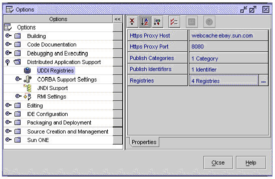

Managing UDDI Registry Options
The IDE keeps a list of known UDDI registries and information (such as URLs, userid, and password) needed to access each registry. The IDE also keeps default information (such as business, categories, and identifiers) that is used when you create a web service client or publish a web service to a registry.
Note - It is recommended that you set default values for registry information before you use the IDE wizards to access UDDI registries. By setting defaults, you avoid repetitive typing of values in the wizards.
To manage UDDI registry options, choose Tools right arrow Options right arrow Distributed Application Support right arrow UDDI Registries from the IDE's main window. The Options dialog box is displayed, as illustrated in FIGURE 2-16.
 FIGURE 2-16 UDDI Registries Options Dialog Box
Screenshot showing UDDI Registries options, with buttons to set defaults and open the registries list. Other buttons are Close and Help.

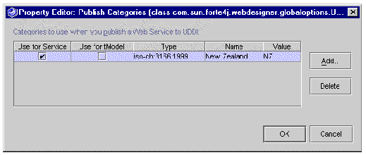

To set default publish categories, click the Publish Categories value in the UDDI registries Options dialog box (see FIGURE 2-16) and click the ellipsis (...) button that appears. The Publish Categories dialog box appears, as illustrated in FIGURE 2-17.
 FIGURE 2-17 UDDI Publish Categories Dialog Box
Screenshot of Property Editor displaying default publish categories. Buttons are Add, Delete, OK, and Cancel.
Click the Use for Service checkbox or the Use for tModel checkbox to set a category as a default for services or tModels when you publish them to a registry.
Click Delete to delete a category.

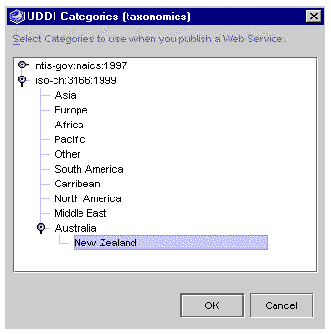

Click Add to add a category. The UDDI Categories (taxonomies) dialog box appears, as illustrated in FIGURE 2-18. The categories are industry standards.
Note - When you publish a web service to a UDDI registry, the IDE automatically adds a hidden category to be associated with the tModel. The name of the category is uddi-org:types and the value is wsdlSpec. This category indicates that the tModel has a WSDL description of a web service. It only applies to tModels, and is not used to categorize web services. This category is not displayed in the IDE, but it can be found in searches by registry tools.
 FIGURE 2-18 UDDI Categories (Taxonomies)
Screenshot showing browser used to select one or more categories. Buttons are OK and Cancel.
Expand the nodes, select the desired category, and click OK. The category appears in the Publish Categories dialog box. To select more than one item, hold down the Control key while clicking. To select a range of items, hold down the Shift key while clicking.

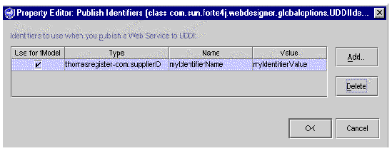

To set default publish identifiers, click the Publish Identifiers value in the UDDI registries Options dialog box (see FIGURE 2-16) and click the ellipsis (...) button that appears. The Publish Identifiers dialog box appears, as illustrated in FIGURE 2-19.
 FIGURE 2-19 UDDI Publish Identifiers Dialog Box
Screenshot of Property Editor displaying default publish identifiers. Buttons are Add, Delete, OK, and Cancel.
You can delete an identifier, add an identifier, or set an identifier as a default for tModels.
To delete an identifier, select the identifier and click Delete.

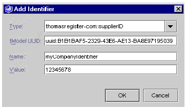

To add an identifier, click Add. The UDDI Add Identifier dialog box appears, as illustrated in FIGURE 2-20. The identifier types and tModel UUIDs are industry standards.
 FIGURE 2-20 UDDI Add Identifier Dialog Box
Screenshot showing Add Identifier dialog box. Buttons are OK and Cancel.
Select Type. The IDE displays the tModel UUID for the selected type. You can specify your own user-defined type if you know and enter the tModel UUID (the registry key) of your user-defined type.
Specify Name and Value, and click OK. The IDE returns you to the Publish Identifiers dialog box.
Click OK. The IDE returns you to the UDDI Set Categories and Identifiers dialog box.

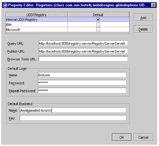

To edit information about registries known to the IDE, click the ellipsis (...) button of the Registries property in the UDDI registries Options dialog box (see FIGURE 2-16). The Property Editor dialog box is displayed, as illustrated in FIGURE 2-21.
The property editor displays known registries and detail information for the selected registry. The top portion of the screen is a table of known registries. Click a registry name to display its detail information in the bottom portion of the screen.
You can edit registry information as follows:
 FIGURE 2-21 UDDI Registries Property Editor
Screenshot showing Registries Property Editor. Buttons are Add, Delete, OK, and Cancel.

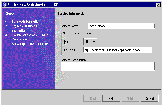

1. Right-click your web service node in the Explorer and select Publish to UDDI.
The Publish New Web Service to UDDI dialog box is displayed, as illustrated in FIGURE 2-22.
In this dialog box, you can:
 FIGURE 2-22 UDDI Publish New Web Service Dialog Box
Screenshot of Publish New Web Service to UDDI dialog box. Buttons are Back, Next, Finish, and Cancel.
Note - The host name in Address URL defaults to localhost. Change this to the network machine name of the host.

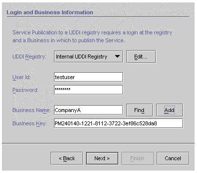

2. Click Next to display the UDDI Login and Business Information dialog box, as illustrated in FIGURE 2-23.
If you previously set default values for userid, password, and business for the selected UDDI registry, the default values are displayed. You can override a default value by typing or pasting a different value in each field.
To specify a business, type a value for Business Name. The Find and Add buttons become active.
Click Edit to edit information for the selected UDDI registry. The IDE displays the UDDI Registries Property Editor. This enables you to change registry default values during the publication process. See Editing Registries Information in the IDE.
 FIGURE 2-23 UDDI Login and Business Information Dialog Box
Screenshot of Login and Business Information dialog box. Buttons are Edit, Find, Add, Back, Next, Finish, and Cancel.[ D ]

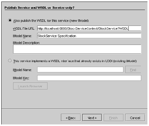

3. Click Next to display the UDDI tModel selection dialog box, as illustrated in FIGURE 2-24.
In this step you specify what you want to publish and provide details. You can create a new tModel in the registry or find an existing tModel, and associate the new or existing tModel with your web service.
If you create a new tModel, the IDE attempts to derive the WSDL File URL from the Address URL of your deployed web service (see FIGURE 2-22), based on IDE naming conventions. If you changed the Address URL, or if you deployed your web service outside the IDE, the IDE leaves the WSDL File URL value blank.
You can change the URL by typing a different value.
You can specify text for the tModel Description.
 FIGURE 2-24 UDDI tModel Selection Dialog Box
Screenshot of UDDI tModel selection dialog box. Buttons are Find, Launch Browser, Back, Next, Finish, and Cancel.[ D ]
If you use an existing tModel in the UDDI, type the tModel Name and click Find.The IDE will display the tModel Key. If more than one tModel in the registry matches the value of tModel Name, the IDE displays the first tModel Key value returned by the registry server. If you already have the key value, type or paste it into the tModel Key field.
Note - If you are publishing your web service to a UDDI registry that provides browser tools, you can use those tools to search for the tModel key. Click Launch Browser. The IDE opens your default web browser at the web page specified by the Browser Tools URL of the UDDI registry (see FIGURE 2-21).

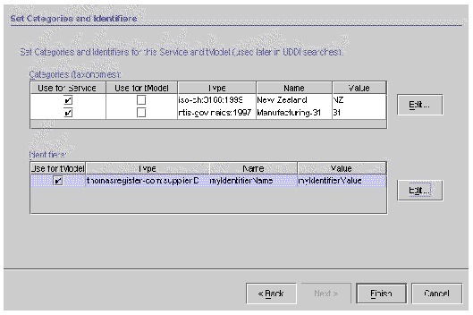

The IDE displays the UDDI Set Categories and Identifiers dialog box, as illustrated in FIGURE 2-25.
The dialog box shows your default categories and identifiers. Click Edit to add or delete categories or identifiers, as described in Setting Default Publish Categories and Identifiers.
 FIGURE 2-25 UDDI Set Categories and Identifiers
Screenshot of Set Categories and Identifiers dialog for your service. Buttons are Edit (category), Edit (identifier), Back, Next, Finish, and Cancel.[ D ]
5. Click Finish.

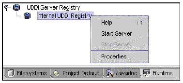

Starting and Stopping the Internal UDDI Registry Server
To start the internal UDDI registry server:
1. Expand the UDDI Server Registry node in the Explorer Runtime tabbed pane.
You should see the Internal UDDI Registry node.
2. Right-click the Internal UDDI Registry node and choose Start Server, as shown in FIGURE 2-26.
The IDE output window displays server startup messages. You might also see messages stating that the IDE is stopping a previous Tomcat server process.
Note - If the internal UDDI registry server is already running, the Start Server menu item is inactive.
 FIGURE 2-26 Start Internal UDDI Registry Server
Screenshot of Explorer Runtime tab, with UDDI Server Registry node, internal registry node, and Start Server menu item.

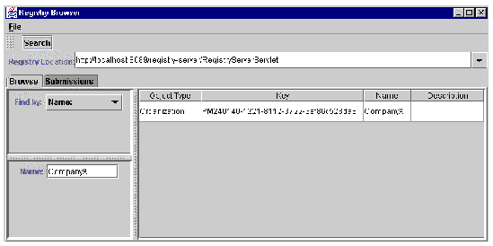

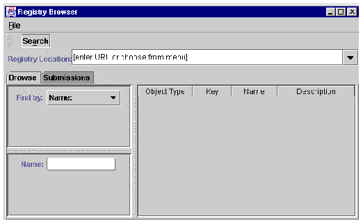

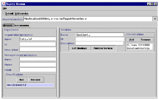

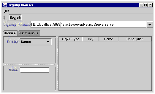

Using the Sample Registry Browser
The Java WSDP provides a sample registry browser, which has additional features beyond those included in the Sun ONE Studio 4, Enterprise Edition for Java IDE.
The sample registry browser enables you to delete a service from the internal registry, to add business information beyond name and key, and other actions not provided in the IDE wizards. However, as its name suggests, the sample registry browser is not a complete, full-function tool. For example, it does not enable you to view or delete tModels.
Java WSDP software and sample programs are in the jwsdp directory under your IDE home directory. Sample program source is in the wsdp/samples directory.

Before starting the sample registry browser, use the IDE to start the internal UDDI registry, as explained in Starting and Stopping the Internal UDDI Registry Server.
To start the sample registry browser:
1. Open a command window and change your current directory to s1studio_HOME/jwsdp/bin.
2. Type the following command:
The sample registry browser is displayed, as illustrated in FIGURE 2-27.
 FIGURE 2-27 JWSDP Sample Registry Browser
Screenshot of sample registry browser, showing Browse and Submissions tabbed panes, a detail pane, and Search button.

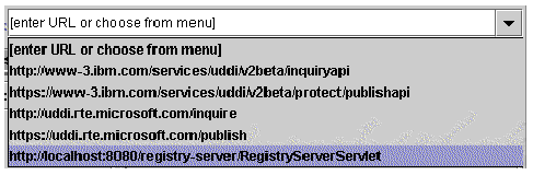

To configure the sample registry browser for your internal registry:
1. Select the last URL in the Registry Location list, as illustrated in FIGURE 2-28.
 FIGURE 2-28 JWSDP Sample Registry Browser URL Selection
Screenshot showing sample registry browser selection list of registry URLs.
2. Change the port number in the URL from 8080 to the correct port number for the internal registry Tomcat web server, as illustrated in FIGURE 2-29.
The IDE is configured with 8089 as the default port number for this server.
 FIGURE 2-29 JWSDP Sample Registry Browser With Internal Registry URL
Screenshot of sample registry browser showing edited internal registry URL.
The sample registry browser main window has, on the left side, a tabbed pane with Browse and Submission tabs. The main window has, on the right side, a pane that displays detail information about the object that is selected in the tabbed pane. The upper left area of the main window has buttons for Search, Submit, and other context-sensitive actions.
An example showing the result of a search by company name is illustrated in FIGURE 2-30.
 FIGURE 2-30 JWSDP Sample Registry Browser Displaying Selected Business
Screenshot of sample registry browser displaying a selected business in the detail information pane.
An example using the Submissions tabbed pane is illustrated in FIGURE 2-31.
 FIGURE 2-31 JWSDP Sample Registry Browser Displaying Submissions Tabbed Pane
Screenshot showing sample registry browser Submissions tab.

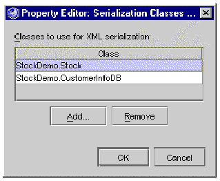

To add a serialization class:
1. Right-click the web service node, choose Properties, click the value of the Serialization Classes property, then click the ellipsis (...) button.
The IDE displays any existing serialization classes and provides Add and Remove buttons, as illustrated in FIGURE 2-32.
2. Click Add.
The IDE opens a browser in which you can select one or more classes from any mounted packages. The selected classes should be JavaBean components.
3. Select the desired classes, using ctrl-click to select more than one, then click OK.
The IDE displays the serialization classes.
 FIGURE 2-32 Serialization Classes Property Editor
Screenshot of serialization classes property editor, showing list of classes, Add, Remove, OK, and Cancel buttons.
