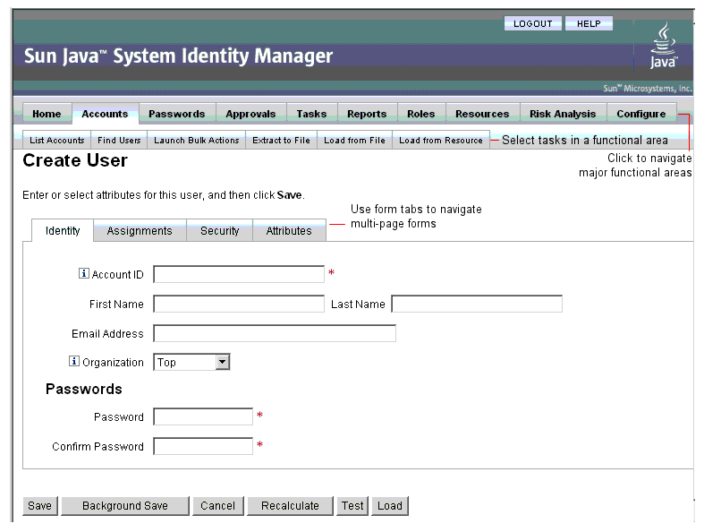

Identity Manager Administrator Interface
The Identity Manager Administrator Interface serves as the primary administrative view of the product. Through this interface, Identity Manager administrators manage users, set up and assign resources, and define rights and access levels in the Identity Manager system.
Interface organization is represented by:
- Navigation bar tabs — Located at the top of each interface page, these tabs let you navigate major functional areas.
- Subtabs or menus — Depending on your specific implementation, you may see secondary tabs or menus below each navigation bar tab. These subtab or menu selections let you access tasks within a functional area.
In some areas, such as Accounts, tabbed forms divide longer forms into one or more pages, enabling you to navigate them more easily.
Figure 1. Identity Manager Administrator Interface

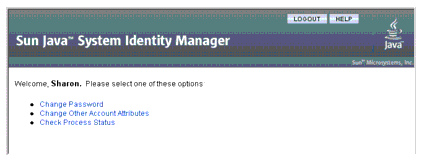

Identity Manager User Interface
The Identity Manager User Interface presents a limited view of the Identity Manager system. This view is specifically tailored to users without administrative capabilities.
From the User Interface, users can:
This interface is often customized to present a unique, company-specific view and offer custom selections.
Tip For detailed information about customizing and branding the User Interface, read Identity Manager Technical Deployment Overview.
Figure 2. Identity Manager User Interface

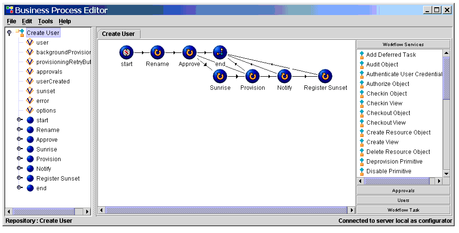

Identity Manager Business Process Editor
The Business Process Editor (BPE), also referred to as the Configuration Editor, provides a graphical view of Identity Manager forms, rules, and workflows. Using the BPE, you create and edit forms that establish the features available on each Identity Manager page. You also modify Identity Manager workflows, which define the sequence of actions followed or tasks performed when working with Identity Manager user accounts.
Figure 3. Business Process Editor (Configuration Editor)
For more information about the BPE and using it to work with Identity Manager workflows, see Identity Manager Workflows, Forms, and Views.

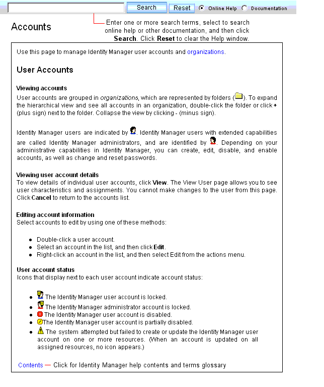

Finding Information
Use the search feature in the Help window to locate topics and information included in Identity Manager Help and documentation. To search:

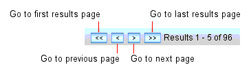

The search returns linked search results. Use the Previous/Next or First/Last buttons to page through the listed results.
Figure 5. Search Results Navigation
Clicking Reset clears the contents of the Help window.
Search Behavior
If you search for more than one word, the search feature returns results that include each word, both words, and variants.
For example, if you enter to search for:
resource adapter
then the returned results will include matches to the words:
However, if you include search terms in quotations (for example, “resource adapter”), then the search feature returns only exact matches to that phrase.
Alternatively, you can use advanced query syntax to specifically include, exclude, or order query elements.
Advanced Query Syntax
The Search feature supports advanced query syntax, including:
See Advanced Search for Online Documentation in this guide for more information about Identity Manager’s advanced documentation search features.
Figure 6. Identity Manager Help

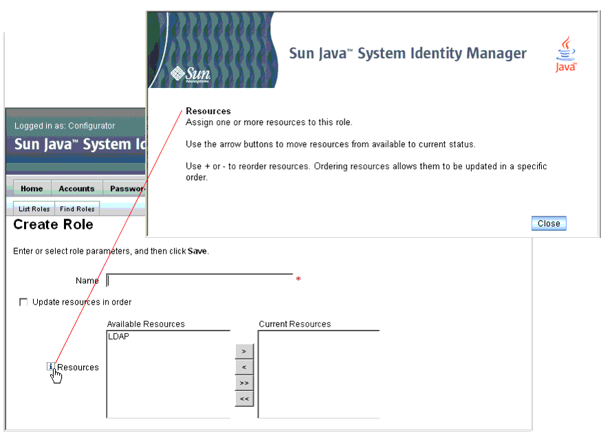

Identity Manager Guidance
Identity Manager guidance is brief, targeted help that appears next to many page fields. Its goal is to help you enter information or make selections as you move through a page to perform a task.
This symbol displays next to fields with guidance:
. Click the symbol to open a window and display its associated information.
Figure 7. Identity Manager Guidance
