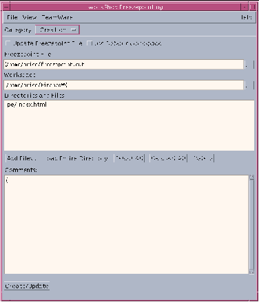

The Freezepointing window opens in Creation mode (see Figure 15-1).
File menu |
Provides a command to exit Freezepointing |
View menu |
Provides the Show Output command |
TeamWare menu |
Provides commands for starting other TeamWare tools |
Category list box |
Lets you switch between the Creation and Extraction panes of the Freezepointing window |
Update Freezepoint File checkbox |
Lets you choose to update an existing freezepoint file rather than create a new one |
Use Default Workspace checkbox |
Lets you use the workspace named in the freezepoint file |
Freezepoint File text box |
Lets you type the absolute path name of the freezepoint file |
Workspace text box |
Lets you specify the source workspace. |
Directories and Files pane |
Contains a list of files and directories that will be preserved in the freezepoint file |
Add Files button |
Opens the Add Files dialog box, where you can select files to add to the Directories and Files pane |
Load Entire Directory button |
Loads the entire workspace directory |
Select All |
Selects all the files and directories listed in the pane |
Deselect All |
Deselects all the files and directories listed in the pane |
Delete |
Deletes the selected items from the pane |
To create a Freezepoint file:
Select Creation from the Category list box.
The Creation pane is displayed.
If you want to update an existing Freezepoint file, select the Update Freezepoint File checkbox.
The Use Default Workspace checkbox is enabled.
To freezepoint the workspace named in the existing Freezepoint File, select the Use Default Workspace checkbox.
To create a new Freezepoint file, type the name for the new file in the Freezepoint File text box.
When you start Freezepointing, the Freezepoint File text box is automatically set to contain the file freezepoint.out appended to the path name of the directory from which Freezepointing was started. Delete freezepoint.out and type the path name of your freezepoint file in the Freezepoint File text box.
Path names that are not absolute are assumed to be relative to the directory in which Freezepointing is started.
Type the name of the source workspace in the Workspace text box.
When you start Freezepointing, the Workspace text box is automatically set to the workspace you have specified through the CODEMGR_WS environment variable. If the variable is not set, and the directory from which Freezepointing is started is hierarchically within a workspace, the Workspace text box is initialized with the path name of that workspace.
Create a list of the directories and files that you wish to preserve in the Directories and Files pane.
You can use the Add Files dialog box to conveniently add directories and files to the Directories and Files pane. Open the Add Files dialog box by clicking Add Files.
You can select entire groups of files by clicking and holding the left mouse button in an empty portion of the dialog box and dragging the bounding box to surround any number of icons. When you release the button, all the files within the bounding box are selected.
Select files and directories by moving the pointer over any file or directory icon and clicking. You can extend the selection to include any number of additional files and directories by moving the pointer over them and clicking the middle mouse button.
You can also type the path name of a directory or file into the Name text box.
Click Add Files to List to add the file(s) to the Directory and Files pane.
The Load Entire Directory button inserts the "./" characters into the Directories and Files pane indicating that the entire workspace hierarchy be recursively preserved.
Type an optional comment in the Comments text pane.
The comment is stored in the freezepoint file for future reference.
Select the Create/Update button to create the freezepoint file.
A counter on the bottom left corner of the Freezepointing window displays the progress of the freezepoint operation.
Use the Delete button to delete selections from the Directories and Files pane. Use the Select All and Delete All buttons to select or delete large numbers of directories and files.

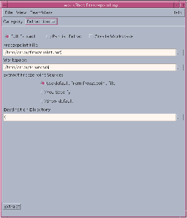

To extract a new source hierarchy described by a freezepoint file:
Select Extraction from the Category list box.
The Extraction pane is displayed (see Figure 15-2).
Type the path name of your freezepoint file in the Freezepointing File text box.
Select the Full Extract radio button or the Partial Extract radio button.
Full Extract extracts the complete set of frozen files. Partial Extract extracts a subset that you identify.
You must choose either a full or partial extract whether or not you choose to create a workspace.
Select the Create Workspace checkbox if you want to create a workspace that contains the SCCS histories of the frozen files.
Select one of the three Extract FreezePoint Sources radio buttons to specify the source workspace.
The Use default from freezepoint files radio button uses the path name of the source workspace as it is in the freezepoint file.
The You specify radio button lets you type a workspace path name.
The Show default radio button displays the path name of the source workspace in the Workspace text box.
If you wish to specify a source workspace hierarchy other than the one contained in the freezepoint file, select the You specify radio button and type the path name of the alternate source workspace in the Workspace text box.
Type the path name of the directory in which you want the new (extracted) hierarchy to be located in the Destination Directory text box.
The destination directory that you specify can be new or existing. If you extract the hierarchy to an existing directory, you receive a warning message and must confirm the operation.
Click the Extract button to begin the extraction.
If you selected Partial Extract, Freezepointing opens a dialog box listing the source files in the freezepoint file. Select the files you want to extract.
Clicking the Extract button causes a series of sccs get operations to be performed on the source files listed in the freezepoint file. The version of each file extracted is the version specified by the SMID in the freezepoint file. The extracted g-files are written to destination directory. If you have selected Create Workspace, SCCS histories are also written to the destination directory.
A counter on the bottom left corner of the Freezepointing window displays the progress of the extract operation
If, during an extraction, Freezepointing cannot locate a file that has been renamed or deleted, the extraction is aborted and the offending entry is named. You must edit the freezepoint file to remove the entry. Refer to the freezepointfile(4) man page for information that enables you to determine the new name of a renamed file.
File menu |
View menu |
TeamWare menu |
Category list box |
Full Extract radio button |
Lets you extract the complete set of frozen files |
Partial Extract radio button |
Lets you extract a subset of the frozen files |
Create Workspace checkbox |
Lets you create a TeamWare workspace from the freezepoint file |
Lets you specify the source workspace |
Extract Freezepoint radio buttons |
Use default from freezepoint file: You Select: Show default: |
Uses the path name of the source workspace
Lets you type a workspace path name Uses the path name of the source workspace |
Destination Directory text box |
Leta you specify the path name of the directory in which you want the new hierarchy to be located |
