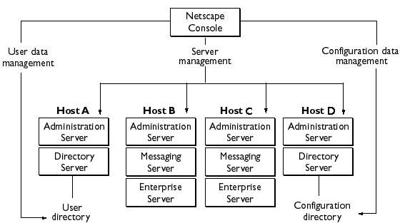

Whenever you install a Netscape 4.0 server, you must specify the location of the configuration directory, and the location of the user directory.
Figure 1.2    In this example, all servers in the enterprise share the same user directory stored on Host A. All servers share the same configuration data stored on Host D.

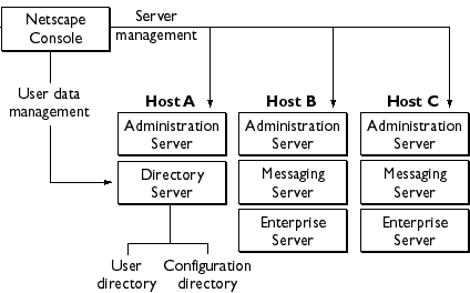

Figure 1.3    Each server group requires an Administration Server. In this example, multiple servers share a single Directory Server.

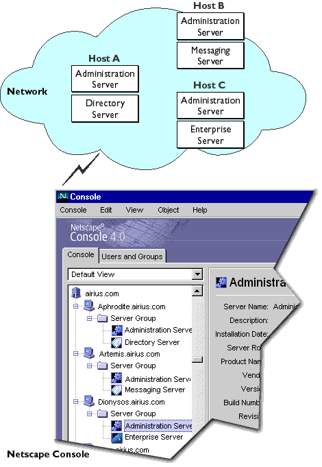

Netscape Console
Netscape Console is a stand-alone Java application. It finds all resources, and applications registered in the Directory Server, and displays them in a graphical interface. Netscape Console functions independently of any server, and you can use it from any computer or workstation connected to your enterprise.
Figure 1.4    Netscape Console graphical interface provides access to all resources under your control.
