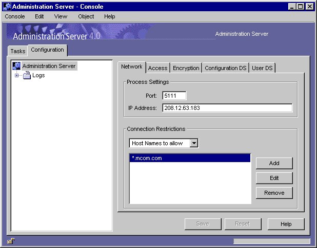

Network Settings
Network settings affect the way the Administration Server runs. You can change the system user account that runs the Administration Server. This is a user account you set up with your computer's operating system. (By default, the user is nobody on Unix, and LocalSystem on Windows NT.)
You can change the port number that the Administration Server listens to. The port number can be any number between 1 and 65535, but it is typically a random number greater than 1024. For security reasons, consider changing the port number regularly.
You can change the IP address for a server. This is useful if the host system is connected to multiple networks and you want to specify a single IP address the server should use for incomming requests and connections.
You can also specify which hosts are allowed to connect to the Administration Server.
To configure Administration Server network settings:
  1. In Netscape Console, select the Administration Server you want to modify, and then click Open.
  2. Click the Configuration tab, and then click Network.
  3. Enter network settings:
  4. Port. Enter the port number you want the Administration Server to use. The port number can be any number between 1 and 65535, but it is typically a random number greater than 1024.
    IP Address. Enter the IP address you want the server to use for incoming requests and connections.
    Server UID. Enter the system user account you want to use to run the Administration Server.
    Connection Restrictions. Displays a list of hosts currently allowed to connect to the Administration Server. Use the drop-down list to indicate whether you're adding to the list by DNS name or by IP address. The list is evaluated first by host names, and then by IP addresses. Using IP addresses may provide faster authentication.
    Add. Displays a dialog box for adding a host to the list of computers allowed to connect to the Administration Server.
    Edit. Displays a dialog box for editing a Host IP address or DNS name on the list of computers allowed to connect to the Administration Server.
    Remove. Removes a selected entry from the list of allowed hosts.
  5. Click OK.

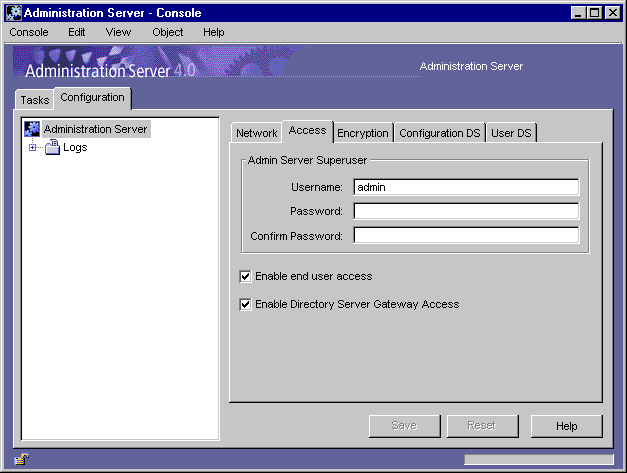

Access Settings
Access settings specify who is allowed to access these areas of the Administration Server:
To set access settings for the Administration Server:
  2. Click the Configuration tab, and then click Access.
  3. Enter access information:
  4. User name. Enter Netscape Console Administrator user ID. This is the user listed in the file <server_root>/admin-serv/config/admpw. This is the user name you entered during installation. This user has full access to all features in the Administration Server.
    Password. Enter Netscape Console Administrator's password.
    Confirm Password. Enter Netscape Console Administrator's password again to confirm it.
    Enable end-user access. Select this option if you want to allow end users to access the end-user page. Users will be able to access the end-user page using the same URL that administrators do. But they will only see a single form with their user information. An end user can change his or her own password or update any other information stored in his or her own entry in the user database.
    Enable Directory Server Gateway Access. By default, this option is selected for you. Deselect it to disable access to the Directory Server Gateway.
  5. Click OK.

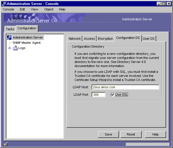

Directory Settings
The Directory Settings tell the Administration Server where to find the configuration directory and the user directory.
The Configuration Directory
When you install a server, you're asked for the location of the Directory Server that will store your server's configuration data. The Directory Server you specify contains the default configuration directory. The configuration directory is a subtree of the Directory Server. Data such as network topology information, console configuration, and server instance entries (SIEs) are stored in this subtree. Each time you install a server or change its configuration, the changes are stored in this subtree. For example, when you change a server's port number or turn on SNMP, the relevant data is stored in the configuration directory of the Directory Server.
Changing the Configuration Directory Server
You can designate a different host or port number for the configuration Directory Server.
Note. Changing the configuration Directory Server has serious and far-reaching impacts on the rest of the servers in the server group! If you change a setting here, you must make the same change in every server in the administration domain.
To change the configuration Directory Server settings:
  1. In Netscape Console, choose an Administration Server and open it.
  2. Click Configuration.
  3. Click Configuration DS.
  4. Modify settings as appropriate.
  5. LDAP Host. Enter the host name of the configuration directory this Administration Server uses.
    LDAP Port. Enter the port number for the configuration directory this Administration Server uses.
    Use SSL. Select this option if the new configuration directory is already SSL enabled.
  6. Click Save.

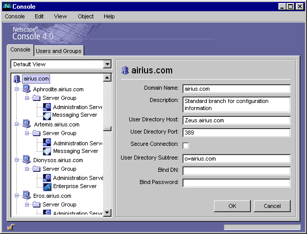

Changing User Directory Settings for a Domain
You must be the Configuration Administrator or Domain Administrator to change the user directory settings for a domain.
Note. Changing these settings will have serious and far-reaching impacts on the rest of the servers in the domain! If you make changes here, you must restart all the servers in the domain.
To change the user directory settings for a domain:
  1. In Netscape Console, select a domain, then click Edit.
  2. Modify the following:
  3. Domain Name..
    Enter a fully qualified domain name. Example: airius.com.
    Description. Enter a name that helps you identify this domain.
    User Directory Host. Enter the fully qualified name of the host system where the new user directory is located.
    User Directory Port. Enter the port number for the new user directory.
    Secure Connection. Select this option if the new user directory port is already enabled for SSL communication.
    User Directory Subtree. enter the location of the new user directory. Example: o=mcom.com
    Bind DN. Enter the distinguished name for a user who has access permisions to the new user directory. Example: uid=ginac, ou=people, o=Airius.com.
    Bind Password. Enter the password of the user above.
  4. Click OK.

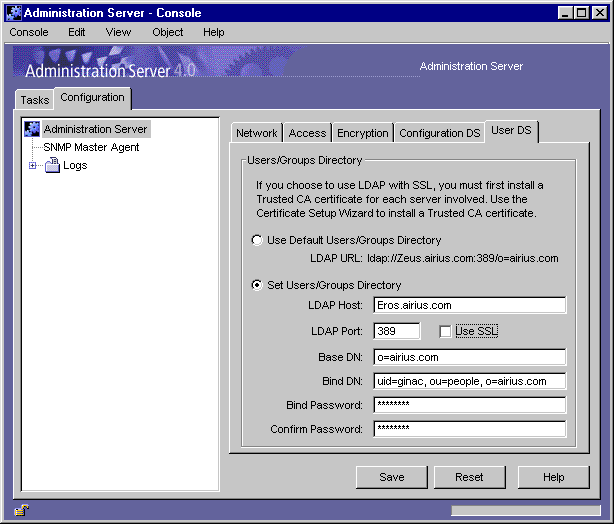

Changing User Directory Settings for a Server Group
To change the user Directory Server settings for a server group:
  3. Click User DS.
  5. Use Default User Directory. Choose this option if you want to use the default user directory associated with the domain.
    Set User/Groups Directory. Choose this option if you want to use a user directory other than the default associated with the domain.
    LDAP Host. Enter the fully qualified name of the host computer where the new user directory is located.
    LDAP Port. Enter the port number for the new user directory.
    Use SSL. Select this option if the new user directory port is already enabled for SSL communication.
    Base DN. Enter the user directory subtree location. Example: o=airius.com
    Bind DN. Enter the distinguished name for a user who has access permisions to the user directory. Example: uid=ginac, ou=people, o=airius.com
    Confirm Password.. Enter the Bind Password again to confirm it.
  6. Click OK.

Configure Administration Server - Network
Use this dialog box to specify hosts that are allowed to connect to the Administration Server.
Connection Restrictions. Displays a list of hosts currently allowed to connect to the Administration Server. Use the drop-down list to indicate whether you're adding to the list by DNS name or by IP address. The list is evaluated first by host name, and then by IP addresses. Using IP addresses may provide faster authentication.
Add or Edit Host Name
Use this dialog box when you want to add to the list of hosts allowed to connect to the Administration Server. Enter a fully qualified host name. Wildcards are acceptable. Example: *.airius.com.
Add or Edit IP Address
Use this dialog box when you want to add to the list of hosts allowed to connect to the Administration Server. Enter an IP address. Wildcards are acceptable. Example: 236.45.*
Configure Administration Server - Access
Use this dialog box to enter settings for the Administration Server Administrator.
User name. Enter the user ID for the Administration Server Administrator. This is the user listed in the file server_root>/admin-serv/config/admpw. This is the user name you entered during installation. The Administration Server Administrator has full access to all features in the Administration Server.
Password. Enter the superuser's password.
Confirm Password. Enter the superuser's password again to confirm it.
Enable end-user access. Select this option if you want to allow end users to access the user databse. Users will be able to access the Administration Page using the same URL that administrators do. But they will only see a single form with their user information. An end user can change his or her own password or update any other information stored in his or her own entry in the user database.
Enable Directory Server Gateway Access. The Directory Server Gateway is a service that provides web-based access to the entire user dirctory. By default, this access is enabled. Deselect it to disable access to the Directory Server Gateway. The Directory Server Gateway must be installed before you can use this option. See the Administrator's Guide to Directory Server 4.0 for more information.
See Also
"Network Resources and Administrative Privileges"

Configure Administration Server - Configuration DS
These settings specify the location of the Directory Server that contains your configuration directory.
Note. Changing these settings will have serious and far-reaching impacts on the rest of the servers in the server group! For example, if you change the port number here, you must reflect that change in every server in the administration domain.
LDAP Host. Enter the host name of the configuration directory that this Administration Server uses.
LDAP Port. Enter the port number for the configuration directory that this Administration Server users.
Use SSL. Select this option if the configuration directory is already SSL enabled.

Configure Administration Server - User DS
These settings specify the location of the user directory that is used for authentication and for local server management.
Use Default User Directory. Choose this option if you want to use the user directory associated with the domain. Its LDAP URL is displayed here.
Set User Directory. Choose this option if you want to use a user directory other than the default associated with the domain.
LDAP Host. Enter the fully qualified name of the host computer where your user directory is located.
LDAP Port. Enter the port number for the user directory.
Use SSL. Select this option if the user directory port is already enabled for SSL communication.
Bind DN. Enter the distinguished name for a user who has access permisions to the user directory. Example: uid=ginac, ou=people, o=Airius.com
