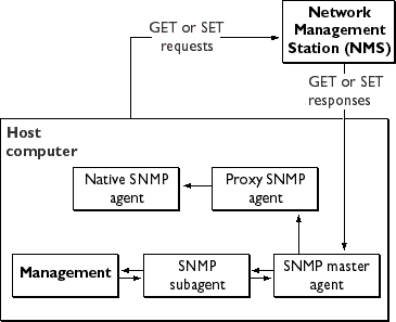

You can use Simple Network Management Protocol (SNMP) together with Netscape management information bases (MIB) and network management software, such as HP OpenView, to monitor your servers in real time just as you monitor other devices in your network. If you're using Windows NT, SNMP service is built in, and you use the Windows NT Control Panel to manage it. If you're using Unix or another platform that doesn't support the SNMP multiplexing protocol (SMUX), you can use Netscape Console to manage the SNMP service Netscape provides.
SNMP Basics
SNMP is a protocol used to exchange data about network activity. With SNMP, data travels between a managed device and a network management station (NMS) where users remotely manage the network. A managed device is anything that runs SNMP, such as hosts, routers, and Netscape servers.
An NMS is usually a powerful workstation with one or more network management applications installed. A network management application such as HP OpenView graphically shows information about managed devices. For example, it might show which servers in your enterprise are up or down, or the number and type of error messages received. When you use SNMP with a Netscape server, this information is transferred between the NMS and the sever through the use of two types of agents.
SNMP Subagent
The subagent gathers information about the server and passes the information to the server's master agent. Every Netscape server, except for the Administration Server, has as subagent.
SNMP Master Agent
The master agent exchanges information between the various subagents and the NMS. The master agent is installed with Netscape Console Administration Server.
You can have multiple subagents installed on a host computer, but only one master agent (see Figure 7.1). For example, if you had the Directory Server, the Enterprise Server, and the Collabra Server all installed on the same host, the subagents for each of the servers would communicate with the same master agent.
Figure 7.1    Interaction between the a network management station and a host computer.

Using a Proxy SNMP Agent
You need to use a proxy SNMP agent when you already have a native agent running (Figure 7.2), and you want to continue using it concurrently with a Netscape Console master agent. Before you start, be sure to stop the native master agent. (See your system documentation for detailed information.)
Figure 7.2    Using a proxy server when you're running a native SNMP agent.
To use a proxy agent, you'll need to install it and then start it. You'll also have to restart the native SNMP master agent using a port number other than the one the Netscape Console master agent is running on.

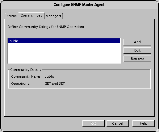

Configuring the SNMP Master Agent
Once you've enabled the master agent and enabled a subagent on a host computer, you need to configure the host's Administration Server. This entails specifying community strings and trap destinations.
Configuring the Community String
A community string is a text string that an SNMP agent uses for authorization. This means that a network management station would send a community string with each message it sends to the agent. The agent can then verify whether the network management station is authorized to get information. Community strings are not concealed when sent in SNMP packets; strings are sent in ASCII text.
The master agent uses the community string for authentication.You can configure the community string for the SNMP master agent from Netscape Console. You also define which SNMP-related operations a particular community can perform. From Netscape Console, you can also view, edit, and remove the communities you have already configured.
Adding, Editing, or Removing a Community String
To add, modify, or remove a community string:
  1. In Netscape Console, open the console for the Administration Server that is running the management software.
  2. In the Administration Server Console, click Tasks.
  3. Click the Configure SNMP Master Agent button, then click Communities
  4. Click Add, Edit, or Remove as necessary.
  5. Enter community string information as necessary
  6. Community. Enter a community string you want to add or edit. A community string is a password that an SNMP agent uses for authorization.
    GET and SET. Choose this option if you want to use this community string for requesting data or replying to messages, and for setting variable values.
    GET only. Choose this option if you want to use this community string only for requesting messages or replying to messages.
  7. Click OK.
  8. SET only. Choose this option if you want to allow this community string only for setting variable values.

Use this dialog box to add or modify the community strings used by the Administration Server's master agent.
Add. displays a dialog box for adding a new community string.
Edit. Displays a dialog box for editing an existing community string.
Remove. Removes a community string.

Status
Use this dialog box to start and stop the SNMP master agent for the Administration Server.
Check Status. Simply displays a message indicating whether the master agent is running (On) or not (Off).
Restart. Restarts the master agent.
Stop. Stops the master agent from running. You might need to stop the master agent when you're doing routine maintenance or upgrades, for example.
