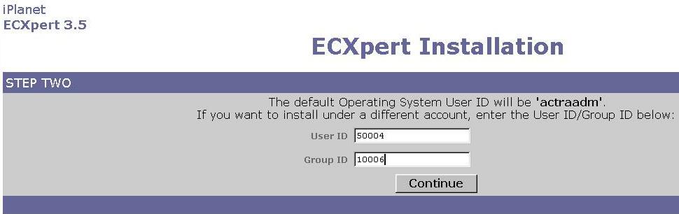

STEP TWO. For a picture of what the screen looks like at this point, see Figure 2-3 on page 56.If you used
actraadm
as your ECXpert Administrator userid, the User ID might be1120
. To determine the User ID for the ECXpert administrator user (typicallyactraadm)
, log in as the ECXpert administrator user and use theid
command. You may alternately type the command:to view the contents of the /etc/passwd file. Look for a line beginning with the ECXpert Administrator userid. Counting the ECXpert Administrator userid as the first value, the User ID is the third colon-separated value from the left.
Example:
actraadm:x:1120:500::/export/home/actraadm:/bin/csh
See Creating the ECXpert Administrator Account for instructions on setting up the ECXpert Administrator user.
If you used
actraadm
as your ECXpert Administrator userid andactra
as your ECXpert Administrator group, the Group ID might be500
. To determine the Group ID for the ECXpert administrator group (typicallyactra
), log in as the ECXpert administrator user and use theid
command.You may alternately type the command:
to view the contents of the /etc/group file. Look for a line beginning with the ECXpert Administrator group name. Counting the ECXpert Administrator group name as the first value, the Group ID is the third colon-separated value from the left.

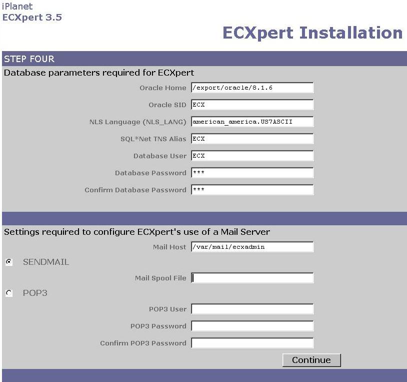

Use the values in items 5-14 below to complete ECXpert Installation Step Four. For a picture of what the screen looks like at this point, see Figure 2-8 on page 62.
Enter the directory that contains the Oracle software. This is the $ORACLE_HOME pathname. The OFA-recommended value is:
Example: /export2/oracle734/app/oracle/product/7.3.4 /export2/oracle815/app/oracle/product/8.1.5
Enter the Oracle SID, which is the name of the Oracle Server instance. If you do not know what this value is, see your
$ORACLE_HOME/dbs/init
SID
.ora
file.Note: If you are installing Oracle as a remote client, set this value to the SID on the server machine.
The NLS_LANG character set is named according to the following convention:
To query the Oracle7 Oracle8 database character set, you need the privileges to see the table
V$NLS_PARAMETERS
. Typically, only system/manager can see this table.Use the following SQL statement to check the character set language:
select * from V$NLS_PARAMETERS where parameter = 'NLS_LANGUAGE';
Use the following SQL statement to check the character set territory:
select * from V$NLS_PARAMETERS where parameter = 'NLS_TERRITORY';
Use the following SQL statement to check the character set number:select * from V$NLS_PARAMETERS where parameter = `NLS_CHARACTERSET';
Enter the SQL*Net TNS Alias. You can find this value in your
tnsnames.ora
file. This is value is also known as the "SQL*Net Connect String."Enter the name of the user who owns the ECXpert tables in the databaseECX35.
This is the user you set up as part of Creating the Oracle User ECX35.
Enter the password of the user who owns the ECXpert tables in the database.
Enter your mail host name.
If you are using sendmail, this is the name of the machine you are receiving mail on. If you are using POP3, this is the name of the SMTP server.
Enter the path to your mail directory. Note that this value is not required if you are using POP3. This value is typically
/var/mail/
username
, but it does not have to be.
Enter the userid for the POP3 user. Note that this value is not required if you are using sendmail.
Enter password for the POP3 user. Note that this value is not required if you are using sendmail.

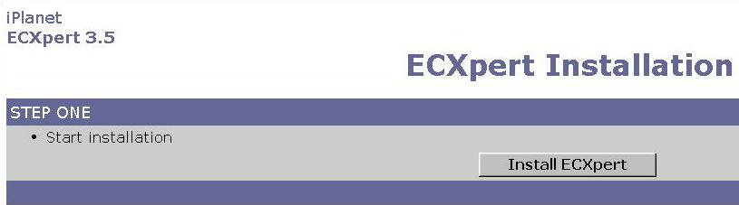

Start the ECXpert Installer by running the
cd /cdrom/ECXpert
- If this command doesn't work, enter the following command:
cd /cdrom/cdrom0
setup_exe
executable.
Enter the install directory (
./setup_exe
Do not run
setup_exe
as a background process. This program requires you to enter information to configure ECXpert.
- The program starts up and immediately displays the following licensing agreement:
- Type
y
and press Enter to accept the licensing terms, or typen
and press Enter, or just press Enter, to reject them.
- If you type
n
and press Enter, or just press Enter, the program aborts, returning you to the command prompt.
- If you type
y
and press Enter, the program immediately prompts you for a path to the installation directory.
$NSBASE
value).
- Enter the full path of your installation directory from the Configuration Worksheet and, when prompted, type
y
to confirm. If the directory you enter doesn't already exist, the program creates it for you.
- After you supply the required information, the Installer:
builds the
Enter the ECXpert temporary installation port number. This HTTP port number is from item 2 of your Configuration Worksheet on page 46. It will be replaced by the one used by the iPlanet Web Server. An example port number not in use might be: 11111. When prompted, enter y to confirm./NS-apps/ECXpert

Figure 2-2    ECXpert Installer Step One ![]()
Click Install ECXpert to begin the installation. Step Two of the Installation will be displayed as shown in Figure 2-3.
Figure 2-3    ECXpert Installer Step Two ![]()
Enter the User ID and Group ID for the ECXpert Administrator user
(typically
actraadm)
. The screen provided shows the use of an alternate User and Group ID with both expressed as numeric values.
- This is the user you created in Creating the ECXpert Administrator Account. The ECXpert administrator User ID and Group ID are the values you recorded in the Configuration Worksheet, items 3. User ID: and 4. Group ID:
- When you have entered the User ID and Group ID values, click Continue.

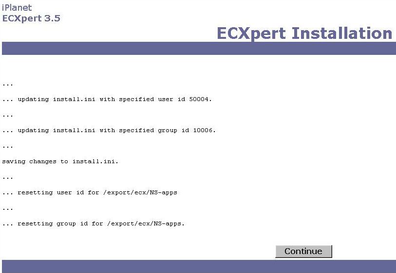

Figure 2-4    Updating/Resetting Messages for UserId/GroupId ![]()
- ECXpert will modify the configuration files to update the UserID and GroupID values. As the process proceeds, the Installer displays progress status messages, as shown in Figure 2-4. When the process has completed, click Continue at the bottom of the screen to go to step 3 shown in Figure 2-5.

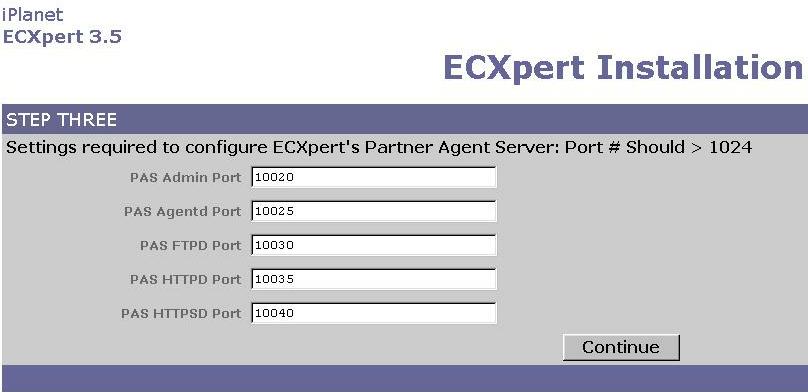

Figure 2-5    ECXpert Installer Step Three ![]()
Enter the ECXpert Partner Agent Server port information as shown in Figure 2-5. As shown, the port number should be greater than 1024. Press the Continue button when the message postings have finished.

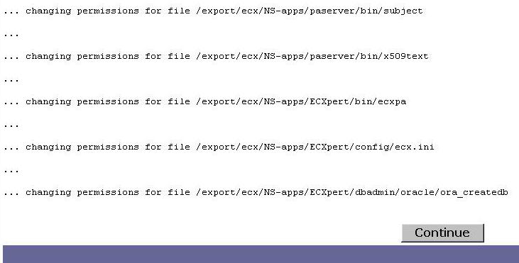

Figure 2-6    Post Step Changing Permissions Messages ![]()
- A series of messages will be displayed. Near the end of the message list will be numerous `changing permissions' messages, as shown in Figure 2-6.
Figure 2-7    ECXpert Installer Step Four ![]()
As shown in Figure 2-7, Step Four of the ECXpert installation requires entries for your Oracle database and Mail Server parameter settings.
- These are the values you recorded in Configuration Worksheet items 5. ORACLE HOME: through 14. POP3 Password:. These values may be the same as shown above.
- When using SendMail instead of POP3, the Mail Server entry is required. The Mail Spool file will default to the Mail Server directory if it is not specified. However, make sure that the ECXpert Administrative user (actraadm) is part of the "mail" group, so that this user can send and receive mail. See the following note.
If you plan to use Sendmail, use the touch command to make sure the mail file can be read/written to.
The value you enter in the Database Server field should be the same value you specified in the Setting Up and Testing Database Connectivity.
- Press Continue when finished.

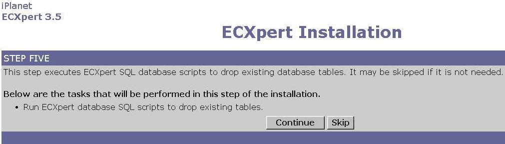

Figure 2-8    ECXpert Installer Step Five ![]()
As shown in Figure 2-8, Step Five automatically runs the SQL scripts that drop the database schema for the ECXpert database.
- If you are re-installing ECXpert Version 3.5, continue at Step 5 on page 117, in Appendix B, "Reinstalling Current ECXpert."
- If this is the first time you are configuring the database, click Skip to skip this step and go on to Step Six on page 64. If you execute this step before you have configured the database, you get error messages because the SQL script attempts to drop tables that do not exist. These error messages do not impact your installation and may be ignored.
If you are performing an upgrade or re-install of ECXpert, stop here and proceed to the appropriate continuation point indicated below. If you Click Continue, your existing database will be overwritten.
If you are migrating from ECXpert Version 3.0, continue at "Preserve Your Files" on page 103 Continue through the rest of the next section, "Upgrade to Current ECXpert" on page 104.
If you are re-installing ECXpert Version 3.5, continue at Step 3 on page 115, in Appendix B, "Reinstalling Current ECXpert."

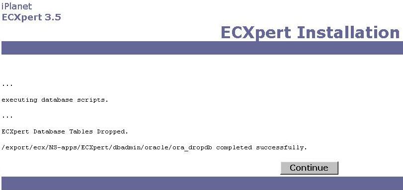

Figure 2-9    ECXpert Database Tables Dropped and Related Messages ![]()
- As the process runs, the Installer displays progress status messages, as shown in Figure 2-9. When the process has completed, click Continue to go to the next step.
- WARNING: If you are overwriting an earlier installation of ECXpert (not preserving your ECXpert database), you may get the following error when dropping the Certificates table:
ORA-02266: unique/primary keys in table reference by enabled foreign key
- To proceed, complete the following steps either before or after Step Five:
In an xterm window, log in to
svrmgrl
as system/manager.
Enter the following command sequence to drop and re-add user ECX35``:
SVRMGRL> drop user ECX35 cascade
SVRMGRL> create user ECX35 identified by ECX35
default tablespace USERS temporary tablespace TEMP;
SVRMGRL> grant connect, resource to ECX35;
Resume the ECXpert 3.5 installation where you left off (either Step Five or Step Six).

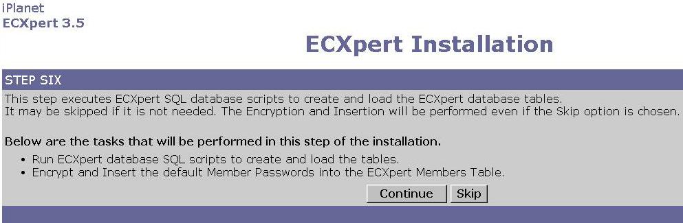

Figure 2-10    ECXpert Installer Step Six ![]()
As shown in Figure 2-10, Step Six creates and loads a new ECXpert Database. This step automatically runs the SQL scripts that create the database schema for the ECXpert database in the Oracle RDBMS, and encrypts and inserts Member passwords.
If you are performing an upgrade or re-install of ECXpert, make sure you have read the instructions at the appropriate continuation point indicated below. You should be clicking Skip on this step. If you Click Continue your existing database will be overwritten.
If you are migrating from ECXpert Version 3.0, continue at "Back Up Your Database" on page 99, in Appendix A, "Migrating from ECXpert 3.0 to Current ECXpert."
If you are re-installing ECXpert Version 3.5, continue at Step 4 on page 115, in Appendix B, "Reinstalling Current ECXpert."

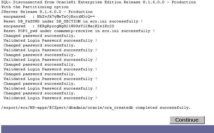

Figure 2-11    ECXpert Installer Step Six Messages ![]()
- If this is a new install, click Continue for Step Six. As the process runs, the Installer displays a process log screen, as shown in Figure 2-11.
- When the process has completed, click Continue to go to the next step.

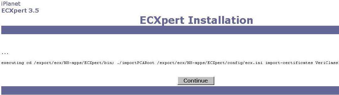

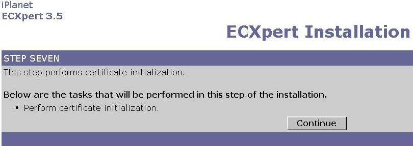

Figure 2-12    ECXpert Installer Step Seven ![]()
As shown in Figure 2-12, Step Seven Initializes certificates. Click Continue to perform this process.
Figure 2-13    ECXpert Installer Step Seven Messages ![]()
- As the process runs, the Installer displays process status messages, as shown in Figure 2-13. When the process has completed, click Continue to go to the next step.

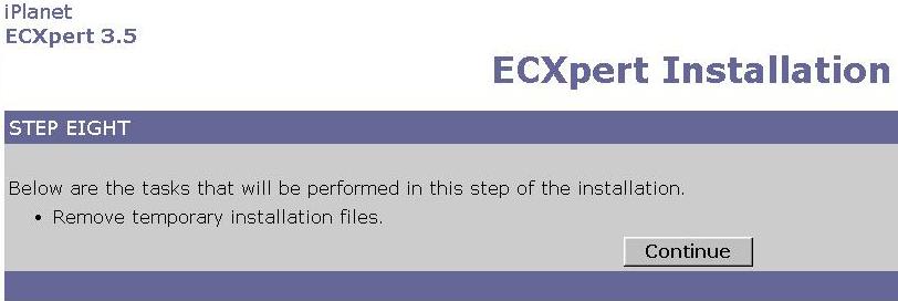

Figure 2-14    ECXpert Installer Step Eight ![]()

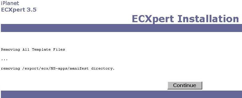

As shown in Figure 2-14, Step Eight cleans up the files from the temporary installation directory. Click Continue to perform this process.
Figure 2-15    ECXpert Installer Step Eight Message ![]()

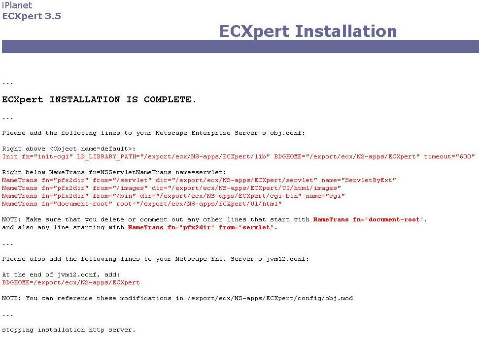

As shown in Figure 2-16, Step Nine finishes and cleans up the ECXpert 3.5 installation. Click Continue to perform this process.
Figure 2-17    ECXpert Installer Step Nine Messages ![]()
- The ECXpert Installer displays the message INSTALLATION IS COMPLETE, as shown in Figure 2-17. Also displayed are instructions to modify two configuration files: obj.conf, for the iPlanet Web Server (Netscape Enterprise Server) and the jvm12.conf, for the Web Server's version 1.2 of Java Virtual Machine. In order for these changes to take effect, you will need to shut down and restart the Enterprise Server. See step 12 below to start the Enterprise Server. See the section Applying obj.conf File Changes to apply the configuration changes to the Enterprise Server.
The bdghome/config/obj.mod file has same values as shown in Figure 2-17; you can look at this file as well to modify the obj.conf file. Also, the directory paths shown for the servlets, NameTrans fn.... may not be representative of the path for your installation implementation.
- The information on this screen is written to a file for you to use in Step 12 to modify the Netscape Enterprise Server's obj.conf file.
If you plan to enable support for AIAG E-5 2000 communications protocol, you must include the noted change to the obj.conf file for the
NameTransfn =
statement, as shown in Figure 2-17 on page 68. The need for this statement is also described in the Configuring the Servlets section of Appendix E: AIAG Administration in the Site Administrator's Handbook.

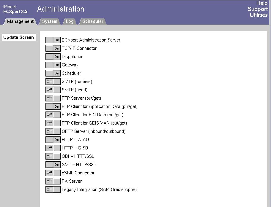

Figure 2-19    ECXpert Management screen main menu ![]()
- The Management screen appears, as shown in Figure 2-19 when the ECXpert Administration Server is On. If your screen shows the ECXpert Administration Server Off, click the On portion of the button's toggle to turn on the server. Then click the `....Updating....' prompt to the left of the On button to refresh the screen.
- Click the ECXpert Administration Server toggle switch to the
On
position to start the server.
