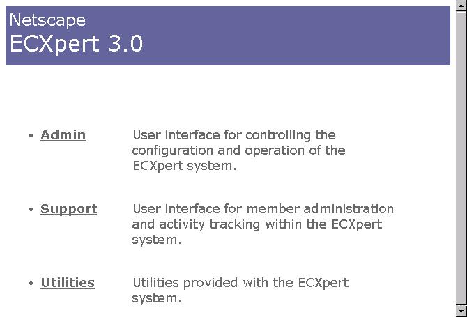

  4. Display the ECXpert Main Menu in your browser as shown in Figure A-1 by entering the URL:
    http://hostname:port#
    where hostname is the name of your ECXpert host and port# is the port number it uses.
Figure A-1    ECXpert 3.0 Main Menu

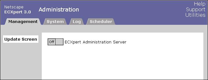

Click the Admin button to display the ECXpert Server Administration menu shown in Figure A-2.
Figure A-2    ECXpert 3.0 Server Administration menu
If any ECXpert services are running, you will see more entries than the ECXpert Administration Server with an ON indication.
Click any service switch icon that is ON to toggle the service OFF and exit your browser window.
