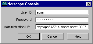

    The Netscape Console login dialog box appears:
  2. Enter a valid user name and password and click OK.

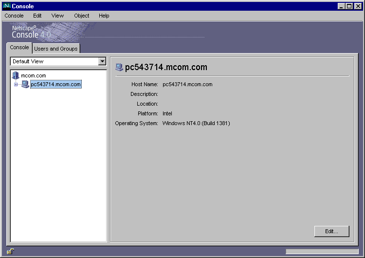

    Netscape Console's main window appears:

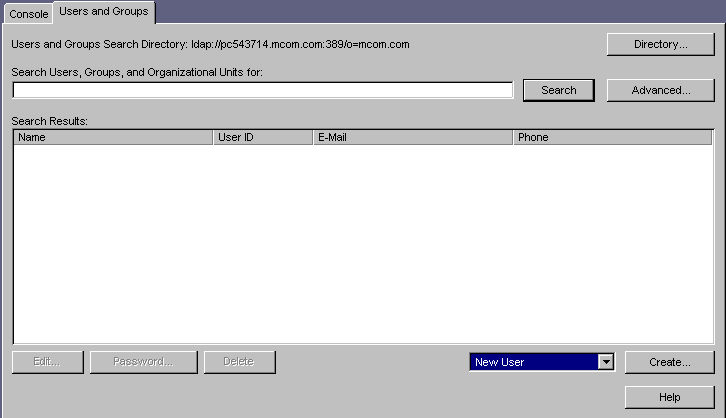

  3. Click the Users and Groups tab.
    The following window appears:
  4. Use the drop-down list in the lower-right corner of the window to choose New User, then click Create.

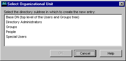

    The Select Organizational Unit dialog box appears:
  5. In Select Organizational Unit, click the directory subtree (ou) to which the user will belong, then click OK.

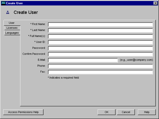

    The Create User window appears:
  6. In the Create User window, enter user information.
    • Full Name(s) is equivalent to the common name (cn) in the directory and is automatically generated based on the First Name and Last Name entered above. You can edit this name as necessary.
    • A user ID is automatically generated from the first and last names you enter. You can replace this user ID with one of your choosing. The user ID must be unique from all other user IDs in the directory.

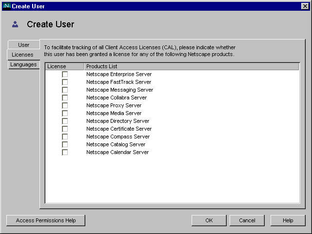

  7. Click the Licenses tab.
  8. Select the servers this user is licensed to use, then click OK.

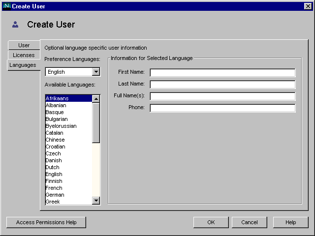

  9. (Optional) Click the Languages tab.
    • Use the Preference Languages drop-down list to select the user's preferred language. Select a language to see the Pronunciation field when appropriate.
    • Enter language-related information.

  1. In Netscape Console, click the Users and Groups tab to display the following window:
  2. Use the drop-down list in the lower-right corner of the window to choose New Group, then click Create.
    The following dialog box appears:
  3. In the Select Organizational Unit window, select the directory subtree (ou) to which the group will belong, then click OK.

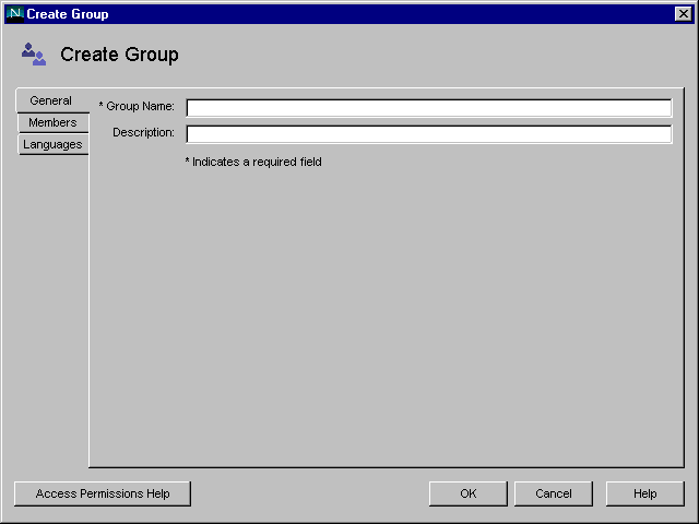

    The Create Group window appears:

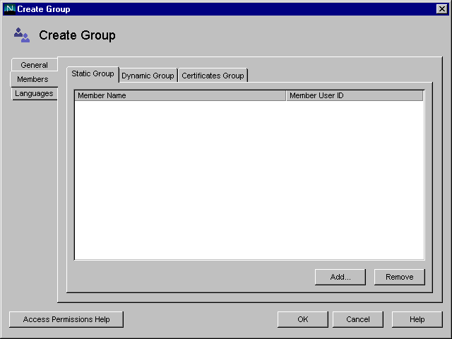

  4. In the Create Group window, enter group information, then click the Members tab.
  5. If you only want to create the group now and plan to add group members later, click OK and skip the rest of this procedure.
    To immediately add members to the group, continue to the next step.

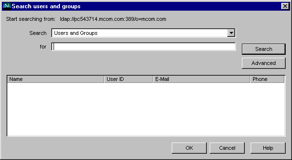

  6. In the Members window, click Add or Edit as appropriate.
    Use the Search dialog box to locate a user you want to add to the Members User ID list. Repeat this step until all the users you want to add to the group are displayed in the Member User ID list.

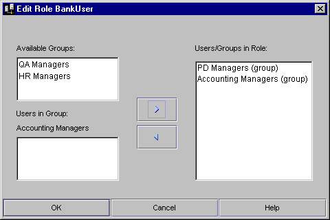

  5. Highlight the role that you want to manage and click the Edit Role button.
    The Edit Role dialog box opens showing you all the users and groups that are currently members of this role.
  6. To add a group and a user to a role, complete the following:
    1. To add a group to a role, in the Available Groups box, highlight one or more groups and click the right-arrow button.
      Note When you select multiple groups from the Available Groups box, the users in the Available Users box are not displayed.
    2. To add a user to a role, first highlight a group that the user currently belongs from the Available Groups list and then highlight the user(s) in the Users in Group box. Finally click the right-arrow button to add the user to the role.
  7. To remove a group or user from a role, highlight the user(s) and or group(s) in the Users/Groups in Role box and click the left-arrow.

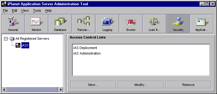

To create an access control list, perform the following steps:
  1. On the iAS Administration Tool toolbar, click the Security button to open the Security window.

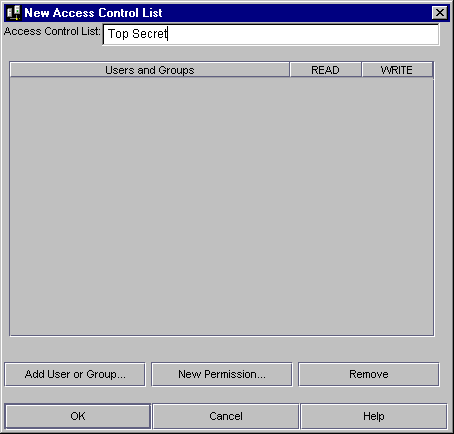

    The New Access Control List dialog box appears.
  3. In the Access Control List field, enter a name for the ACL.
    The name can be any word or words you choose to distinguish one ACL from another.

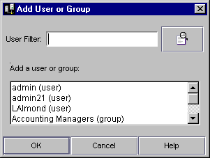

  4. To add a user or group to the ACL, click the Add User or Group button at the bottom of the dialog box.
    The Add User or Group dialog box appears.
  5. Select the users and/or groups you want to add to the ACL.
    You can filter the list of users that appears in the result set by entering a string in the User Filter text box. For instance, to show only user IDs that begin with "F," enter F* in the User Filter text box, then click the User Filter button. The user IDs matching your filter criteria appear in the list box below. The User Filter applies only to users, not to groups.
  6. Click OK.

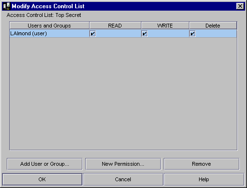

  10. To set the appropriate permissions for the groups in the ACL, check each permission for that group.

To modify an access control list, perform the following steps:
  2. Highlight the Access Control List that you want to modify.
  3. Click the Modify button located at the bottom of the window.
    The Modify Access Control List dialog box appears.
  4. To add a new user or group, click Add User or Group.
  5. Select the group or groups you want to add to the ACL.
    You can filter the list of users that appear in the list by entering a string in the User Filter text box. For instance, to show only user IDs that begin with "F," enter F* in the User Filter text box, then click the User Filter button. The user IDs matching your filter criteria appear in the list box below. The User Filter applies only to users, not to groups.
  6. Click OK.
  7. To create a new permission, click New Permission.
    The New Permission dialog box appears.
  8. To edit the permissions of a group, select or deselect the appropriate permissions for that group.
  9. To remove a group, select that group and click Remove.
