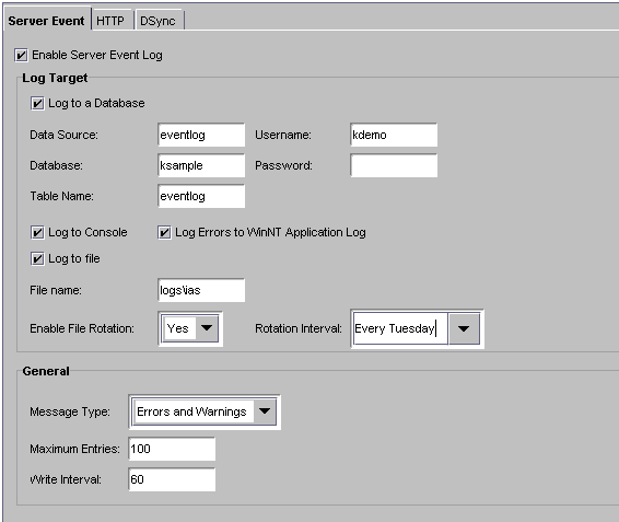

When you enable logging, the logging service automatically sends messages to the process consoles on Windows NT and Unix platforms, as long as those consoles are open and console logging enabled. On Windows NT, the logging service also sends messages to the application log. Logging to a process console does not record the messages. You cannot retrieve the messages once they scroll off of the screen.
To enable the logging service and specify the destination of the log messages, perform the following steps:
  1. Click the Logging button on the iAS Administration Tool toolbar to open the Logging window.
  2. Select the Enable Server Event Log checkbox.
  3. In the Log Target box, choose the type of logging to enable by clicking the desired checkboxes:
    • Log to a Database
    • Log to Windows NT Application Log (Errors Only)
    • Log to File
    You can disable console logging by deselecting the Log to Console checkbox.
    See in the following section and for more information.
    If you chose to log to a file, that file is created now. See for information about managing log files.
iAS uses a log buffer to store messages before they are written to the application log, an ASCII file, and/or database logs. This buffer optimizes the performance of the application server by limiting the use of resources to continually update a log. The buffer is written to the destination when either the buffer interval times out or the number of entries in the buffer exceeds the maximum number allowed.

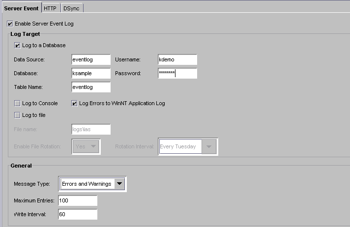

Logging to a Database
If you plan to log application server messages to a database, you need to create an event log database table. The following table describes the four field names and lists each field's data type.
Note On a UNIX system, you can use supplied scripts that automatically set up the eventlog and httplog tables. The scripts are located in the directory $GX_ROOTDIR/APPS/GXApp/Logging/db, and are named Log_db2.sql, Log_ifmx.sql, Log_mssql.sql, Log_ora.sql, and Log_syb.sql. Choose the script that is appropriate for the database you're using.
Table 5-3 Logging to a Database Table
Database field name
Description
Data type
evttime
Date and time the message was created
Date/Time
evttype
Message type, such as information, warning, or error
Number
evtcategory
Service or application component ID
Number
evtstring
Message text
Text
The logging service maps the message components to the database fields listed in the table. You must use these exact field or column names in your database table.
To log to database, perform following steps:
  2. Select the Enable Server Event Log checkbox as shown in the following figure:
  3. In the Log Target box, click the Log to Database checkbox.
    Enter the data source, the database name, the table name, and the user name and password necessary for accessing the database.
  4. In the General box, from the Message Type drop-down box, select Errors, Errors and Warnings, or All Messages.
  5. Click the Apply Changes button to save your changes to iAS Administration Tool.

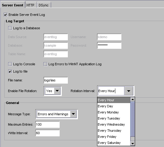

Rotating Log Files
If you choose to record server messages in an ASCII file, you can enable log file rotation to regulate when log files are rotated. Since log files are stamped with the time and date they are created, log file rotation helps organize log files into manageable units.
To configure log file rotation, perform the following steps:
  3. Click the Log to File checkbox.
  4. In the Enable File Rotation drop-down box, choose Yes.
  5. From the Rotation Interval drop-down box, select the interval at which log files are rotated or enter a string to indicate when the log file is rotated.
    For instance, the following string indicates logging to a new file begins at 1:00 AM every Monday, as well as on the fifteenth of each month:
       1:0:0 1/15/*
    The following string indicates logging to a new file begins at 2:00 AM, 5:00 AM, 6:00 AM, and 7 AM every Friday:
       2, 5 - 7:0:05/*/*
  6. In the General area, from the Message Type drop-down box, select Errors, Errors and Warnings, or All Messages.
  7. Click Apply Changes to save your changes to the iAS Administration Tool.

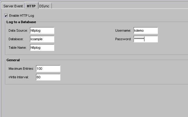

Logging Web Server Requests
Before you can log web server requests, you must create a database table to hold the request messages. For more information about creating this table, see
To log web server requests, perform the following steps:
  2. From the left pane of the Logging window, select the application server responsible for logging web server requests.
    If you have more than one application server, you can specify one server to log web server requests.
  3. In the right pane of the logging window, click the HTTP tab.
    The following window appears:
  4. Enter httplog in the Data Source field.
  5. Enter the information you use to connect to the database in the Database field. For example, this would be the Oracle SID for an Oracle database.
  6. In the Table Name field, enter httplog.
  7. Enter the user name and passwords with which you connect to the database. Enter the maximum entries.
    This number represents the greatest number of entries that can exist before data is written to the log.
  8. Enter the write interval.
    This number represents the amount of time that lapses before data is written to the log.
  9. Click Apply Settings to save your changes to your application server.

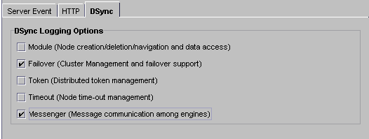

About DSync Logging Options
iAS supports Distributed Data Synchronization (DSync) across multiple iAS for partitioned and distributed applications. DSync provides cluster management and data synchronization across iAS processes. The iAS Administration Tool provides for logging of DSync messages.
For more information about distributed data synchronization, see
How DSync Messages Are Logged
    • DSync provides a component based architecture that allows you to choose which components you want to log. All DSync debug messages appear in KXS, KCS, and KJS log files. DSync debug components are the following:Module: Provides data management and appends other DSync components to the log file. When enabled, the methods executed by DSync are logged.
    • Failover: Provides cluster membership management. When enabled, interactions between servers and how roles change due to failure of servers/engines/network connection are logged.
    • Token: Provides distributed lock management features. When enabled, interactions between servers for read/write tokens associated with DSync nodes are logged.
    • Timeout: Provides life cycle management of DSync nodes per timeout specification. When enabled, nodes that are deleted due to timeout are logged.
    • Messenger: Provides message communication between iAS servers. When enabled, messages that are created, sent, received and processed are logged.
In addition, you can dump cluster and DSync node data into iasdsync-cluster-XXX.log and iasdsync-node-XXX.log files respectively where XXX represents the port number of an engine.

Logging DSync Messages
To log DSync debug messages, perform the following steps:
  2. From the left pane of the Logging window, select the application server responsible for logging DSync messages.
  3. In the right pane of the logging window, click the DSync tab.
  4. Specify the DSync components you want to log as follows:
    • Module: Provides data management and appends other DSync components to the log file. When enabled, the methods executed by DSync are logged.
    When specifying DSYNC components, you do not have to shutdown and restart iAS for changes to take affect.
  5. Optionally, click Dump Cluster Info to dump DSync state cluster information to a iasdsync-cluster-XXX.log file where XXX is the port number of an engine.
    For information about the format of this log file, see Format of the Cluster Dump Files.
  6. Optionally, click Dump Node Info to dump DSync state node information to a iasdsync-node-XXX.log file where XXX is the port number of an engine.
    For information about the format of this log file, see Format of the DSync Node Dump Files.
