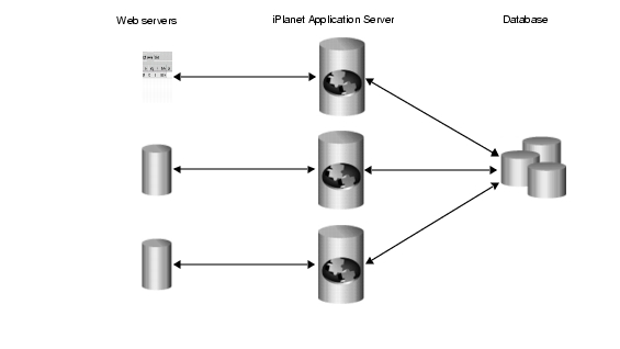

Hosting applications locally on multiple servers is the simplest of the three most common server configurations. In this configuration, you deploy the complete application on each iPlanet Application Server machine. If the application is already installed on an iPlanet Application Server machine, you can use the Deployment Tool to deploy the application to other servers.This configuration requires that you configure each web connector plug-in to forward requests to the appropriate iPlanet Application Server machine.
Alternatively, it is possible to deploy local applications across multiple iPlanet Application Server instances while sharing a common web server and LDAP server. This configuration functions much like the first example, except that there is a single web server, and all iPlanet Application Server instances share a common configuration through the same LDAP server. This configuration has the advantage in that load balancing can be done across multiple iPlanet Application Server instances whereas the prior example requires clients to access multiple different web servers. While this scenario is possible, it may or may not be suitable for your particular application.

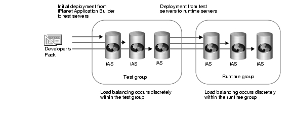

The following illustration depicts a load-balancing distribution as discussed in the Example 1:
Balancing application loads between existing production servers and new servers that you add to the enterprise.
- Example 1: You might have three iPlanet Application Server machines used for testing applications. Your production environment, where users' requests are actually processed, also consists of three iPlanet Application Server machines. Because the application components could be different between the two groups of servers, you do not want to enable application load balancing. Therefore, when you deploy an application from the test servers to the production servers, you should choose only to balance the loads between the destination servers.
Deploy the application locally to the server or servers (no load balancing).

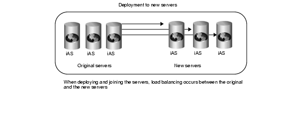

- Example 2: Suppose you scale the enterprise to include three more iPlanet Application Server machines in the production group, you can join all the servers in that group when deploying the applications from one of the existing production servers to the new servers. The application loads are then balanced between the existing servers and the new servers. (Scenario 2)
The next illustration depicts a joining of servers when adding new servers to a group and deploying an application to those servers with the join option as discussed in Example 2.

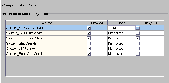

In the right pane of the Application window, select each application component for which you want to change the distribution level as follows:
Local--The servlet or AppLogic runs on one iPlanet Application Server machine only
In the Mode column, change the distribution level.Distributed--The servlet or AppLogic runs on specified iPlanet Application Server machines
Global--The servlet or AppLogic runs anywhere in the enterprise.
If you are changing the distribution level for all components in the selected group, click Toggle Mode. All application components are updated simultaneously.
