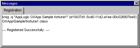

Registering Files
Netscape Application Builder incorporates automatic registration for project servlets. However, you can also register files manually via the Build menu.
To register afile, perform the following steps:
  1. Open or select the file.
  2. Choose Register - File(s) from the Build menu.
To register all project files, Choose Register - All from the Build menu.

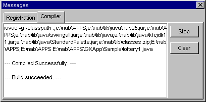

The Messages window (usually located just below the Properties window) is an information window that displays the associated compilation errors, warnings, and other data about your servlets.

  1. From the Build menu, choose Build Project.
  2. Click Stop to stop the compile process; click Clear to reset the message window.
If the servlet contains no syntax errors, Netscape Application Builder displays the Compiled Successfully message.

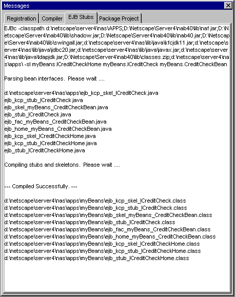

Building EJB Stub and Skeleton Code
When you select a bean and then choose Complie file(s) from the Build menu or choose Build or Rebuild Project, Netscape Application Builder opens the EJB Stubs tab in the Messages window to display the results of the compilation:
Errors during compilation will appear in this window as well. For an example of creating and compiling an EJB, see "Task 11: Creating Enterprise JavaBeans" on page 221.

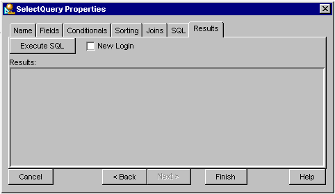

Netscape Application Builder enables you to test your queries before you deploy your application.
To test a query, perform the following steps:
  1. From the File menu, choose Open to open the desired query file or double-click the query file in the project map window or within the Project window.
  2. Click the Query Properties Results tab.
  3. To execute the associated SQL code for the specified query, click Execute SQL. Note that you can also right-click the query file from the Project window and select Test to perform this action or from the Test menu, select Test MyQuery_Name.
  4. Type the appropriate information for these fields and click OK.
  5. To test the SQL for a new login, click New Login.
  6. Click Finish if you are satisfied with the test results; otherwise, continue to edit the associated query SQL until you obtain the correct results. If Netscape Application Builder cannot parse your SQL, all other query editing tabs are disabled except the SQL and Results tabs.
