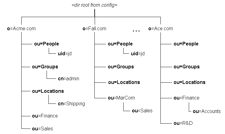

The directory information tree (DIT) structure assumed by BuyerXpert/SellerXpert is shown in Figure C-1.
Figure C-1    LDAP DIT Structure
All the organizations are represented by a subtree rooted at a node of type o, o=Acme.com.

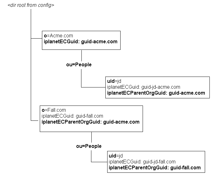

Sub-organizations also have their own subtree under the directory root designated for BuyerXpert/SellerXpert.All entries are uniquely identified by the iplanetECGuid attribute. The iplanetECParentOrgGuid attribute identifies the parent organization to which that entry belongs, as illustrated in Figure C-2.All users belonging to every organization are stored in the subtree ou=People one level below the organization node.
All user groups belonging to every organization are stored in the subtree ou=Groups one level below the organization node.
Organizational units are hierarchical and rooted from the organization node.
Figure C-2    iplanetECGuid and iplanetECParentOrgGuid Attributes
Notice that the iplanetECGuid attribute is unique for every entry. The iplanetECParentOrgGuid attribute refers to the iplanetECGuid attribute regardless of the respective parent organizations. Thus, o=Acme.com is parent organization of o=Fall.com. The entry o=Acme.com does not have any value for the iplanetECParentOrgGuid attribute, indicating it is a top-level organization with o=Fall.com as a subsidiary organization.
