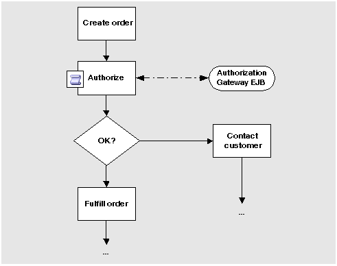

Your JavaScript process automation script can create an instance of an EJB and call the EJB's methods to perform business logic. For example, an order-entry application might create an instance of an EJB that represents a credit card authorization gateway. The application would call methods to check the credit card number, authorize the transaction, and create a charge on the account, as shown in Figure 12-1:
Figure 12-1    Programming logic for calling an EJB component

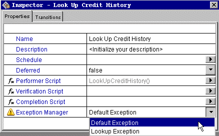

If an exception is thrown, the process instance moves to the exception manager that you specify in the Inspector window, as shown in Figure 12-2:
Figure 12-2    Setting an exception manager in Process Builder

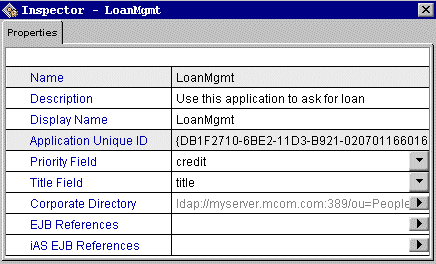

  3. Right click on the application name in the application tree view and select Properties.
  4. The properties Inspector appears.
    Figure 12-3    The properties Inspector.
  5. Select the arrow corresponding to EJB References.

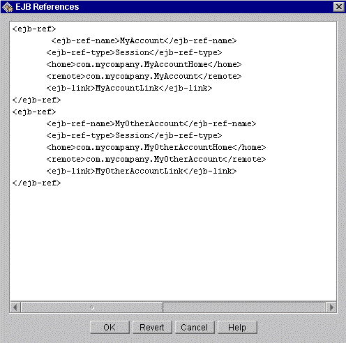

  6. The EJB References editor window appears.
    Figure 12-4    The EJB References editor.
  7. Enter the EJB references in the editor window.
The syntax is identical to J2EE deployment descriptor files. For example, if your PM application uses EJBs called MyAccount and MyOtherAccount, the EJB references might look like this:
Code Example 12-1    Example of an EJB reference

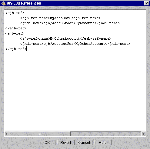

  6. The iAS EJB References editor window appears.
    Figure 12-6    The iAS EJB References editor.
  7. Enter the iAS EJB references in the editor window.
  8. The syntax is identical to J2EE deployment descriptor files. For example, if your PM application uses EJBs called MyAccount and MyOtherAccount, the iAS EJB mappings might look like this:
    Code Example 12-2    Example of an iAS EJB Reference
