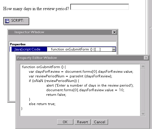

Verifying Form Input with Client-Side JavaScript
Process Builder provides two ways to write client-side scripts to verify form input:
- using an embedded script that defines an onSubmitForm function that gets invoked when the form is submitted.
- using onValueChange and onClick event handlers for specific form elements.
For every data field represented in a form, the form contains a form element that has exactly the same name as the data field. Client-side scripts can access data field values as they are currently displayed in the form. The scripts do this by accessing form elements that have the same name as the data field.
If the form contains an embedded client-side script that defines an onSubmitForm function, that function is invoked when the user presses an action button on the form. You can define an onSubmitForm function to check values of form elements and offer the user a chance to enter new values in cases where the current values are invalid. If the onSubmitForm function returns false, the form is not submitted. See the section "onSubmitForm Example" for a coded example of an onSubmitForm function.
You can also define client-side scripts to check the value of individual form elements. Some data fields have an onClick or onValueChange property. The value of this property is a JavaScript expression. These properties correspond to event handlers in the associated form elements. For more information about form elements, refer to any reference on HTML tags.
The onClick script is fired when the form element is clicked. For elements whose value is changed by clicking, such as radio buttons, the onValueChange script behaves just like an onClick script, and is fired whenever the user clicks the form element. For other elements, such as text fields, the onValueChange script is fired when the form element loses focus after its value has changed, which usually happens when the user presses the return key or clicks elsewhere in the form. To see exactly which data fields have onClick and onValueChange scripts, see the properties for the different kinds of data fields in Process Builder.
You can define onClick, onValueChange, and onSubmitForm scripts that display an alert box or a confirm box to warn the user that an invalid value has been entered. Use the alert() function to display an alert box, and use the confirm() function to display a confirm box.

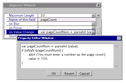

Event Handler Example
The following onValueChange script for a text field checks if the value of the text field is a number. If the value is not a number, it displays a dialog box with a warning and resets the page count value to 100 in case the user ignores the warning. If the value is a number, it does nothing. (Note that in event handlers, such as in client-side scripts, you must use single quotes instead of double quotes.)
var pageCountNum = parseInt (value);
if (isNaN (pageCountNum)) {
alert ('You must enter a number as the page count');
value = 100;
Figure 11-1 shows the definition of this onValueChange event handler in the Inspector window in Process Builder.
Figure 11-1    A definition for an onValueChange event handler
The following example shows an embedded client-side script that defines an onSubmitForm function. In this case, the script checks that the value entered in the daysForReview form element is a number. If not, the script displays a warning dialog box, sets the value of the daysForReview form element to 10, and returns false to give the user a chance to change the value and submit the form again.
function onSubmitForm () {
var daysForReview = document.forms[0].daysForReview.value;
var reviewPeriodNum = parseInt (daysForReview);
if (isNaN (reviewPeriodNum)) {
alert ('Enter a number of days in the review period');
document.forms[0].daysForReview.value = 10;
return false;
else return true;
Figure 11-3 shows an embedded client-side script that defines an onSubmitForm function in Process Builder:
Figure 11-3    A script that defines an onSubmitForm function

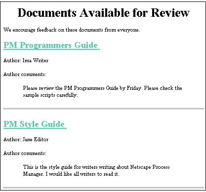

Automation Script
This script updates a link to a newly submitted document in a file that lists all documents available for review.
This script could be used as an automation script in a process that enables writers to submit documents for review. In the entry point form, the writer uses a File attachment data field called docFileName to attach the document. Many different writers can use the application to submit documents. The file docList.html contains an active link for every document that has been submitted with this application. The file docList.html lives in the top level of the content store so that all process instances in the application can access it.
Two files are involved in the document list. The file docList.html is an HTML-formatted list of the documents with an active link for each document. The file showList.html contains opening HTML tags, the list of documents (which is the same as docList.html), and closing HTML tags. This script uses two files so that it can add the closing HTML tags after adding the information for the newly submitted document.
function updateDocReviewWebPage(){
// Get the process instance.
var pi = getProcessInstance();
// docList.html and showList.html are stored at the
// top level in the content store.
// Get the root URL for the content store.
var myStore = getContentStore();
var storePath = myStore.getRootURL();
// Get the full pathnames to docList.html and showList.html.
var docListPath = storePath + "docList.html";
var showListPath = storePath + "showList.html";
// Get the contents of the doc list.
var docList = myStore.getContent(docListPath);
// Get the pathname to the doc that was submitted for review.
var docURL = pi.getData("docFileName");
// Get info about the newly submitted document.
var docname = pi.getData("docname");
var writer = pi.getData("writername");
var writerComments = pi.getData("writerComment");
// Add a link to the newly submitted doc in the doc list.
docList += "<A HREF=" + docURL + ">";
docList += "<H2><FONT COLOR='#55CCAA'>" + docname +" </H2></FONT></A>";
docList += "<P>Author: " + writer + "</P>";
docList += "<P>Author comments: </P>";
docList += "<BLOCKQUOTE>" + writerComments + "</BLOCKQUOTE><HR>";
// Store the doclist back into docList.html
myStore.store (docList, docListPath);
// Create the final content, which contains the heading tags,
// the doc list, and the closing tags.
var finalContent = "<HTML><HEAD><TITLE>" +
"Documents available for review </TITLE></HEAD>";
finalContent += "<BODY><CENTER><H1>" +
"Documents Available for Review" +
"</H1></CENTER><P>" +
"We encourage feedback on these docs from everyone.</P>" +
docList + "</BODY></HTML>";
myStore.store (finalContent, showListPath);
return true;
Figure 11-5 illustrates the showList.html web page. This page is updated each time a document is submitted for review.
Figure 11-5    A web page that is updated automatically
