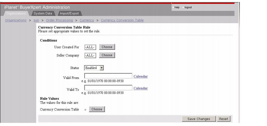

Conversion tables can also be used to convert currencies and weights. To use a conversion table, a rule must be set up. Weight conversion table and quantity conversion table rules are under Order Processing. The Currency Conversion Table rule is under Order Processing-Currency Rules.

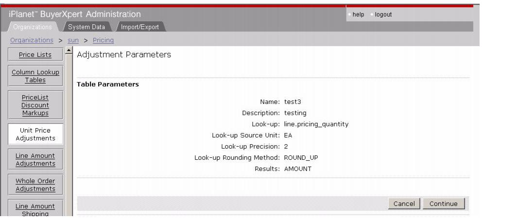

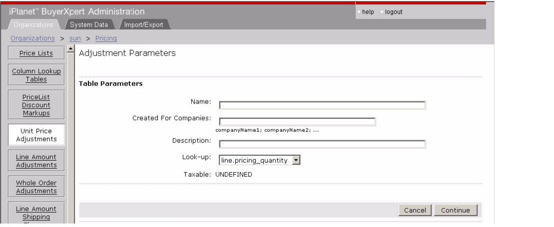

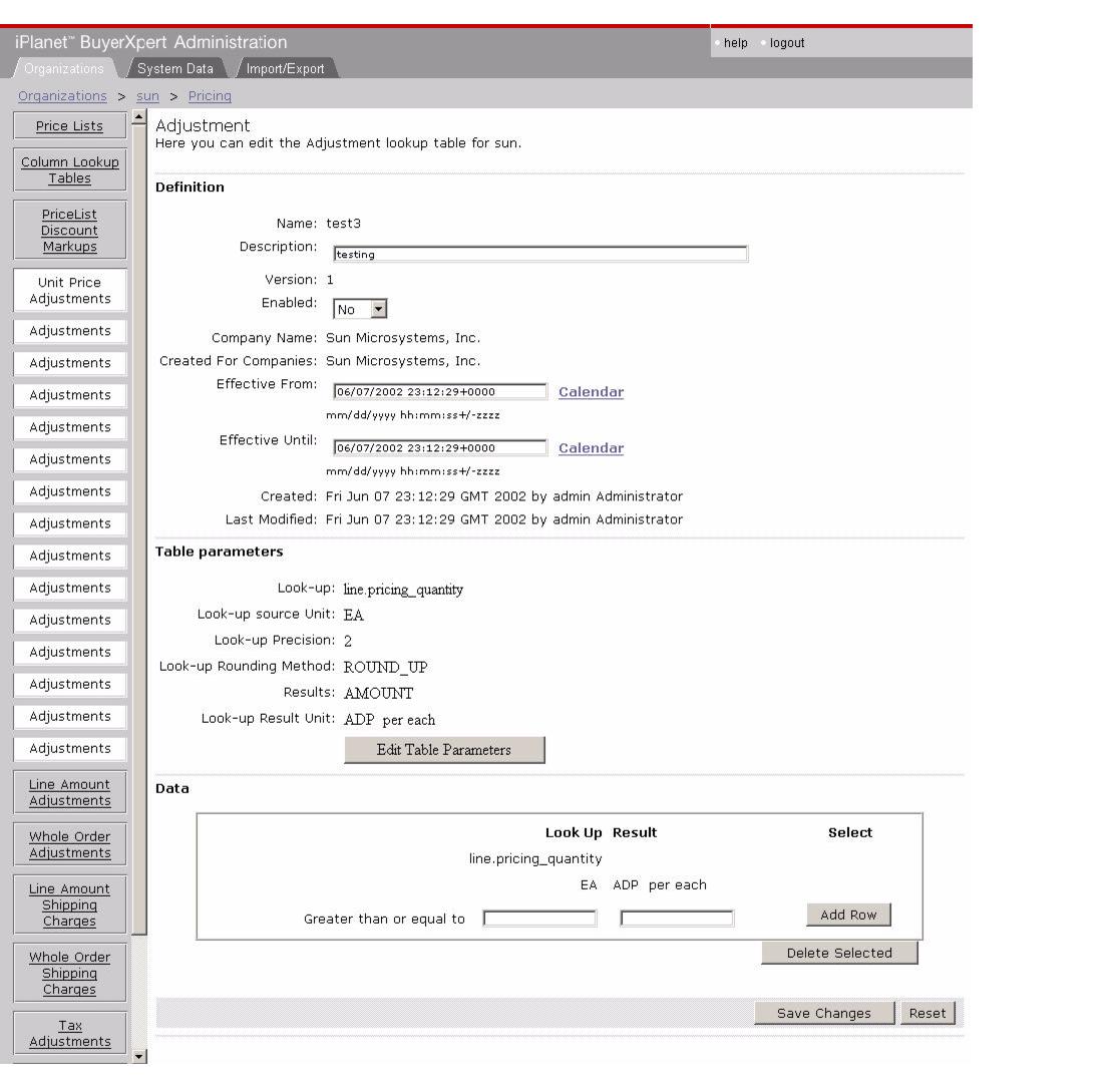

Follow these guidelines to create a pricing adjustment using the Admin interface (field and procedure details are contained in Help):
Select Pricing>Unit Price Adjustments.
Select New Table (Blank) to create a totally new pricing adjustment table.
OR
Click an existing table and select New Table (Copy Selected) to copy an existing table that you will modify and save under a new name.
Enter the name of the adjustment, the name (s) of the organization(s) for which the adjustment can be used, and the description.
Choose Look-up (the condition that is used to calculate adjustment amount) from the drop-down menu.
Enter look-up precision and choose the look-up-rounding method.
Choose results amount or percentage.
The pricing adjustment results are applied to line.gross_price. If you have chosen a percentage, the resulting adjustment is a percentage of line.gross_price.
Enter the appropriate look-up condition and result value.
Repeat the previous step for all the look-up conditions.
When done, change the Effective-from and Effective-until dates as needed. Repeat this procedure to create all other pricing adjustments.

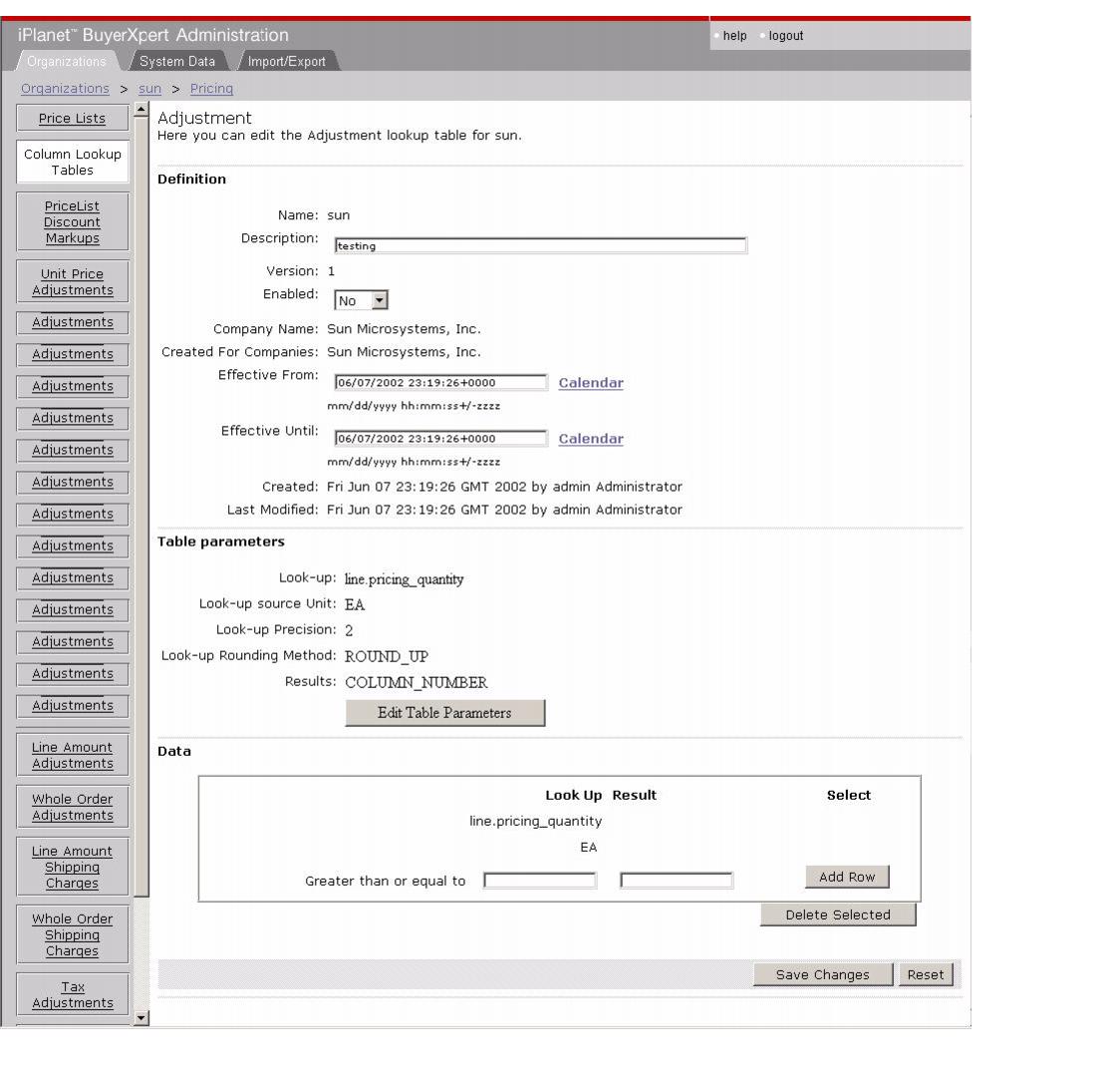

Defining a Column Lookup Table
Follow these guidelines to create a column lookup table using the Admin interface (field and procedure details are contained in Help):
Select Pricing>Column Lookup Tables.
Select New Table (Blank) to create a totally new column lookup table.
OR
Follow procedures in Help to complete the task.
Creating a Column Lookup Table Adjustment
This adjustment is optional. If a column lookup table adjustment is not used, the default price column rule is applied.
After the price list columns are set up, you can set up adjustments which determine the column to be looked up in the price list.You can do this in the Pricing>Column Lookup Tables screen.
You can set up such situations as this: If the quantity ordered in more than 100 items, use column 2, which is the deeply discounted price. However, if the buyer only orders 10 items, use column 3 of the price list, which is not as deep a discount.

Select Pricing>Whole Order Adjustments.
The Whole Order Adjustments screen appears.
Select New Table (Blank) to create a totally new adjustment table.
OR
After the order adjustment is set up, rules can be set up under Pricing>Discount Charge Rules>Group Adjustments.
Creating a Line-Level Adjustment
Follow these guidelines to create a line-level adjustment using the Admin interface (field and procedure details are contained in Help):
Select Pricing>Line Amount Adjustments.
The Line Amount Adjustments screen appears.
OR
After the line adjustment is set up, rules can be set up under Pricing>Discount Charge Rules>Line Adjustments.

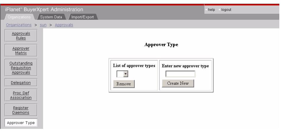

Creating Approver Types
You can create approver types in the Admin interface under Approvals> Approver Types. After an approver type is created, it appears on the dropdown menu.

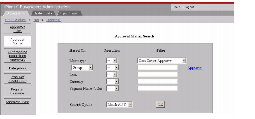

Creating an Approval Matrix
Approval matrixes can be administered through the Admin interface or the Import utility. If the Import utility is used, you need to specify which organization owns the resource and which organizations the resource has been created for.
Follow these guidelines to create an approval matrix for an organization using the Admin interface (field and procedure details are contained in Help):
Select Approvals>Approval Matrix.
Search for an existing matrix to update.
OR
Click Add in the Matrix Details window to add a new matrix.
The top portion of the screen shows the result of the search in the form of a table; the lower portion allows you to add/update entries.
Click the del link to delete an entry from the table.
Click Matrix Id to view or update the details on the lower screen.
Click the Approver link on the bottom of the screen to choose the approver. This can be either a user or a group, depending on your selection of Approver Type.
Click Segment to add segment entries for that approver.
Select the approver, which in this case is a group (because our selection of Approver Type was Group). Once selected, the group appears on your last screen along with its limit and currency as set by the Approval Limit rule.
Note The limit field is editable, meaning you can create multiple entries for the same approver having varying limits.
Typically, segment names and values are the same as accounting codes or commodity codes. For example: segment names are kept as `department', `division,' and `project.' Or for a commodity code item, this can be `class', `family,' or `commodity'.
After adding the segment, click Done.

Creating Order Processing Rules
Set up all the currency rules:
Set up all the unit conversion rules:
Quantity Conversion Table (general 1)
Weight Conversion Table (standard 2)
For the Precision Rule, enter 2 as the value.

Select Approvals>Approver Type.
Set up the approval limit rule by selecting Approvals > Approvals Rules > Approval Limit. Make sure you add a default rule for the whole organization in addition to adding specific limits for specific approvers.
Note If you don't set up a default rule, you might not be able to see the approval graph.
