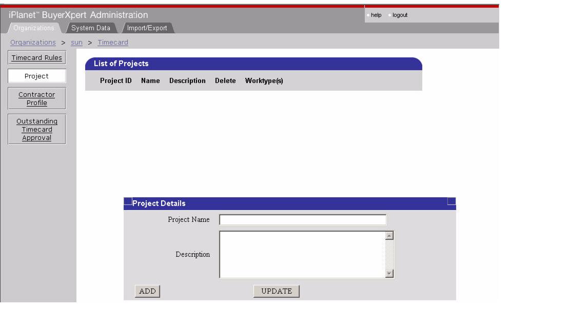

Setting Up a Timecard Project
Follow these guidelines to set up a timecard project using the Admin interface (field and procedure details are contained in Help):
Select Timecards.
Follow procedures in Help to fill in the fields.
Click ADD to add a new project, or UPDATE to change an existing project.
For a new project, you need to define the various worktypes associated with the project by selecting the Create Worktype(s) link.
Choose from the list of work types
OR
Add your own work type.
Click Create New.
To make any changes to a Timecard Project table line, click the associated Project ID.

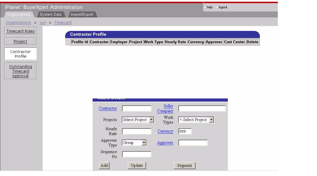

Setting Up a Contractor Profile
Follow these guidelines to set up a timecard contractor profile using the Admin interface (field and procedure details are contained in Help):
Select Timecards.
Select Contractor Profile. The Contractor Profile table displays above the Matrix Details window.
Enter data in the fields of the Matrix Details window.
To make any changes to a Contractor Profile table line, click the associated Project ID.
