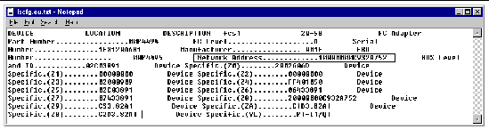

Before you can create host filters, you need to know the world wide name (WWN) for the FC HBA that connects your host to your FC array.
For supported IBM HBAs, follow these steps:
1. Determine the device name by typing the command:
2. Type the following command:
Output similar to the following is displayed. The network address is the WWN.
