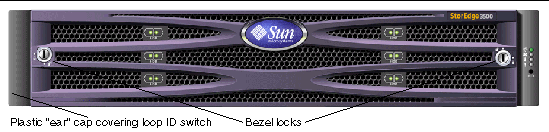

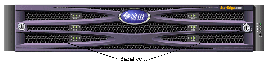

The bezel on your array has two locks whose keys can be removed when the locks are in either the locked or open position. It is possible to reconfigure the locks so that the keys cannot be removed.
To change the locks so the keys cannot be removed, follow these steps:

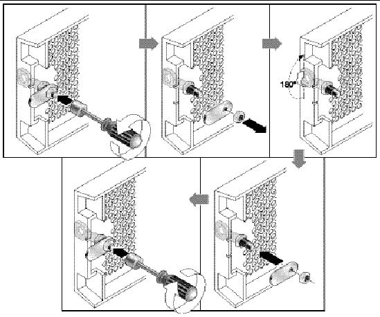

1. Remove the bezel by gently pivoting the swing arms out of their ear sockets.
See Removing the Front Bezel and Ear Caps for step-by-step instructions on how to remove the bezel.
2. Make sure the key is in the locked position, with the pawl extending horizontally past the edge of the bezel.
3. Hold the key in place and use a 12 mm or 3/8-inch nut driver to remove the locking nut that holds the pawl in place, as shown in the first panel of FIGURE 4-2.
Caution - Be sure to hold the key in place. Otherwise there is a risk of breaking the small tab on the lock that serves as a stop. |
4. Lift the pawl off the threaded part of the lock body, as shown in the second panel of FIGURE 4-2.
5. Set the pawl aside, face up, so that you can remember its orientation when you replace it.
6. Use the key to turn the lock 180 degrees, as shown in the third panel of FIGURE 4-2
7. Replace the pawl in the same orientation as before, as shown in the fourth panel of FIGURE 4-2.
8. Hold the key in place and use the nut driver to refasten the locking nut that holds the pawl in place, as shown in the fifth panel of FIGURE 4-2. Be careful not to cross-thread the nut.
Note - To convert your bezel locks so that the keys can be removed, repeat this procedure. |

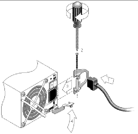

When you connect the AC power cords, you should install the provided two cord locks at the same time. The provided AC cord locks are used to securely fasten the AC cable connectors.
Caution - If the array is connected to AC power sources not within the designated 90-135, 180-265 VAC PFC range, damage might occur to the unit. |
Note - To ensure power redundancy, be sure to connect the two power supply modules to two separate circuits (for example, one commercial circuit and one UPS). |
To connect the AC power cords, perform the following procedure:
1. Obtain an appropriate AC power cable.
2. Use a screwdriver to remove the screw and cylindrical standoff from one of the two cord locks provided and set them aside for reassembly later.
3. Slide the cord lock over the AC power connector.
4. Hold the cylindrical standoff between the two screw-holes on the flanges of the cord lock.
5. Insert the screw into the first screw-hole, through the standoff, and then into the threaded screw-hole on the other flange.
6. Tighten the screw with a screwdriver until the flanges bottom out on the cylindrical standoff.
7. Push the power cord into the power supply receptacle until it is firmly seated.
8. Push the green ejector handle forward until it is seated against the power supply.
9. Turn the thumbscrew of the green ejector handle clockwise until it is finger-tight to secure the handle and the cord lock.
10. Repeat this procedure for the second cord lock and second power cable.

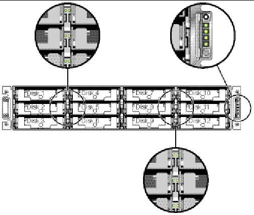

3. Check for the following LED activity:
All front panel LEDs turn solid green to indicate good operation.
See the chapter Checking LEDs for more information about your array's LEDs.

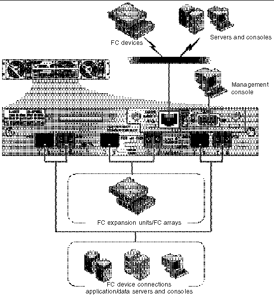

Each I/O controller module has six ports that accept SFP transceivers. These ports are labeled FC0 through FC5. The default configurations do not include an SFP connector on every SFP port. You might want to add or rearrange SFPs, depending on the configuration mode (loop or point-to-point), number of planned host connections, the necessary number of redundant connections to hosts, and the number of expansion units needed.
The SFP is a single-port, optical SFP transceiver for multimode (short wave) or single-mode (long wave) use. They are compatible with the Small Form Factor Pluggable Multi-Sourcing Agreement (MSA, Sep. 2000), and 1x and 2x Fiber Channel. The optical connector used is the low-profile LC connector.
SFPs are Sun field-replaceable units (FRUs) and can be ordered from Sun Microsystems. These SFPs have been selected and tested to provide the necessary reliability and performance. SFPs from other vendors are not supported.
To see an example of an array that has SFP connectors in all the SFP ports of the RAID array and the upper expansion unit, refer to the illustration RAID Array Attached to Two Hosts and Two Expansion Units.
To review various configuration options, see the discussions following Configuration Overview. Refer also to the configuration options presented in the Sun StorEdge 3000 Family Best Practices for the Sun StorEdge 3510 FC Array.

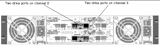

Drive channels connect to the internal drives in the array and can also connect to drives in external expansion units. Configured for redundancy, each controller in a dual-controller RAID array has two adjacent dedicated drive channels on one loop to load-balance I/O operations (see FIGURE 4-6). Each drive channel has two SFP ports that can be connected to expansion units. Drive channels 2 and 3 access all the disk drives and are interconnected to load-balance I/O operations.
The controller module in slot A (the upper slot) houses drive channel 2, which connects to the 12 internal disk drives through their A ports. The controller module in slot B (the lower slot) houses drive channel 3, which connects to the 12 internal disk drives through their B ports.

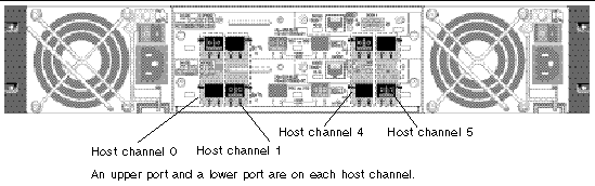

Host channels connect to host computers either directly or through storage switches or other devices. In a default dual-controller RAID configuration, each controller has four host channels, channels 0, 1, 4, and 5 (FIGURE 4-7). Port bypass circuits connect each pair of host SFP ports on a host channel; as a result, each host channel accesses both controllers.
In dual-controller arrays, SFPs are initially plugged into one of each pair of host and drive ports. The default port connections are:
This configuration provides connections to all four host channels as well as to both drive channels.

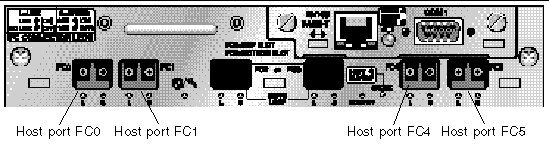

In the default single-controller array, SFPs are initially plugged into FC0, FC1, FC4, and FC5. No SFPs are plugged into the drive channels. This configuration is appropriate for connecting to up to four hosts or fibre switches, with no connection to expansion units.
In a default JBOD expansion unit array, SFPs are initially plugged into the upper left port and lower right port.
Fibre Channel arrays use SFP connectors to attach to hosts and expansion units. These SFP connectors resemble the one shown in FIGURE 4-11, with a single connector at the end that plugs into an SFP port on the array or expansion unit chassis, and a duplex jack into which you insert a cable to make the connection.

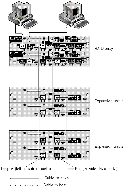

FIGURE 4-12 shows an example of a RAID array connected to two expansion units. You can connect up to eight expansion units to a RAID array in certain configurations. These configurations are described in the Sun StorEdge 3000 Family Best Practices Manual.
The connections to the expansion units are designed to keep all A drive ports on the same loop and all B drive ports on the same loop. Several cabling configurations are possible, each with its own advantages and disadvantages. Refer to the Sun StorEdge 3000 Family Best Practices Manual for the Sun StorEdge 3510 FC array for more information about the suitability of various configurations for various application requirements, as well as for information about configurations involving more than two expansion units.
In the RAID array, two of the unused SFP host ports could be used to provide redundant pathing to the two servers, and the other four unused SFP host ports could be connected to two more servers in a redundant configuration.
Similarly, you can connect expansion units to other channels (which are separate from channels 2 and 3) if you configure channels 0, 1, 4, or 5 as drive channels. For details, refer to Configuring FC Channels as Host or Drive (Optional).

On the left front side of an expansion unit, an ID switch is used to set the loop IDs for the disk drives to a different range of values so that the same IDs are not repeated on the same loop.
Setting the loop ID on an array requires dropping the front bezel out of the way and removing the small vertical plastic cap on the left side of the bezel that cover the left rackmount tab. Rackmount tabs are often referred to as "ears."

In a default array configuration, channels 0, 1, 4, and 5 are host channels, so you can directly connect an FC array to four host computers. SFP connectors are plugged into channels 0 and 4 on the upper controller and channels 1 and 5 on the lower controller for this purpose.
If you want to connect an FC array to more than four host computers without changing the default configuration, you can connect these four host channels to ports on storage switches in a storage area network (SAN) configuration.
Use fiber-optic cables to connect from one to four host channels to Fibre Channel HBAs on your host computers or to other devices such as storage switches:
1. Connect a fiber-optic cable to an HBA or FC port on each host or storage switch you want to connect to the array.
2. Connect the SFP connector at the other end of each of these fiber-optic cables to host channel SFP connectors on the back of the array.
If there is no SFP connector in the port you want to use, first insert an SFP connector into the port as described in Changing Your SFP Configuration.
