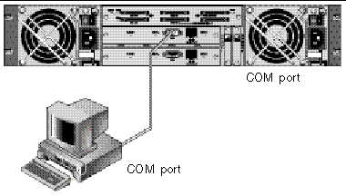

1. Use a null modem serial cable to connect the COM port of the RAID array to an unused serial port on your host system.
A null modem cable has serial signals swapped for connecting to a standard serial interface.
Note - A DB-9-to-DB-25 serial cable adapter is included in your package contents to connect the serial cable to a DB-25 serial port on your host if you do not have a DB-9 serial port. |
