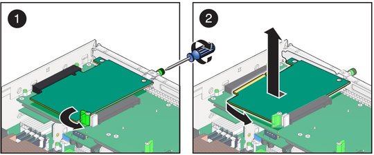

Removing the PCIe2 card is a cold-service operation. You must power off the server before you remove the PCIe2 card.
See Locate a Faulty PCIe2 Card.
If you are removing the PCIe2 card from the PCIe2 mezzanine board, go to Step 2.
If you are removing the PCIe2 card from a PCIe2 riser card, see Remove a PCIe2 Card From the PCIe2 Riser Card.
If you have not prepared for service, do so now. See Preparing for Service.
If you are removing the PCIe2 card as part of another component's removal or installation procedure, go to Step 3.
If you removed the PCIe2 card as part of a replacement operation, install a new PCIe2 card. See Install a PCIe2 Card Into the PCIe2 Mezzanine Board.
If you removed the PCIe2 card as part of another component's removal or installation procedure, return to that procedure. See Component FRU Names and Service Links for assistance.
If you are not replacing the PCIe2 card, go to Step 7.
