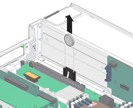

Removing the battery is a cold-service operation. You must power off the server before you remove the battery.
If you have not prepared for service, do so now. See Preparing for Service.
If you are removing the battery as part of another component's removal or installation procedure, go to Step 2.
If you removed the battery as part of a replacement operation, install a new battery. See Install the Battery.
If you removed the battery as part of another component's removal or installation procedure, return to that procedure. See Component FRU Names and Service Links for assistance.
