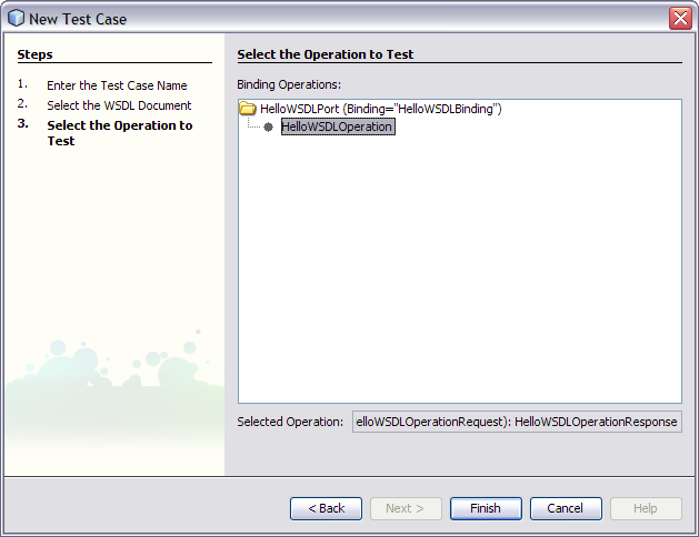

  5. From the Select the Operation to Test page, select HelloWSDLOperation and click Finish.
    image:Select the operation test page
    A new TestCase1 node is added under the project's Test node in the Projects window, containing two subnodes, Input and Output.

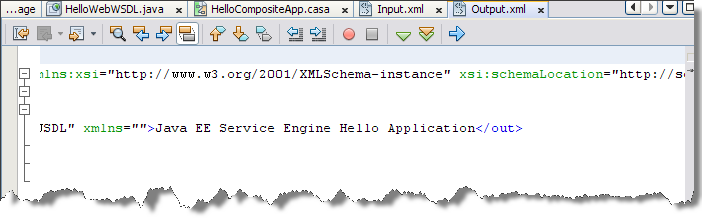

  4. To check the output, double-click the Output node under TestCase1.
    In the Output.xml tab, according to this tutorial example, the result should have a string as shown in the figure below.
    image:Output string in source editor
