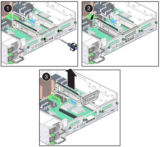

Removing the PCIe2 riser card is a cold-service operation. You must power off the server before you remove the PCIe2 riser card.
Note - The three PCIe2 riser cards appear to be nearly identical, however they are not. If you are removing two or all three PCIe2 riser cards, do not confuse their respective installation locations in the chassis. Riser card A installs on the left, riser card B installs in the center, and riser card C installs on the right.
If you have not prepared for service, do so now. See Preparing for Service.
If you are removing the PCIe2 riser card as part of another component's removal or installation procedure, go to Step 2.
Two captive screws secure the PCIe2 riser card to the rear panel. One captive screw secures the PCIe2 riser card to the motherboard.
If you removed the PCIe2 riser card as part of a replacement operation:
Remove any installed PCIe2 card. See Remove a PCIe2 Card From the PCIe2 Riser Card.
Install a new PCIe2 riser card. See Install a PCIe2 Riser Card.
If you removed the PCIe2 riser card as part of another component's removal or installation procedure, return to that procedure. See Component Service Task Reference for assistance.
