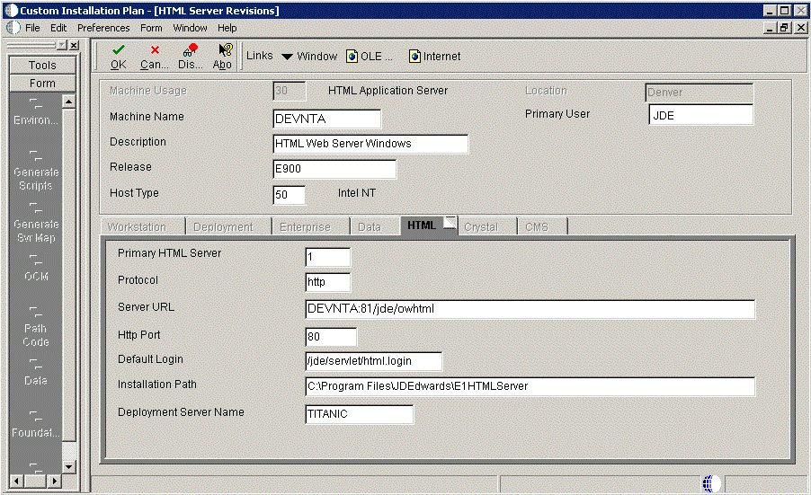

To set up the plan for the JD Edwards EnterpriseOne HTML Web Server, you must provide Installation Planner with the name of the HTML Web Server machine, its platform type, and other information. Installation Planner populates the F9650 and F9651 Enterprise Server tables.

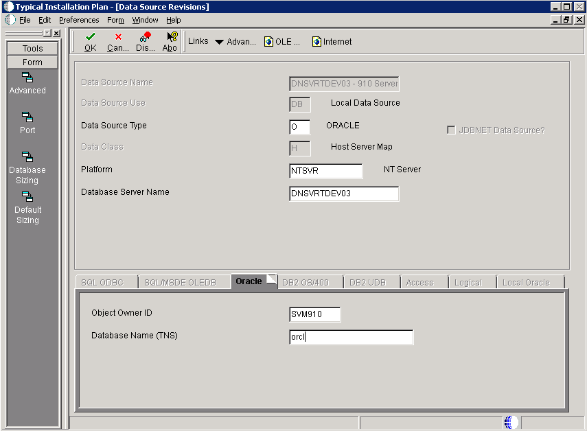

Server Map
Server Map data sources are specific to each Enterprise Server, so you must create one for each server.

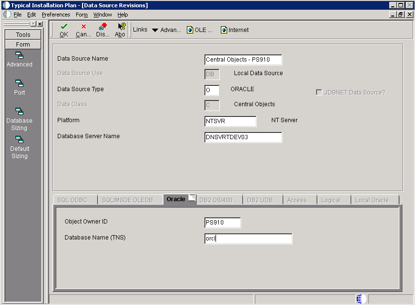

You must also set up these data sources for each environment:
Control Tables
This is the data source for the Control Tables. You can have multiples (for example, Control Tables - Prod, Control Tables - Test, and Control Tables - CRP).
Central Objects
The data source for the Central Objects specification tables is identified by the type and version number of the software. You can have multiple sets of Central Objects specifications (for example, Central Objects - PD910, Central Objects - PS910, Central Objects - DV910, and Central Objects - PY910). However, you can have only one Central Objects data source for each path code.
Business Data
This is the data source for the Business Data tables. You can have multiple sets of Business Data data sources (for example, Business Data - CRP, Business Data - PROD, Business Data - TEST, and Business Data - PS910).
Versions
The data source for the Versions List table (F983051). You can have multiple sets of versions tables (for example, Versions - PD910, Versions - PS910, Versions - DV910, and Versions - PY910). However, you can have only one Versions data source for each path code.

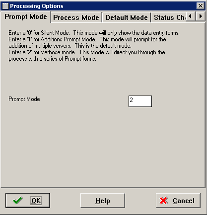

To specify the prompt mode:
Select the Prompt Mode tab.
On the Prompt Mode tab, select a prompt mode:
| Value | Model | Description |
| 0 | Silent | Installation Planner displays only the data entry forms. |
| 1 | Additions Prompt | Installation Planner prompts you to add servers. |
| 2 | Verbose | Installation Planner directs you through creating a plan with a series of prompting forms. |

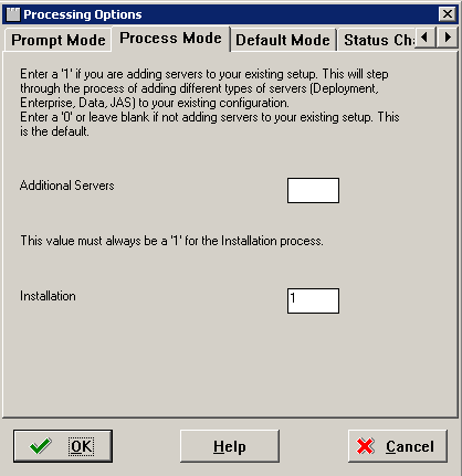

To specify the process mode:
Select the Process Mode tab.
On the Process Mode tab, select the options for the processes that you want to run when you create your plan:
Additional Servers
Enter 1 to add servers to your existing setup (Deployment Server, Enterprise Server, Database Server, HTML Web Server). Enter 0 or leave blank for regular plans.
Installation
Enter 1 to run the JD Edwards EnterpriseOne installation automatically.

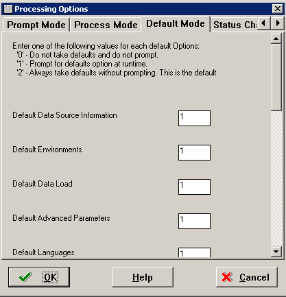

To specify the default mode:
Select the Default Mode tab.
On the Default Mode tab, enter these values into the processing option fields:
| Value | Description |
| 0 | Do not use default values and do not prompt. |
| 1 | Prompt for default options at run-time. |
| 2 | Default mode. Always use defaults without prompting. |

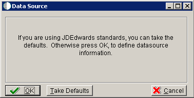

Default Data Source Information
Select whether you want the ability to modify data source information or just take the default values.
Default Environments
Select whether you want the ability to select environments or take the default values.
Default Data Load
Select whether you want the ability to modify data load parameters or take the default values.
Default Advanced Parameters
Select whether you want the ability to modify advanced parameters or take the default values.
Default Languages
Select whether you want the ability to select an alternate language or take the default values.
Upgrade/Update Plan Generation
Select whether you want the ability to generate a plan automatically from locations and machines defined in a previous version of the software.

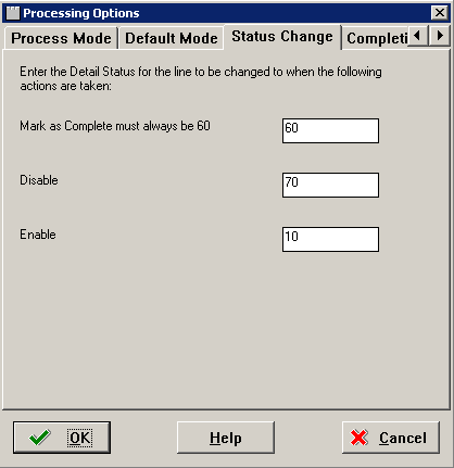

On the Status Change tab, this tab form appears.
Do not make any changes on this tab. These values are hard coded in the application

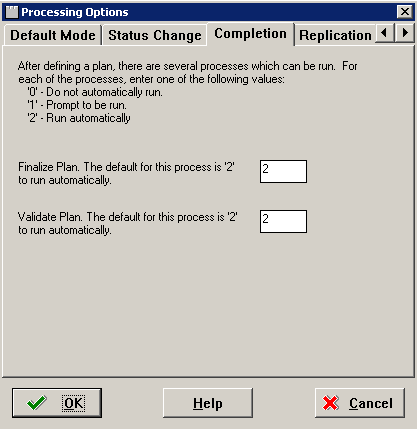

To specify plan completion processes:
Select the Completion tab.
On the Completion tab, complete the fields using these values:
After defining the plan, the options on this tab specify which processes are run. one of the following values:
| 0 | Do not run automatically. |
| 1 | Prompt to be run. |
| 2 | Run automatically. |
Finalize Plan
Enter the default option 2 to run automatically.
Validate Plan

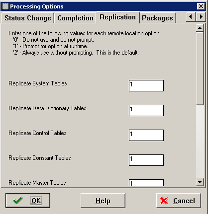

To specify replication options:
Select the Replication tab.
On the Replication tab, complete the fields using these values:
| 0 | Do not use and do not prompt. |
| 1 | Prompt for option at run-time. |
| 2 | Always use without prompting . |
Replicate System Tables
Select whether you have the option to replicate system tables automatically for remote locations.
Replicate Data Dictionary Tables
Select whether you have the option to replicate data dictionary tables automatically for remote locations.
Replicate Control Tables
Select whether you have the option to replicate control tables, menus, and user defined codes automatically for remote locations.
Replicate Constant Tables
Select whether you have the option to replicate constant tables automatically for remote locations. Business data tables are Object Librarian type 280.
Replicate Master Tables
Select whether you have the option to replicate master tables automatically for remote locations. Business data tables are Object Librarian type 210 and 211.

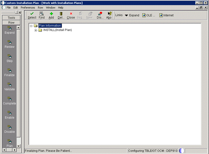

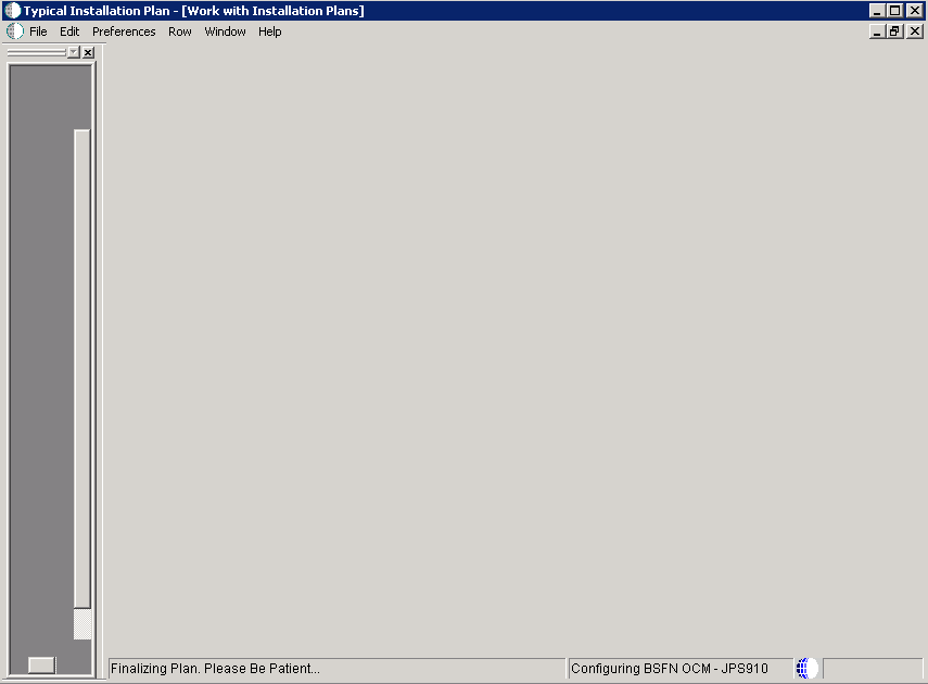

To start Installation Planner from within JD Edwards EnterpriseOne:
Access the System Installation Tools Menu (GH961).
On the System Installation Tools menu, double-click Typical Installation Plan.
On Work with Installation Plans, click Add.
The Installation Planner form appears.
Enter a Plan description.

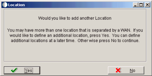

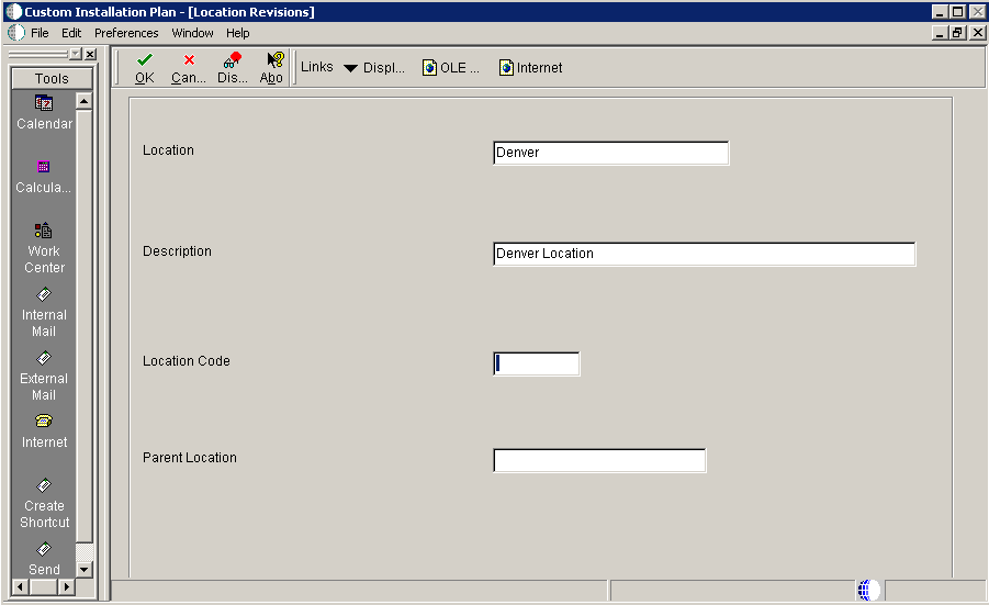

A location groups related Deployment Servers for use in a multi-tier environment.
To enter location information:
On Location Revisions, complete these fields:
| Field | Description |
| Location | Enter the location to which this plan applies; the location can be a city, company headquarters, or a division of the company. |
| Description | Enter a description for this location. |
| Location Code | If this is the base location, this field is only available when you are adding the base location. If you are editing an existing base location, the field is unavailable. |
| Parent Location | If this is the base location, this field is only available when you are adding the base location. If you are editing an existing base location, the field is unavailable. |
Click OK.

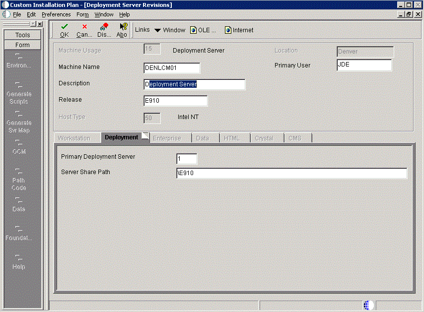

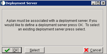

While Release 9.1 enables more than one Deployment Server to be defined, only the primary Deployment Server is defined at this time. You can choose a primary Deployment Server from the list of existing servers or you can enter information for a new server.
If you installed JD EnterpriseOne files to a remote Deployment Server, the deployment server name is the remote machine name by default.To enter Deployment Server information:
On Deployment Server Revisions, complete or verify these fields:
| Machine Usage | The value 15 appears by default, indicating that this is a Deployment Server. |
| Machine Name | The name of the Deployment Server appears by default. The name is case sensitive, should not exceed 15 characters, and should not contain any special characters.
Remote Deployment Server. If you installed JD EnterpriseOne files to a remote Deployment Server, the deployment server name is the remote machine name by default. |
| Description | Enter a long description for the machine. This description should include the location with which this Deployment Server is associated and whether or not it is the primary server. |
| Release | Enter the JD Edwards EnterpriseOne release number you are installing or use the visual assist button to choose one from the list. The default value is E910. |
| Host Type | The value 50 appears by default, indicating that the server type is Intel NT. |
| Location | Your current location is the default value. |
| Primary User | The user to whom an email is sent when a package is deployed. The default value for Primary User is listed in the JDE.INI. |
On the Deployment tab, complete this field:
| Primary Deployment Server | The hierarchy of the servers. Valid values are:
1- Primary Deployment Server (default value) 0 - Secondary Deployment Server The server share name of the directory to which you installed Release 9.1 on your Deployment Server. Verify that the server share name for Release 9.1 is:
Click OK.
Tip:
If you enter invalid information into a field on a tab, a stop sign symbol appears next to the tab name, such as Workstation. Click the stop sign icon in the bottom right of the form to see more info about the error.
On Deployment Server, to add another Deployment Server, click Yes and repeat steps 1 through 3.
To continue with Installation Planner setup, click No.

To enter information for the Server Map data source:
On Data Source, click OK to continue entering unique data source information, or click Take Defaults to select the default data. If you select the default data, you can skip to Section 5.4.8, "Entering HTML Web Server Information".
On Data Source Revisions, verify the accuracy of the Server Map data source.
Click OK.

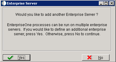

On the Would you like to add another Enterprise Server? dialog, click the Yes or No button.

The HTML Web Server is mandatory for the majority of JD Edwards EnterpriseOne applications because the end-user applications are only accessible through a web interface.To enter HTML Web Server information:
On HTML Server Revisions, complete these fields:
| Machine Usage | The default value of 30 indicates that this is a HTML Web Server. |
| Machine Name | Enter the name of your HTML Web Server. The name is case sensitive, should not exceed 15 characters, and should not contain any special characters. |
| Description | Enter a description of the HTML Web Server machine. |
| Release | Enter E910 to indicate the release number that you are installing. |
| Host Type | The default value of 50 specifies the server type as Intel NT. Select the correct server type. |
| Location | The location chosen for this plan appears in this field by default. |
| Primary User | The user to whom an email is sent when a package is deployed. The default for Primary User is listed in the JDE.INI. |
On the HTML tab, complete these fields:
| Primary HTML Server | When the system code generates an email message with a web shortcut pointing to a form, the web shortcut generated points to the "Primary" HTML Web Server. Only one of all the HTML Web Servers defined in installation planner can be defined as primary ("1"). |
| Protocol | This is the protocol used by the HTML Web Server. Valid values are http or https. |
| Server URL | This is the Domain Name System (DNS) host name of the HTML Web Server.
For example: www.oracle.com |
| HTTP Port | This is the port number the HTML Web Server is listening to.
For HTTP, the typical port number is 80. For HTTPS, the typical port number is 443. Note: You can choose to implement a HTML Web Server using a different port number. |
| JDENET Listen Port | This is the port on which the JDENET communications protocol communicates with the JD Edwards EnterpriseOne Enterprise Server. The value is dependent on the release of JD Edwards EnterpriseOne.
For JD Edwards EnterpriseOne Release 9.1, the value is 6016. |
| Default Login | Defines how shortcuts to a web form are generated by the system code. Values are either a reserved value or an explicit servlet name. Reserved values are:
| Installation Path | Enter the installation directory path to which you are installing Release 9.1 on your HTML Web Server. Make sure this is specific to your version of the release, and also the platform and application server on which your HTML Web Server is running.
For default paths, refer to the applicable platform- and application server-dependent version of the JD Edwards EnterpriseOne HTML Web Server Reference Guide (WebLogic for Windows or WebSphere for Windows or ). Otherwise, you must obtain this value from the HTML Web Server machine itself, or its administrator. |
| Deployment Server Name | Using the visual assist button, choose the name of the Deployment Server to which this HTML Web Server is attached. A Deployment Server name appears in this field by default, but you can change it if necessary. |
Click OK.
To add another HTML Web Server, click Yes and repeat steps 1 through 4 to define another HTML Web Server.

When you click OK at this point, the Plan begins to finalize; the below screen is displayed with progress indicated in the lower left-hand portion.
When the plan complete the finalization process, the following dialog is displayed:
When the plan is finalized:
The status is set to 20, signaling that several adjustments to OCM mappings and tables are made according to your plan.
The system creates the OCM mappings and the JDE.INI.
These tables are updated:
Release Master table (F00945).
Path Code Master table (F00942).
Package Plan table (F98404).
Machine Detail table (F9651).
Language table (F984031), if you are installing a language.
To finalize the Installation Plan:
On the Information Prompt that indicates Installation Planner has concluded, click OK to exit the message box and initiate the Planner Validation Report.
If the processing option default was selected, Planner Validation Report automatically prompts you to run this report.
If the processing option default was not selected, click Validate on the tree view of your plan to initiate the Planner Validation Report.

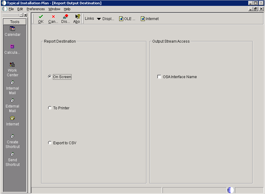

To conclude the planner validation report:
On Report Output Destination, select On Screen or To Printer.
Click OK.
Review the report to confirm that all records were validated.
For more information about Section 21.1, "Installation Planner Validation Report (R9840B)", refer to Chapter 21, "Working with Reports".
On Work With Installation Plans, click Expand to review the plan you created.
| Location Code | If this is the base location, this field will be grayed out. |
| Parent Location | For the base location, this field will be grayed out. |
Click OK.
Click OK to add a Deployment Server.
| Machine Usage | Displays the value 15 by default to indicate that this is a Deployment Server. |
| Machine Name | The name of the Deployment Server appears by default. The name is case sensitive, should not exceed 15 characters, and should not contain any special characters. |
| Release | Enter the release number you are installing or use the visual assist button to choose one from the list. The default value is E910. |
| Host Type | Displays the value 50 appears by default, indicating that the server type is Intel NT. |
| Location | Displays the current location. |
| Primary User | Displays the user to whom an email is sent when a package is deployed. The default value for Primary User is JDE. |
| Primary Deployment Server | Enter the hierarchy of the servers. Values are:
Click OK.

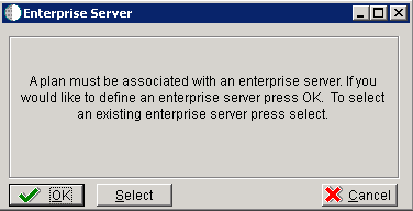

During the definition of the Enterprise Server, a port number must be defined. While Enterprise Servers running the same release can use the same port number, an Enterprise Server running two different versions of software must use two different port numbers.
On Enterprise Server, click the OK button to define a new Enterprise Server, or click the Select button to choose an existing Enterprise Server.
On Data Source, click OK to continue entering unique data source information, or click Take Defaults to select the default data. If you select the default data, you can skip to Section 5.5.8, "Entering HTML Web Server Information".
Click OK.
For Release 9.1, the current terminology and that used in this guide is to refer to the machine running the JD Edwards EnterpriseOne Java Application Server (JAS) as the HTML Web Server. Functionally, these terms are all synonymous. However, this guide only uses the terms JAS or Java Server when explicitly labeled as such by the software.Caution:
Click OK to define a new HTML Server, or click Select to choose from a list of existing HTML Servers.
If you choose Select, you are presented with the Machine Search table, from which you can make your selection.
The syntax is:
For example:
| Http Port | This is the port number the HTML Web Server is listening to.
For HTTP, the typical port number is 80. For HTTPS, the typical port number is 443. However, you can choose to implement a HTML Web Server using a different port number. |
| Installation Path | Enter the installation directory path to which you are installing Release 9.1 on your HTML Web Server.Make sure this is specific to your version of the release, and also the platform and application server on which your HTML Web Server is running.
For default paths, refer to the applicable platform- and application server-dependent version of the JD Edwards EnterpriseOne HTML Web Server Reference Guide (WebLogic for Windows, WebLogic for UNIX, WebSphere for Windows, WebSphere for UNIX, WebSphere for IBM i. Otherwise, you must obtain this value from the HTML Web Server machine itself, or its administrator. |
| Deployment Server Name | Using the visual assist button, choose the name of the DeploymentServer to which this HTML Web Server is attached. A DeploymentServer name appears in this field by default, but you can change it ifnecessary. |
Click OK.

On Data Server, choose one of these options:
OK
If your database resides on a separate server, choose click OK to continue entering unique Data Server information.
Select
Click this option to select an existing Data Server.
Skip
Click this option if you do not want to define a Data Server. Continue with the Planner using the environment selection in step 6 of this task.
On Data Server Revisions, complete these fields:
| Machine Usage | The default value of 25 indicates that this is a Database Server. |
| Machine Name | Enter the name of your Database Server. The name is case sensitive, should not exceed 15 characters, and should not contain any special characters. |
| Description | Enter a description of the Database Server machine. |
| Release | Enter the release number you are installing, for example, E910. |
| Host Type | Select the type of Database Server that you are adding to the plan. Values are:
| Location | The Installation Planner populates this field by default, based on previous selections. |
| Primary User | The user to whom an email is sent once a package is deployed. The default for Primary User is JDE. |
On the Data tab, complete the following field:
| Data Source Type | Choose the type of data source. For example:
Click OK.
To add another Data Server, click Yes and repeat steps 1 through 4 to define another Data Server.
On Data Source, click OK to entering and verify unique shared data source information as described in the next section of this guide entitled: Section 5.5.10, "Entering Shared Data Source Information".

To set up the data source for central objects:
On Data Source Revisions, verify the information for your central objects data source.
Click OK.
On Data Source Revisions, click the Advanced form option.
On Advanced Set-Up, because the central objects data source must be Unicode, verify the Unicode setting is checked.
For Oracle databases, ensure the LOB Data Type Support setting is checked.

To add a remote location:
On Location, choose one of the following options:
Click Yes to add a remote location.
Repeat all processes for adding a location starting with Section 5.5.4, "Entering Location Information". Refer to the Creating a Remote Installation Plan for information about adding remote locations to your plan.
Click No to conclude the Installation Plan setup.
Continue with Section 5.5.13, "Finalizing the Installation Plan" task.
When you click No on the Location dialog, the Planner begins to finalize the plan, as indicated by a status message in the lower left-hand portion of the screen:
Installation Planner displays a message to let you know that the installation plan has been finalized.
The status is set to 20, which signals that several adjustments to tables were made according to your plan.
The OCM is created.
The JDE.INI is modified.
The following tables are upgraded:
Language table (F984031), if you are installing an alternate language.
Click OK.
