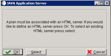

To set up the plan for the JD Edwards EnterpriseOne HTML Web Server, you must provide Installation Planner with the name of the HTML Web Server machine, its platform type, and other information. Installation Planner populates the F9650 and F9651 Enterprise Server tables.
When you run Installation Planner, these data sources are set up once and shared across all environments:

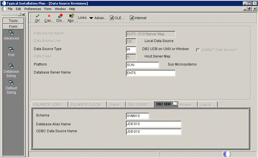

Server Map
Server Map data sources are specific to each Enterprise Server, so you must create one for each server.

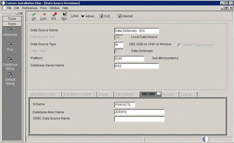

Data Dictionary
This is the data source for the Release 9.1 Data Dictionary tables. It is identified by the Release 9.1 release (for example, Data Dictionary - 910).

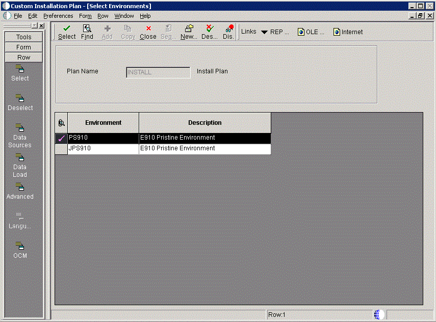

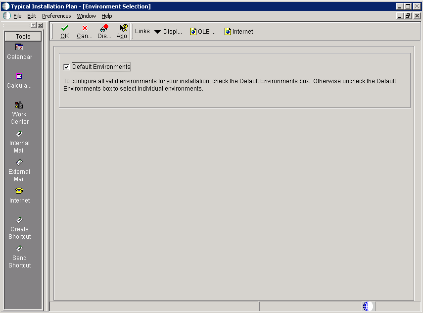

Installation Planner enables you to select default environments for your installation that are predefined, or you can choose to define them manually. Likewise, Installation Planner enables data load using default data load options, or you can choose to define them manually and override the default data load options.
The goal of the JD Edwards EnterpriseOne Release 9.1 Installation is to include the most current tools releases and updates at the time the installation image is mastered. However, subsequent to that time it is possible that critical fixes may become necessary and available. You should check Section 1.3.1, "Accessing Minimum Technical Requirements (Certifications)" to verify if any such JD Edwards EnterpriseOne Release 9.1 Installation fixes are required.

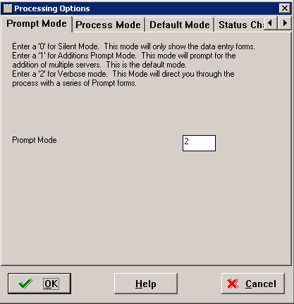

To specify the prompt mode:
Select the Prompt Mode tab.
On the Prompt Mode tab, select a prompt mode:
| Value | Model | Description |
| 0 | Silent | Installation Planner displays only the data entry forms. |
| 1 | Additions Prompt | Installation Planner prompts you to add servers. |
| 2 | Verbose | Installation Planner directs you through creating a plan with a series of prompting forms. |

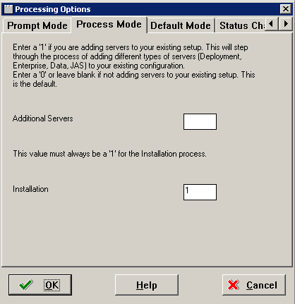

To specify the process mode:
Select the Process Mode tab.
On the Process Mode tab, select the options for the processes that you want to run when you create your plan:
Additional Servers
Enter 1 to add servers to your existing setup (Deployment Server, Enterprise Server, Database Server, HTML Web Server). Enter 0 or leave blank for regular plans.
Installation
Enter 1 to run the JD Edwards EnterpriseOne installation automatically.

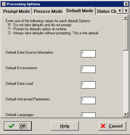

To specify the default mode:
Select the Default Mode tab.
On the Default Mode tab, enter these values into the processing option fields:
| Value | Description |
| 0 | Do not use default values and do not prompt. |
| 1 | Prompt for default options at run-time. |
| 2 | Default mode. Always use defaults without prompting. |

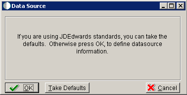

Default Data Source Information
Select whether you want the ability to modify data source information or just take the default values.
Default Environments
Select whether you want the ability to select environments or take the default values.
Default Data Load
Select whether you want the ability to modify data load parameters or take the default values.
Default Advanced Parameters
Select whether you want the ability to modify advanced parameters or take the default values.
Default Languages
Select whether you want the ability to select an alternate language or take the default values.

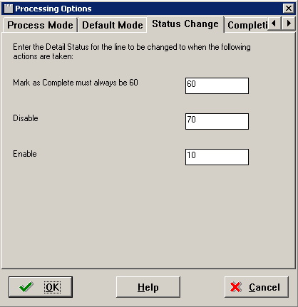

On the Status Change tab, this tab form appears.
Do not make any changes on this tab. These values are hard coded in the application

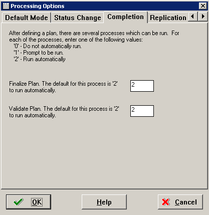

To specify plan completion processes:
Select the Completion tab.
On the Completion tab, complete the fields using these values:
After defining the plan, the options on this tab specify which processes are run. one of the following values:
| 0 | Do not run automatically. |
| 1 | Prompt to be run. |
| 2 | Run automatically. |

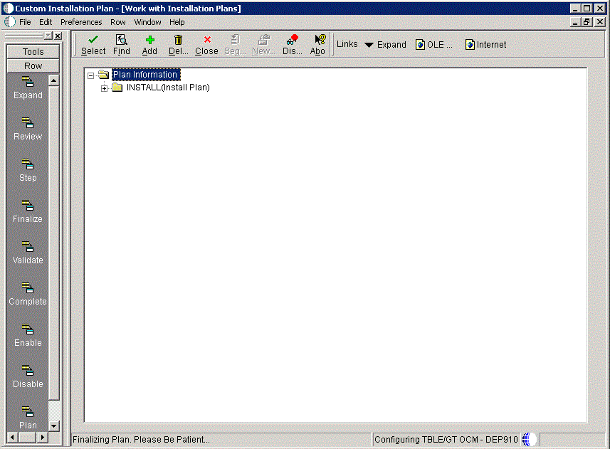

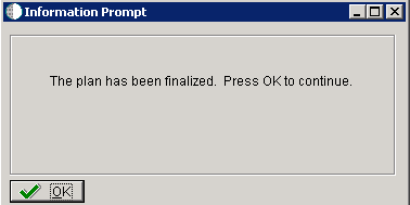

Finalize Plan
Enter the default option 2 to run automatically.
Validate Plan

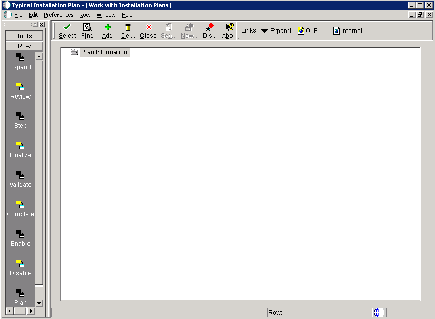

To start Installation Planner from within JD Edwards EnterpriseOne:
Access the System Installation Tools Menu (GH961).
On the System Installation Tools menu, double-click Typical Installation Plan.
On Work with Installation Plans, click Add.
The Installation Planner form appears.

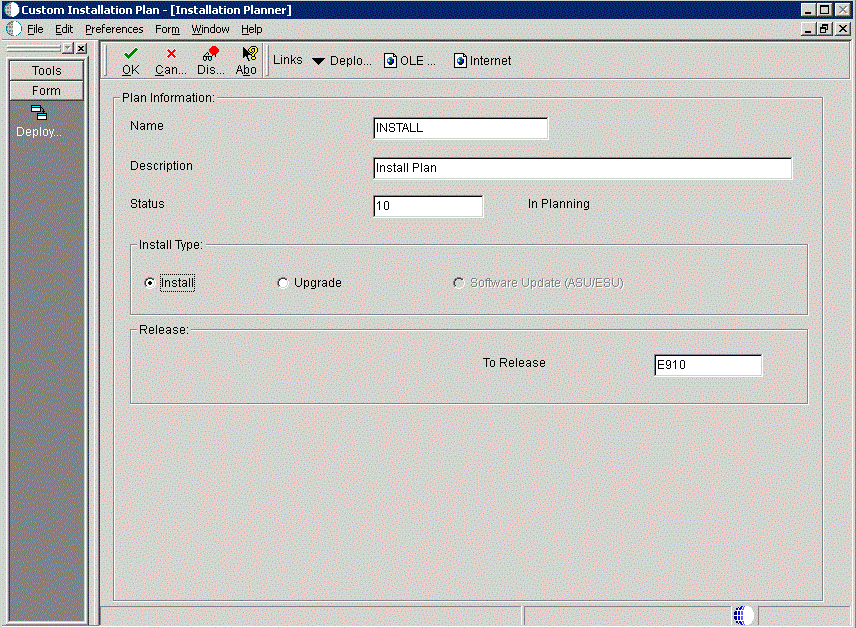

Enter a Plan description.
To enter a plan description:
On Installation Planner, complete these fields:
| Field | Description |
| Name | Enter the name of the installation plan. |
| Description | Enter the description of the installation plan. |
| Status | Choose 10 (the default value) as the status of the installation plan. |
| Install Type | Click the Install (the default value) radio button. |
| To Release | Verify that the release number is E910 (default value). |
Click OK to continue.

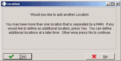

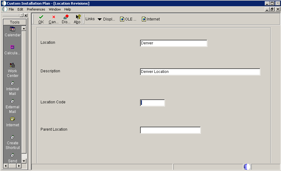

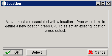

A location groups related Deployment Servers for use in a multi-tier environment.
To enter location information:
On Location Revisions, complete these fields:
| Location | Enter the location to which this plan applies; the location can be a city, company headquarters, or a division of the company. |
| Description | Enter a description for this location. |
| Location Code | If this is the base location, this field is only available when you are adding the base location. If you are editing an existing base location, the field is unavailable. |
| Parent Location | If this is the base location, this field is only available when you are adding the base location. If you are editing an existing base location, the field is unavailable. |
Click OK.

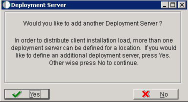

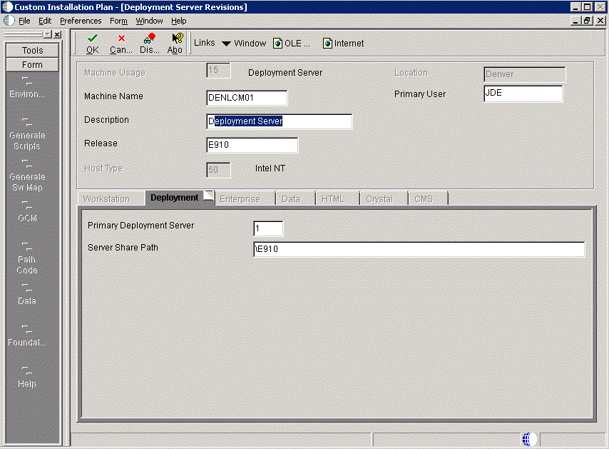

While Release 9.1 enables more than one Deployment Server to be defined, only the primary Deployment Server is defined at this time. You can choose a primary Deployment Server from the list of existing servers or you can enter information for a new server.
If you installed JD EnterpriseOne files to a remote Deployment Server, the deployment server name is the remote machine name by default.To enter Deployment Server information:
On Deployment Server Revisions, complete or verify these fields:
| Machine Usage | The value 15 appears by default, indicating that this is a Deployment Server. |
| Machine Name | The name of the Deployment Server appears by default. The name is case sensitive, should not exceed 15 characters, and should not contain any special characters. Remote Deployment Server. If you installed JD EnterpriseOne files to a remote Deployment Server, the deployment server name is the remote machine name by default. |
| Description | Enter a long description for the machine. This description should include the location with which this Deployment Server is associated and whether or not it is the primary server. |
| Release | Enter the JD Edwards EnterpriseOne release number you are installing or use the visual assist button to choose one from the list. The default value is E910. |
| Host Type | The value 50 appears by default, indicating that the server type is Intel NT. |
| Location | Your current location is the default value. |
| Primary User | The user to whom an email is sent when a package is deployed. The default value for Primary User is listed in the JDE.INI.This is also the UNIX user ID that is used to install Release 9.1 on the Enterprise Server. For example, jde910. |
On the Deployment tab, complete this field:
| Primary Deployment Server | The hierarchy of the servers. Valid values are: 1- Primary Deployment Server (default value) 0 - Secondary Deployment Server The server share name of the directory to which you installed Release 9.1 on your Deployment Server. Verify that the server share name for Release 9.1 is:
Click OK.
Tip:
If you enter invalid information into a field on a tab, a stop sign symbol appears next to the tab name, such as Workstation. Click the stop sign icon in the bottom right of the form to see more info about the error.

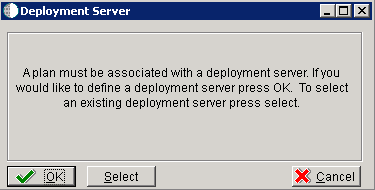

On Deployment Server, to add another Deployment Server, click Yes and repeat steps 1 through 3.
To continue with Installation Planner setup, click No.

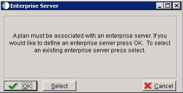

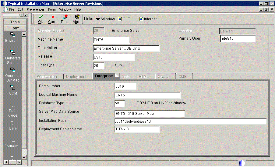

During the definition of the Enterprise Server, a port number must be defined. While Enterprise Servers running the same release can use the same port number, an Enterprise Server running two different versions of software must use two different port numbers.To enter Enterprise Server information:
On Enterprise Server Revisions, verify or complete these fields:
| Machine Name | The name of the primary Enterprise Server. The name is case sensitive and should not contain any special characters. Because the machine name is used to create the Server Map datasource name, and because the Platform Pack Installer does not restrict you from entering a machine name that results in a datasource name greater than 30 characters; if the machine name for the Enterprise Server is longer than 13 characters, the resulting datasource name will be longer than the allowed 30 characters. For example, if your machine name is 15 characters (A23456789012345), the base datasource name in the server  Note: The field in table F98611 is a hard restriction; the field only allows 30 characters. The actual field size cannot be modified or changed. When the Planner runs it truncates the value to 30 characters because that is the restriction in the F98611 table. The Platform Pack does not truncate the value when it builds the  To remedy, you could do any one of the following:

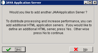

To add another HTML Web Server, click Yes and repeat steps 1 through 4 to define another HTML Web Server.

To verify the data source for Data Dictionary:
On Data Source Revisions, verify the accuracy of the settings for the Data Dictionary data source.
Click OK.

The Environment Selection screen is displayed.
To configure all valid environments for your installation, check the Default Environments box. Otherwise, uncheck the Default Environments box to select and verify individual environments.
Click OK.
Click the OK button to verify your environments.
Click OK.

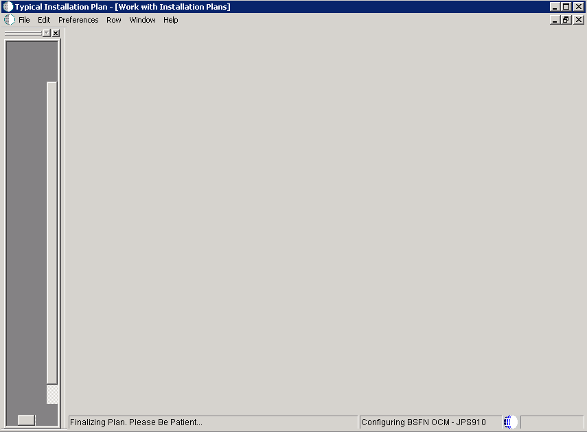

When you click OK at this point, the Plan begins to finalize; the below screen is displayed with progress indicated in the lower left-hand portion.
When the plan complete the finalization process, the following dialog is displayed:
When the plan is finalized:
The status is set to 20, signaling that several adjustments to OCM mappings and tables are made according to your plan.
The system creates the OCM mappings and the JDE.INI.

To finalize the Installation Plan:
On the Information Prompt that indicates Installation Planner has concluded, click OK to exit the message box and initiate the Planner Validation Report.
If the processing option default was selected, Planner Validation Report automatically prompts you to run this report.
If the processing option default was not selected, click Validate on the tree view of your plan to initiate the Planner Validation Report.

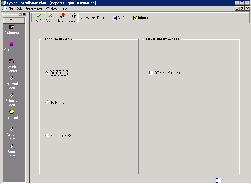

To conclude the planner validation report:
On Report Output Destination, select On Screen or To Printer.
Click OK.
Review the report to confirm that all records were validated.

On Work With Installation Plans, click Expand to review the plan you created.
On Installation Planner, complete the following fields:
| Name | Enter the name of the plan. |
| Description | Enter the description of the plan. |
| Status | Choose 10 (the default value). |
| Install Type | Click the Install (the default value). |
| To Release | Verify that the release number is E910 (the default value). |
| Include Languages | This is an optional selection that is only available if you have a language installation image installed on the Deployment Server. Select Yes if you are installing an alternate language. Note: If you prefer, you can install an alternate language after you complete your master plan. To do so, select the Language Only option on this form. For more information, refer to Chapter 18, "Creating a Language-Only Installation Plan" |
Click OK.
On the Location dialog, click OK.
| Location Code | If this is the base location, this field will be grayed out. |
| Parent Location | For the base location, this field will be grayed out. |
Click OK.
Click OK to add a Deployment Server.
| Machine Usage | Displays the value 15 by default to indicate that this is a Deployment Server. |
| Machine Name | The name of the Deployment Server appears by default. The name is case sensitive, should not exceed 15 characters, and should not contain any special characters. |
| Release | Enter the release number you are installing or use the visual assist button to choose one from the list. The default value is E910. |
| Host Type | Displays the value 50 appears by default, indicating that the server type is Intel NT. |
| Location | Displays the current location. |
| Primary User | Displays the user to whom an email is sent when a package is deployed. The default value for Primary User is jde910. This is also the UNIX user ID that is used to install Release 9.1 on the Enterprise Server. For example, jde910. |
| Primary Deployment Server | Enter the hierarchy of the servers. Values are: 1- Primary Deployment Server (default value) 0 - Secondary Deployment Server The server share name of the directory to which you installed Release 9.1 on your Deployment Server. Verify that the server share name for Release 9.1 is:
Click OK.

To add another Deployment Server, click Yes and repeat steps 1 through 3.
On Enterprise Server, click the OK button to define a new Enterprise Server, or click the Select button to choose an existing Enterprise Server.
| Machine Name | The name of the primary Enterprise Server. The name is case sensitive and should not contain any special characters. Because the machine name is used to create the Server Map datasource name, and because the Platform Pack Installer does not restrict you from entering a machine name that results in a datasource name greater than 30 characters; if the machine name for the Enterprise Server is longer than 13 characters, the resulting datasource name will be longer than the allowed 30 characters. For example, if your machine name is 15 characters (A23456789012345), the base datasource name in the server jde.ini will be:
 Note: The field in table F98611 is a hard restriction; the field only allows 30 characters. The actual field size cannot be modified or changed. When the Planner runs it truncates the value to 30 characters because that is the restriction in the F98611 table. The Platform Pack does not truncate the value when it builds the jde.ini for the Enterprise Server. Therefore, any value greater than 30 characters will result in a mismatch between the  To remedy, you could do any one of the following:
 In any case, you must ensure that the values for Server Map datasource names in the F98611 table exactly match those in the  This name is not case-sensitive in the Installation Planner. Therefore, regardless of underlying UNIX operating system considerations, you cannot name multiple Enterprise Servers with the same name but with different cases. For example, you cannot name multiple Enterprise Servers ORACLE and oracle. |
| Description | Enter a description for the machine. |
| Release | Enter the release number to which this plan applies, or use the visual assist button to choose one from the list. The default value is E910. |
| Host Type | Click the visual assist button and choose the type of Enterprise Server you are adding to the plan. In this case, a specific UNIX server as listed by the valid Host Type values:
| Location | The location chosen for this plan appears by default. |
| Primary User | The user to whom an email is sent when a package is deployed. The default value for Primary User is jde910. This is also the UNIX user ID that is used to install Release 9.1 on the Enterprise Server. For example, jde910. |
The case of machine name must also match the network ID for that machine.Caution:
If you are using clustering, use the name of theDB2 UDB Cluster Instance as the machine name when installing Release 9.1, not one of the servers' machine names. For additional considerations, refer to Release 9.1 on a Cluster in the JD Edwards EnterpriseOne Tools Server and Workstation Administration Guide and the clustering software documentation.Continuing on Enterprise Server Revisions, select the Enterprise tab, and complete or verify these fields:
| Port Number | The port number value (6016) for this Enterprise Server appears by default from the JDE.INI. |
| Logical Machine Name | The Installation Planner detects and provides a default value based on the current machine name on which the program is running. The name is case sensitive, should not exceed 15 characters, and should not contain any special characters. |
| Database Type | Enter the value for your database: W - DB2 UDB |
| Server Map Data Source | Whenever you enter a host type, the Installation Planner populates this field with a default value: machinename - 910 Server Map where machinename is the name of your machine. |
| Installation Path | Verify that the default value is the installation directory path to which you want to install Release 9.1 on the Enterprise Server. Make sure the value is specific to your version of the release. For example, for Release 9.1 the default path is:
 You might need to prepend the mount point to the path. For example:
 Caution: You must change the value that defaults into the Installation Path field as shown in the screen capture above. |
| Deployment Server Name | Using the visual assist button, choose the name of the Deployment Server to which this Enterprise Server is attached. A Deployment Server name appears in this field by default, but it can be changed if necessary. |
If you change the port number to a value other than 6016, you must also change this setting in both the Enterprise Server and workstation JDE.INIjde.ini.Click OK.
To enter information for the Server Map data source:
On Data Source, click OK to continue entering unique data source information, or click Take Defaults to select the default data. If you select the default data, you can skip to Section 5.5.8, "Entering HTML Web Server Information".
On Data Source Revisions, verify the accuracy of the Server Map data source.
Click OK.

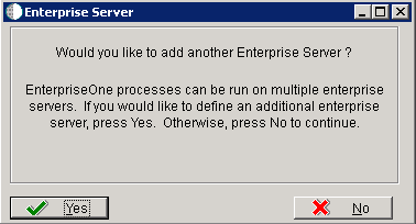

On the Would you like to add another Enterprise Server? dialog, click the Yes or No button.

The HTML Web Server is mandatory for the majority of JD Edwards EnterpriseOne applications because the end-user applications are only accessible through a web interface.To enter HTML Web Server information:
Click OK to define a new HTML Server, or click Select to choose from a list of existing HTML Servers.
If you choose Select, you are presented with the Machine Search table, from which you can make your selection.
On HTML Server Revisions, complete these fields:
| Machine Usage | The default value of 30 indicates that this is a HTML Web Server. |
| Machine Name | Enter the name of your HTML Web Server. The name is case sensitive, should not exceed 15 characters, and should not contain any special characters. This name is not case-sensitive in the Installation Planner. Therefore, regardless of underlying UNIX operating system considerations, you cannot name multiple HTML Web Servers with the same name but with different cases. For example, you cannot name multiple HTML Web Servers ORACLE and oracle. |
| Description | Enter a description of the HTML Web Server machine. |
| Release | Enter E910 to indicate the release number that you are installing. |
| Host Type | The default value of 50 specifies the server type as Intel NT. Select the correct server type. |
| Location | The location chosen for this plan appears in this field by default. |
| Primary User | The user to whom an email is sent when a package is deployed. The default for Primary User is listed in the JDE.INI.This is also the UNIX user ID that is used to install Release 9.1 on the Enterprise Server. For example, jde910. |
On the HTML tab, complete these fields:
| Primary HTML Server | When the system code generates an email message with a web shortcut pointing to a form, the web shortcut generated points to the "Primary" HTML Web Server. Only one of all the HTML Web Servers defined in installation planner can be defined as primary ("1"). |
| Protocol | This is the protocol used by the HTML Web Server. Valid values are http or https. |
| Server URL | This is the Domain Name System (DNS) host name of the HTML Web Server. The syntax is:
 For example:
| Http Port | This is the port number the HTML Web Server is listening to. For HTTP, the typical port number is 80. For HTTPS, the typical port number is 443. However, you can choose to implement a HTML Web Server using a different port number. |
| Default Login | Defines how shortcuts to a web form are generated by the system code. Values are either a reserved value or an explicit servlet name. Reserved values are:
| Installation Path | Enter the installation directory path to which you are installing Release 9.1 on your HTML Web Server.Make sure this is specific to your version of the release, and also the platform and application server on which your HTML Web Server is running. For default paths, refer to the applicable platform- and application server-dependent version of the JD Edwards EnterpriseOne HTML Web Server Reference Guide (WebLogic for Windows, WebLogic for UNIX, WebSphere for Windows, WebSphere for UNIX, WebSphere for IBM i. Otherwise, you must obtain this value from the HTML Web Server machine itself, or its administrator. |
| Deployment Server Name | Using the visual assist button, choose the name of the DeploymentServer to which this HTML Web Server is attached. A DeploymentServer name appears in this field by default, but you can change it ifnecessary. |
Click OK.
On Data Server, choose one of these options:
OK
If your database resides on a separate server, choose click OK to continue entering unique Data Server information.
Select
Click this option to select an existing Data Server.
Skip
Click this option if you do not want to define a Data Server. Continue with the Planner using the environment selection in step 6 of this task.
Click OK.

The Environment Selection screen appears.
This section discusses:
By default, Installation Planner configures your system using values for typical environments. Depending on the options chosen when you set up your plan, Release 9.1 displays one or more of the following parameters, which you can customize in the following tasks:
Environments
Data load options
You can customize any of these parameters by turning off the default option on the Environment Selection form. As you move through the plan, Installation Planner displays a customization form for each parameter that you clear.
To set up environments:
On Environment Selection, clear the options that you do not want to customize.
Different parameters appear depending on the options that you chose at the beginning of the planning process.Click OK.
If you selected the default option, which is to include all parameters, skip to Section 5.5.11.3, "Working with Environment Data Sources".Skip the tasks for those parameters that you did not clear. Otherwise, this section discusses these topics:
Adding a Custom Environment. Previous releases of JD Edwards EnterpriseOne allowed you to add a custom environment using P98410 to Add or Copy a custom Environment. Beginning with Release 9.0, you should instead use P989400 Environment Copy from GH961 > Advanced Operations. Refer to the section of this guide entitled: Chapter 13, "Copying an Environment to Another Environment".To select an environment:
On Select Environments, double-click the environment that you want to define. Selected environments are indicated with a green checkmark in the left-most column of the grid.
J xx environments are required for the HTML Web Server.To set up multiple environments, select and define them one at a time.
Click the Close button to exit the Select Environments screen.

Installer Planner prompts you to set up data sources for the environment you just configured.
To select an environment data source setup option:
On Data Source, click OK to manually enter the data sources and continue with the following task, or click Take Defaults to accept the Release 9.1 default data sources.

To add a remote location:
On Location, choose one of the following options:
Click Yes to add a remote location.
Repeat all processes for adding a location starting with Section 5.5.4, "Entering Location Information". Refer to the Creating a Remote Installation Plan for information about adding remote locations to your plan.
Click No to conclude the Installation Plan setup.
Continue with Section 5.5.13, "Finalizing the Installation Plan" task.
When you click No on the Location dialog, the Planner begins to finalize the plan, as indicated by a status message in the lower left-hand portion of the screen:
Installation Planner displays a message to let you know that the installation plan has been finalized.
The status is set to 20, which signals that several adjustments to tables were made according to your plan.
The OCM is created.
The JDE.INI is modified.
The following tables are upgraded:
Release Master table (F00945).
Path Code Master table (F00942).
Package Plan table (F98404).
Machine Detail table (F9651).
Language table (F984031), if you are installing an alternate language.
Click OK.
For more information about Section 21.1, "Installation Planner Validation Report (R9840B)", refer to Chapter 21, "Working with Reports".
