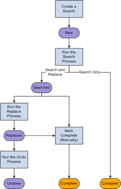

Click to jump to top of pageClick to jump to parent topicTerminology Search Statuses
As you proceed through the Search and Replace process, you will notice that all of the pages display a Status field. This status is updated automatically to reflect where you are in the process.
The default status for all new searches is New.
If you configure the search type to disable replacing (that is, if you choose the search-only option when you set up your search criteria), then no further action is possible after the search. Therefore, after the search, the status is updated to Complete. Otherwise, the status is updated to Searched.
Running the Replace process updates the status to Replaced; running the Undo process updates the status to Undone.
You can manually mark the status Complete after searching or replacing. Once the status is Complete, you cannot change your mind. If you decide to make further terminology changes, you must recreate the search criteria using the Copy Search Criteria feature on the Search Criteria Inquiry page.
The following diagram shows the relationship between these terminology search processes and statuses:
Terminology search processes and statuses

Click to jump to top of pageClick to jump to parent topicRunning the Search Process
After you define and save your search criteria (and select the Search Ready check box), you are ready to run a search.
To run a search:
  1. Select PeopleTools, Translations, Modify Terminology, Search.
  2. Search for an existing run control ID or add a new one.
    Use the standard search or add method to enter your run control ID and access the Search page.
  3. Verify that the appropriate search definitions will be processed.
    By default, the search includes all previously unprocessed search definitions (that is, definitions with the status New) where the Search Ready check box is selected. If a search appears here that you do not want to run, go back to the Search Profile page and clear the Search Ready check box. If a search is missing, go back to the Search Profile page and select the Search Ready check box.
    Click the View Search Criteria button to display a read-only version of the search criteria. This is useful when you want to confirm that you’re satisfied with the search criteria. Remember that running the search won’t affect your data, but it can still be inconvenient to run the wrong search, as you can’t go back and modify the search criteria.
  4. Click Run.
    The Process Scheduler Request page appears.
  5. Complete the Process Scheduler Request page.
    See Submitting and Scheduling Process Requests.
  6. Click OK.
    The search runs. When the Search process is complete, you can navigate to the Search Results/Replace page to see the results.

Click to jump to top of pageClick to jump to parent topicRunning the Replace Process
After you have finalized your replacement text and settings in the Search Results/Replace page, you must run a Replace process to actually make the replacements. Running the Replace process updates the search status from Searched to Replaced.
After you run the Replace process, you have one last chance to back out any changes made by the process.
See Replacing Message Text.
Warning! Once you change the search status and update the search status, you can no longer view this search in the Search Result/Update pages. Be sure that you are finished with both pages, that is, you have finished manually editing your messages, before you change the status.
To run the Replace process:
  1. Select PeopleTools, Translations, Modify Terminology, Replace.
    Use the standard search or add method to enter your run control ID and access the Replace page.
    By default, the Replace includes all search definitions that have the status Searched and have the Replace Ready check box selected. If a search appears here that you do not want to run, go back to the Search Results/Replace page and clear the Replace Ready check box. If a search is missing, go back to the Search Results/Replace page and select the Replace Ready check box.
    Click the View Search Criteria button to display a read-only version of the search criteria. This is useful when you want to confirm which set of criteria you’re processing.
  4. Click the Run button.
  6. Click OK.
    The Replace process runs. Once the replace is complete, you can navigate to the Replace Results/Undo page to view the results.

Click to jump to top of pageClick to jump to parent topicRunning the Undo Process
To run the Undo process:
  1. Select PeopleTools, Translations, Modify Terminology, Undo.
    Use the standard search or add method to enter your run control ID and access the Undo page.
    By default, the undo includes all search definitions that have the status Replaced and the Undo Ready check box selected. If a search appears here that you do not want to run, go back to the Replace Results/Undo page and clear the Undo Ready check box. If a search is missing, go back to the Replace Results/Undo page and select the Undo Ready check box.
  6. Click OK.
    The Undo process runs. Once the undo is complete, navigate to the All Search Results page to view the results.

Click to jump to top of pageClick to jump to parent topicReviewing Search Criteria
To see the search criteria for any search that’s been defined, select PeopleTools, Translations, Modify Terminology, Review Search Criteria.
This page is a display-only version of the Search Profile page.
To transfer to the page that is appropriate to the current status of the search, click the View Details button. For example, if the status is Searched, then to continue the Search, Replace and Undo process, you must go to the Search Results/Replace pages. The following table explains which component you see, based on the status of the search:
Status
Component
Navigation
New
Define Search Criteria
PeopleTools, Translations, Modify Terminology, Define Search Criteria
Searched
PeopleTools, Translations, Modify Terminology, Search Results/Replace
Replaced/Undone
PeopleTools, Translations, Modify Terminology, Replace Results/Undo Replace
Complete/Undone/Replaced
All Search Results
PeopleTools, Translations, Modify Terminology, Review Search Results
Search Only Results
PeopleTools, Translations, Modify Terminology, Review Search Only Results
Click the Copy Search Criteria button to clone this search definition.
