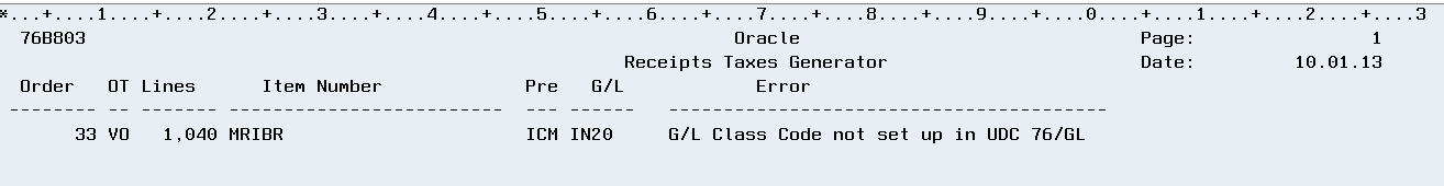

If tax lines are not generated, you must review Receipts Taxes Generator report (R76B803) and correct the errors.
Figure 32-1 Receipts Tax Generator Report
Description of Figure 32-1 follows
Description of "Figure 32-1 Receipts Tax Generator Report"
