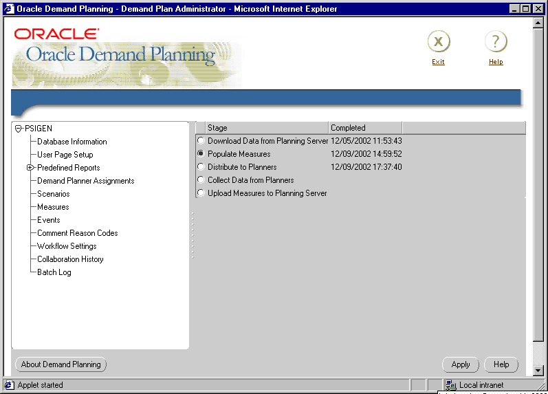

The Demand Planning Administrator page is the interface for running the stages of the planning cycle.
Log into Oracle Demand Planning.
Select the Demand Planning System Administrator responsibility,
In the Navigator, choose Demand Plan Administration. A list of demand plans appears.
Select the demand plan that you want to work with, scroll to the bottom of the page, and choose Start Demand Planning. The Demand Planning Administrator page for the plan opens.
Example 4 Demand Planning Administrator Page
The Demand Planning Administrator page shows the demand plan you have selected.
To view information that is specific to the current page, choose the Help button at the bottom of the page.
To access the full Oracle Demand Planning online Help system for Demand Plan Administration, choose the large Help (?) button at the top of the page.
You can use your browser's print function to print Help topics.
To close an open Help window, choose the Exit (X) button at the top of the page. You will be returned to the current function.
To access version and system information, choose About Demand Planning at the bottom left of the page.

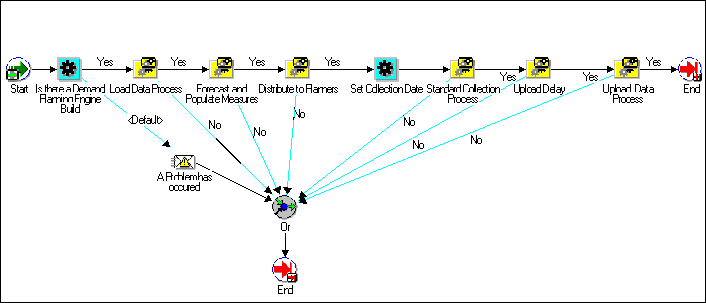

If you use a concurrent request program to automate the stages in the planning cycle, you need only run the Download Data from Planning Server stage for the initial planning cycle. Thereafter, it will automatically run a full download. For details about automating the planning cycle, see: Automating the Planning Cycle.

Access the Demand Planning Administrator page.
In the navigation list, choose the demand plan name. A list of the stages in the planning cycle appears in the right frame.
In the Stage column, choose Populate Measures.
Choose Apply. The task is submitted to Oracle Workflow. The Status column indicates when the stage is complete. For details about the associated Workflow process, see: Workflow Processes Within the Demand Planning Cycle.

If you use a concurrent request program to automate the stages in the planning cycle, you need only run the Distribute to Planners stage for the initial planning cycle. Thereafter, it will automatically run a full distribution. For details about automating the stages of the planning cycle, see:Automating the Planning Cycle.

For details about how Workflow accomplishes these processes, see: Workflow Processes Within the Demand Planning Cycle

If you use a concurrent request program to automate the stages in the planning cycle, you need only run the Collect Data from Planners stage for the initial planning cycle. Thereafter, it will run automatically. For details about automating the planning cycle, see: Automating the Planning Cycle.

In the navigation list, choose the demand plan name. A list of stages appears in the right frame.
In the Stage column, choose Upload Measures to Planning Server.
Note: You can use the Batch Log to view processing details.

If your site has a predictable planning cycle, you might want to consider automating batch processing. This is particularly useful for businesses that have a consistent demand planning cycles where the cycles repeat after fixed intervals and a new rolling forecast is created every cycle.
A concurrent program, predefined as a request in the Demand Planning Server, enables you to automate processing through a program that runs a master Workflow process. Note that midcycle collections can also be performed as needed.
You can schedule the first three planning cycle activities (Download Data from the Planning Server, Populate Measures, Distribute Data to Planners) as a sequence to occur periodically at specific times. The workflow process waits there for a user specified interval before running the Collect Data from Planners stage.
You can also specify the number of days to wait before running the Upload to Planning Server stage. This gives the Demand Plan Manager a preset time period in which to review forecasts that have been submitted to the shared database. When this time period has elapsed, Workflow uploads the data to the Demand Planning Server.
Note that the automated program runs a full distribution and a full download. If you want to run quick downloads and quick distributions, you can do so between cycles.
Note: Before automating batch processing, ensure that you manually run all batches at least one time. The initial run of each batch sets the default parameters for the concurrent program.
Example 5 Automating the planning cycle
For example, you could specify the master workflow program to run every 30 days with wait period of 5 days. In this case, the following would occur:
Day 1: Run processes 1, 2, and 3 in sequence, where process 2 is run after process 1 is complete.
Wait for 5 days.
Day 6: This is the deadline for demand planners to submit the final forecast numbers. Run process 4 to collect from demand planners.
Wait for five days while the Demand Plan Manager reviews planners' data. Then in sequence, run process 5.
Day 31: Run process 1, 2, and 3.

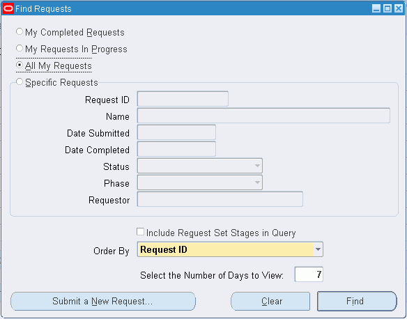

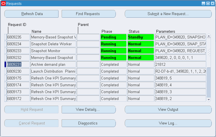

Log into Oracle Demand Planning with the Demand Planning System Administrator responsibility.
In the Navigator, select Other > Requests.
In the Find Requests window, select Submit a New Request.
Select Run a Single Request.
In the Name list of values field, select Demand Planning Engine Master Workflow Process.
In the Parameters window, provide the following parameters for the request:
Demand Plan Name: the name that was assigned when the plan was built.
Number of days to run the collection period: the number of days following the run of the Collect Data from Planners batch that data will be consolidated in the shared database.
Number of days to delay upload: the number of days following the run of the Collect Data From Planners batch that the data will be uploaded to the Demand Planning Server.
Choose Submit to run the request.

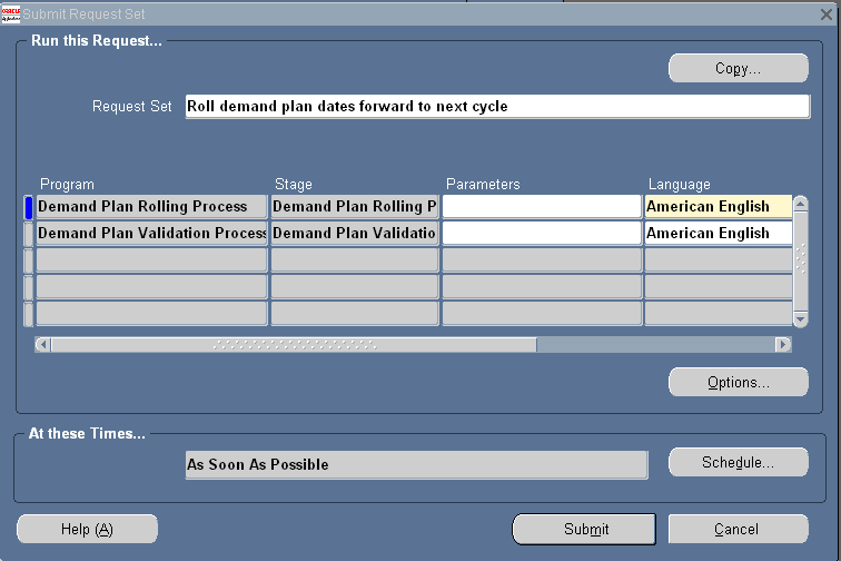

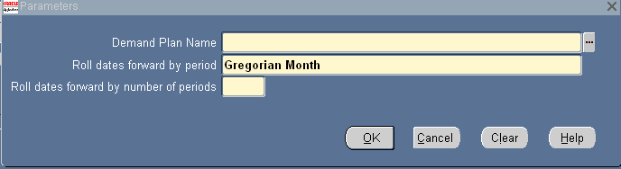

User can use the existing demand plan definition to start the next forecast cycle by rolling the demand plan dates forward to next cycle. Once the request set is launched with the appropriate parameters, the Roll demand plan dates forward concurrent program implements the required changes in the original plan definition, and the Validate Rolled Demand Plan concurrent program validates the demand plan definition.
Select Request Set in the Submit a New Request window.
In the Submit Request Set window, select the LOV in the Request Set field. Roll demand plan dates forward to next cycle populates into the field.
Click in the Parameters field of the Demand Plan Rolling Process program.
Complete the following fields:
| Name | Description |
| Demand Plan Name | Select at least one demand plan from the LOV of valid demand plans. |
| Roll dates forward by period | select either Day (default) or Gregorian Month. The demand plan dates are rolled forward based on the type of period (bucket) selected here. |
| Roll dates forward by number of periods | Enter a number from 1 to 999. The start and end dates for input parameters, scenario history period, and scenario horizon are rolled forward by the specified number of periods. For example, if 31 days are specified, 1-Jan-2002 will become 1-Feb-2002 and 1-Feb-2002 will become 4-Mar-2002. If 1 month is specified, 1-Feb-2002 will become 1-Mar 2002. |
Select OK. Now the Roll demand plan dates forward to the next cycle concurrent program rolls the dates forward.
For details on how the dates are rolled when the Exclude from Rolling Cycle check box is not checked, see: Input Parameters.
Note: You must validate the demand plan after the dates have changed. The Roll demand plan dates forward to the next cycle program errors out if the dates rolled forward are not valid dates for the calendars included in the demand plan.

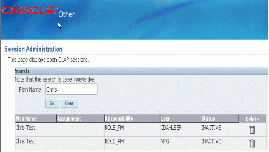

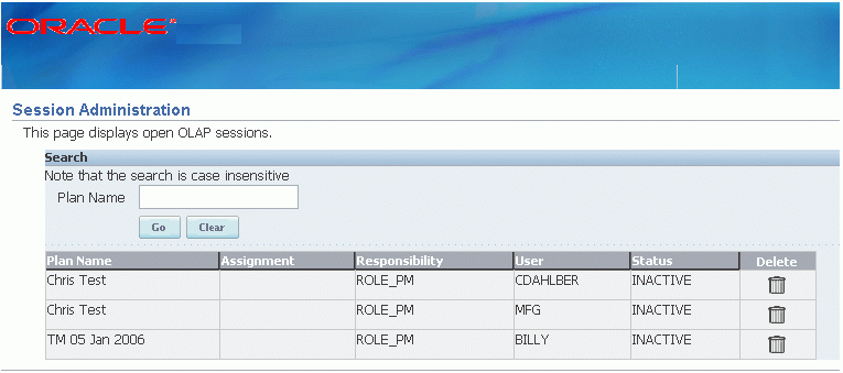

While working with Demand Planning, you can check the status of the current OLAP sessions. In particular, you can:
View all OLAP sessions
View OLAP sessions for a specific plan
Terminate an inactive OLAP session without waiting for the session to timeout
To View All OLAP Sessions
Choose Demand Planning System Administrator responsibility.
To open the Session Administration window listing all open OLAP sessions, select Other > Session Administration.
The following information is provided for each OLAP session:
| Field | Description |
| Plan Name | The name of the open plan. |
| Assignment | The planner's assignment. |
| Responsibility | The user's demand planning responsibility. |
| User | The name of the plan owner. |
| Status | The status of the plan. Valid values are:
| Delete | The delete button terminates the OLAP session. |
To View OLAP Sessions for a Specific Plan
Select Other > Session Administration.
The Session Administration window listing all open OLAP sessions appears.
Enter the plan name.
The Session Administration window shows only OLAP sessions for the specified plan.
To Terminate an OLAP Session
Click the delete button for any hung or inactive OLAP session.
A confirmation message is displayed.
Choose Yes to terminate the session. Choose No to not delete the OLAP session.

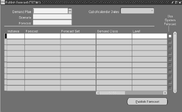

Once the forecast data reaches the Demand Planning Server, it may be published back to the source Oracle Applications transaction system, where then it can optionally be loaded into a Master Demand Schedule for the purpose of consuming it against available sales orders. Publishing of forecasts back to the source is optional. For details, see: Defining a Demand Plan.
Choose the Demand Planning System Administrator responsibility.
To open the Publish Forecast window, select Collections > Publish Forecast in the Navigator.
Complete the following fields in the Publish Forecast window:
Only one scenario with one demand plan can be published at a time.
Note: If the demand class, customer or location fields are populated, only the elements from the scenario with demand class, customer and location dimension values matching the populated values will be published into the designated forecast.
Optimization by selecting the scenario name in the inventory plan. For details, see: Oracle Inventory Optimization User's Guide.

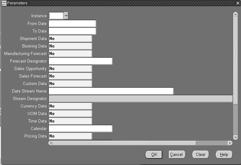

You can bring, analyze, and forecast your customers' sales history as well as forecasts from Oracle Collaborative Planning into Oracle Demand Planning. Customer's sales history can then be used to create customer's sales forecast in Oracle Demand Planning. This customer's sales forecast or the one directly collected from Oracle Collaborative Planning serves as an input to the consensus forecasting process within Oracle Demand Planning. The demand planning forecast can then be fed to Oracle Advanced Supply Chain Planning to drive supply planning or into Oracle Collaborative Planning to drive VMI replenishments.
You need to have your customers, customer sites, external inventory organizations, VMI items and replenishment controls, and blanket sales orders already defined in your ERP system.
Collect customer's sales history or forecast from Oracle Collaborative Planning into Oracle Demand Planning.
If Oracle Collaborative Planning is not implemented, customers' sales history or forecast can be loaded into Oracle Demand Planning via flat files.

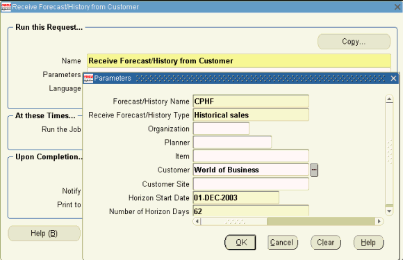

Choose the Advanced Planning Administrator responsibility.
Select Collaboration > Receive Forecast/History from Customer.
Click on Parameters field and specify the following:
Forecast/History Name: name for the data that will be collected.
Receive Forecast/History Type: select Historical sales to collect customer's sales history. Select Sales Forecast or Order Forecast to collect customer's forecast.
Organization, planner, item, customer, and customer site (available if customer is selected): optional filters to restrict information.
By default all the available data is collected for all organization, planner, item, customer, and customer site.
Horizon start date: the date from which you want to bring in the history.
Number of Horizon Days: number of days from which you want to bring in the history beginning from horizon start date.

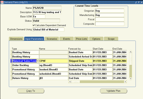

Select Demand Plans.
Select Input Parameters.
In Type of input parameter, select Historical Sales from Customers, or Sales Forecast from Customers, or Order Forecast from Customers to bring customer's sales history, sales forecast, or order forecast, respectively.
For details, see: Input Parameters. For creating a forecast based on the customer's sales history or for analyzing the customer's data in worksheets and reports, see: Using Sales Forecasts and Opportunities.

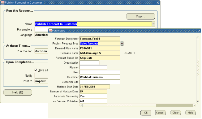

Choose Advanced Planning Administrator responsibility.
Select Collaboration > Publish Forecast to Customer.
Click on Parameters field and specify the following parameters:
Forecast designator: name for the forecast data.
Publish Forecast Type: select Sales forecast.
Demand Plan Name: name of the demand plan.
Scenario Name: forecast scenario name for the selected demand plan.
Organization, planner, item, customer, and customer site (available if customer is selected): optional filters to restrict the history information.
Horizon Start Date: the date from which you want to bring in the history.
Automatic Versioning: select Yes to maintain multiple forecast versions in Oracle Collaborative Planning.
Select Demand Planning System Administrator responsibility.
Complete all the stages (1-5) of Oracle Demand Planning.
Download Data from Planning Server (Stage 1)
Populate Measures (Stage 2)
Distribute to Planners (Stage 3)
Collect Data from Planners (Stage 4)
Upload Measures to Planning Server (Stage 5)
In the Navigator, select Collections > Publish Forecast.
Enter details into the Publish Forecast window and select Publish Forecast.

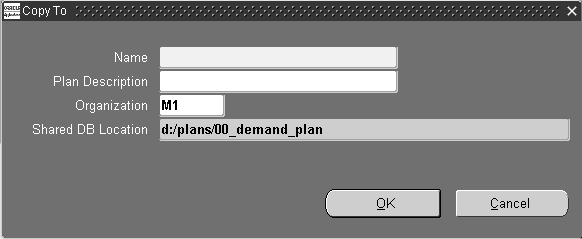

In the Navigator, select Demand Plans.
Select the name of the demand plan to be copied. The Demand Plans window for the demand plan you selected appears.
Select Copy To from the Demand Plans window to open the Copy To window.
Enter a name for the new demand plan. All data fields are copied automatically from the demand plan you selected.
Select OK.
Following are modifications that would make a demand plan suitable for a subsequent cycle. You make these modifications in the Demand Plan window:
In the Input Parameters tab, roll the end and possibly start dates of booking and shipping histories forward by one forecasting period.
In the Scenarios tab, roll the history start, history end, horizon start and horizon end dates for all scenarios forward by one forecasting period.
A scenario is a statement of forecast horizon and basis. The basis consists of the bookings and shipments. The statistical forecast so generated gets the name of the respective scenario. The capability for scenarios to be persistent allows the forecasts to be usable from one planning cycle to another despite the changes in the underlying data between the cycles.

To open the Parameters window on top of the Purge Fact Data window, select Other > Purge Fact Data in the Navigator.
Complete the following Parameters:
In the Instance field, select the instance from which you want to delete the data.
Specify the From Date and To Date using the format DD-MON-YYYY.
You need to specify the purge data range in such a way that it covers the entire time period for booked dates as well as requested date.
For the rest of the fields, select either Yes or No. Please note that for Manufacturing Forecast, Time Data, and Pricing Data, if you select Yes, you can supply a subqualifier which are Forecast Designator, Calendar, and Price List, respectively. If you do not supply a subqualifier, all the data is deleted.
If you select Yes for Custom Data, you can supply two subqualifiers: data stream name and stream designator.
If you select Yes for Scenario Entries, you can supply three subqualifiers: Demand Plan, Scenario, and Revision in this order. This means that Scenario qualifies a Demand Plan with multiple Scenarios for a Demand Plan, and the Revision qualifies a Scenario with multiple Forecast revisions for a Scenario. If you do not supply a subqualifier at any level, all the data is deleted. For example, if you select Yes for Scenario Entries, but do not specify a Demand Plan, all the scenarios entries (forecasts) for all the demand plans will be purged. Since scenarios are instance independent, scenarios for all the other instances will also be deleted in addition to the scenarios of the specified instance.
Scenarios are instance independent. Thus, deleting scenario is not instance specific. If you delete a scenario or all scenarios when a specific instance has been specified, data for all the instances will be deleted.
Select OK.

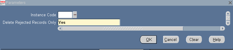

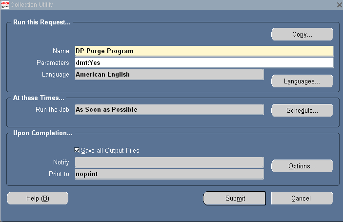

In the Navigator, select Collections > Purge Interface Tables to open the Parameters window.
Note: The interface tables are synonymous with staging tables.
Complete the following:
Select the Instance Code from the LOV. This is the instance where the data is to be purged.
Indicate Yes or No for Delete Rejected Records Only.
Select OK to open the Collection Utility window.
Submit the concurrent request for Oracle Demand Planning Purge Program.

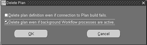

In the Find Demand Plan window, choose the demand plan to be purged.
From the Edit menu toolbar, select Delete.
A warning message appears.
Select Yes to open the Delete Plan window.
The Delete plan even if background Workflow processes are active checkbox causes Oracle Demand Planning to delete the demand plan definition and the associated analytic workspace data, even if the Oracle Demand Planning forecasting cycle is currently in process and uploading the consensus forecast to the Demand Planning Server has not yet occurred. Do not check this box if, in this situation, you want the demand plan purge process to exit without deleting any demand plan data whatsoever.
If you have built a cube for the plan definition, then the plan definition will only be deleted if the cube is purged successfully. If you have not built a cube for the plan definition, then the plan definition will be deleted.
Select OK.
This launches a concurrent request to purge the demand plan and the associated analytic workspace data (including output scenario data).

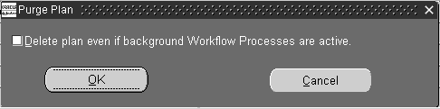

From the Tools menu toolbar, select Purge Plan to open the Purge Plan window.
If you select Delete plan even if background Workflow processes are active, Oracle Demand Planning deletes the associated data in the analytic workspace even if the Oracle Demand Planning forecasting cycle is currently in process and uploading the consensus forecast to the Demand Planning Server has not yet occurred. Uncheck this check box if in this situation you would like the demand plan purge process to exit without deleting any demand plan data.
Select OK.
This launches a concurrent request to purge the analytic workspace data associated with the demand plan, but leaves the demand plan definition and associated output scenario data intact.

Choose All My Requests and click Find to open the Requests window, which lists the status of all the concurrent requests.
The status of the archive demand plan is shown.
Note: The demand plan ID is listed in the parameters field, not the demand plan name.

Choose All My Requests and click Find. The Requests window appear, which lists the status of all the concurrent requests.
The status of the recovered demand plan is shown.
