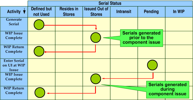

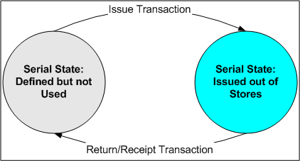

When items are serial tagged, their serial states will alternate between Defined but not Used and Issued Out of Stores. When an issue transaction occurs for a serial tagged item, its status changes to Issued Out of Stores, whereas the corresponding return/receipt transactions changes the status back to Defined but not Used. Therefore, while the serial remains in inventory, the status of the serial stays as Defined but not Used.
The following diagram demonstrates how the serial state changes from Defined but Not Used to Issued Out of Stores when an issue or return/receipt transaction is performed.
The following diagram shows the changes in serial status for serial numbers generated prior to component issue and those generated during component issue. For each activity listed beneath the Activity column, you can identify its corresponding serial status (and flow) by the small circle listed under the Serial Status row; for example, for the activity of Generate Serial the corresponding status is Defined but not Used (the corresponding flow is indicated by the directional arrow):

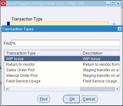

Navigate to the Serial Tagging Assignments window.
Select the transaction type to identify when serial number tagging occurs for the selected item:
WIP Issue
When WIP issue is serial tagged for an item, during WIP issue, the system will prompt you to enter serial numbers and the same numbers will be recorded in the serial history. If returning the material back to inventory (with reference to the original issue transactions), the original serial numbers need to be returned as well.
Return to Vendor
Enables you to tag serial numbers only at the time of returning the goods to supplier and not at receipt.
Sales Order Pick: Enables serial tagging for a staging transfer on a sales order.
Internal Order Pick: Enables serial tagging for a staging transfer on an internal order.
Field Service Usage
Enables you to set the serial tagging at field service issue for the items with serial control.
Click Save to save the serial tagging assignment(s).

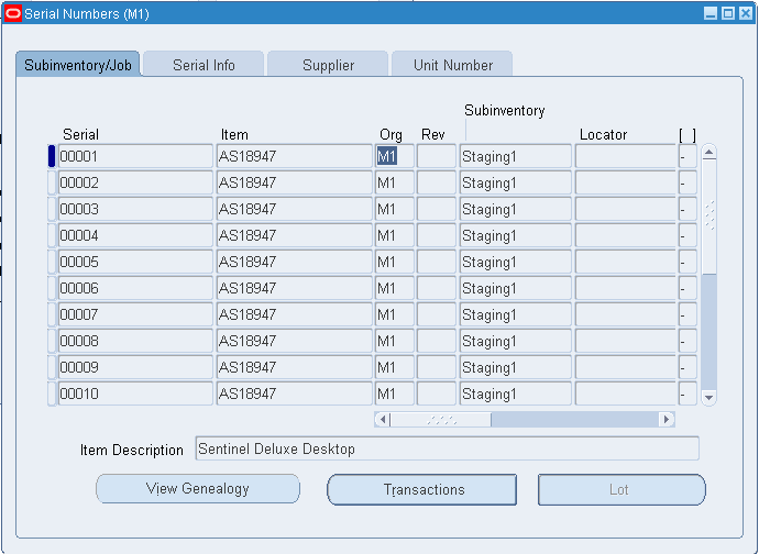

You can view location, job, and serial state information, as well as update supplier information that is associated with your serialized units. You can also query by serial numbers to find serial tagged items.
To display serial number information
Navigate to the Serial Numbers window. The Find Serials window appears.
Enter your search criteria. If no search criteria is entered, then the system queries for all serial numbers.
Important: To view serial numbers across organizations, deselect the Organization column.
Click Find to display the serial number and item information in the Serial Numbers window.
To view location and job information
Click the Subinventory / Job tab.
This region contains the serial number, item number, current organization, revision, subinventory, locator, job, current operation, current step, and lot. You cannot edit these fields.
Important: The Job field displays only open jobs that are currently in the process of building the serial unit.
To view the serial information
Click the Serial Info tab.
This region contains the serial state, status, receipt date, ship state, and associated attributes.
The inventory state of the serialized unit can be: defined but not used, resides in stores, issued out of stores, or resides in intransit.
Modify the status if needed. The available choices are:
Active
QC Hold
Quarantine
To update supplier information
Click the Supplier tab.
Enter the supplier name, lot number, and serial number information.
Save your work.

When issuing serialized components to serial controlled assemblies, you must associate the component serial number with the assembly serial number. See Issuing and Returning Specific Components, Oracle Work in Process User's Guide.
Note: If the component has a supply type of Push, the association occurs at WIP Issue. If the component has a supply type of Operation Pull, the association occurs at WIP Move. If the component has a supply type of Assembly Pull, the association occurs at WIP Completion.

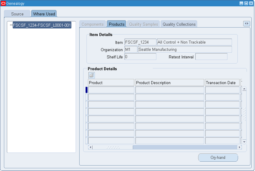

Click Genealogy to display the genealogy.
The Genealogy window appears. The genealogy appears in a graphical display, allowing you to trace the serial history. The left pane is in a tree format containing two tabs for different views:
Source displays the source of the record that you are viewing. It is designated by assembly name, appended by the job name, at the top node of the tree. For example, you may be producing a specific job from components of a particular serial. Material used in this assembly-job combination is expanded under the top node.
Where Used displays the assembly where this material is used. It is designated by assembly name, appended by the job name, at the top node of the tree. The assembly and job combinations using this top record are expanded below it.
If the item is lot and serial controlled, then the system displays the lot and the associated serial number in the tree. The Item Details alternative region contains information about the item, such as the item number and organization where the item resides. The Serial Details alternative region contains information about the particular serial number such as the serial state, serial material status, current lot if the serial is under lot control, and WIP job information if the serial is part of a WIP job.
Click the Lot Attributes tab if the serial is under lot control. The Item Details alternative region displays details about the item, and the Lot alternative region displays information about the lot. It provides you with the lot number, and other associated lot information such as the lot grade and lot material status. The Origination alternative region provides you with information about where the lot was created, and the type of transaction you used to receive it in to inventory. It also provides you with the document type used to receive it in to inventory.
Click the Work Order details tab if the serial is associated with a WIP job. If the serial is not associated with a WIP job, then you cannot click the tab. The Work Order details alternative region displays information about the job, such as the job status and when it was released and completed. It also contains the job quantity, the scrapped quantity, and the remaining quantity to complete. The Product Details alternative region contains information about the product, such as the product name, description, and quantity planned for the job.

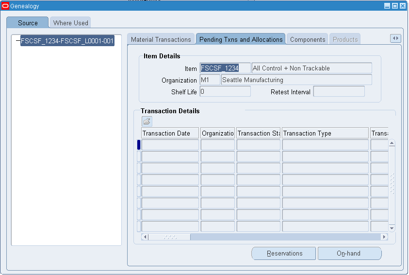

Click the Material Transactions tab to view the material transactions that are associated with the serial. The Item Details alternative region displays information about the item. The Transaction Details alternative region displays item transactional information, such as the transaction date, subinventory, and transaction type.
Click the Pending Transactions tab to view pending transactions for the serial. Pending transactions are actions that you performed on the serial, but are not completed by the transaction manager. The Item Details alternative region displays information about the item. The Transaction Details alternative region displays item transactional information, such as the transaction date, subinventory, and transaction type.

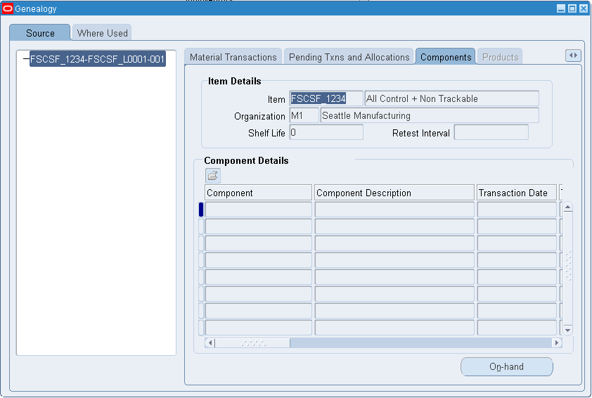

Click the Components tab to see the components used in the item production with their associated quantities. You can click this tab only if you view by Source. You can also restrict the Components tab to honor formula security. You can restrict formula security by user or responsibility. Three levels of security are available: Update, View-Only, and Hidden. When a user tries to access the genealogy of serial to which he or she does not have formula access, the system displays a warning message.
The Item Details alternative region displays information about the item, such as the item number and organization where the item resides. The Component Details alternative region contains detailed component information, such as the associated job or batch if applicable, and the component item number and description.
Click the Products tab to view the products manufactured with this serial as an ingredient. You can click this tab only if you view by Where Used. The Item Details alternative region contains information about the item, such as the item description and the current organization where it resides. The Product Details alternative region displays details about the product manufactured with this serial as an ingredient, such as the product name and description.

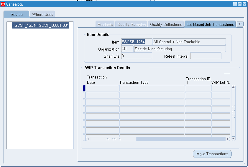

If you have Oracle Shop Floor Management installed, you can see the Lot Based Job Transactions tab. The Lot Based Job Transactions tab displays the Oracle Shop Floor Management transactions, such as splitting, merging, bonus lots, and updating assemblies. It displays the previous values for WIP Lot Name, Start Quantity, and Assembly Number, and the resulting values after the transaction.
