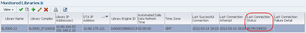

The data collection may take anywhere from several minutes to over an hour, depending on the size and current activity level of the library. The Last Connection status field in the Monitored Libraries table indicates “IN PROGRESS” while the process is underway.
