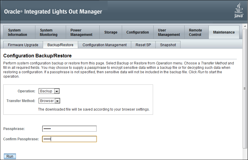

Oracle Integrated Lights Out Manager (ILOM) supports remote administration of the Oracle Big Data Appliance servers. This section explains how to back up and restore the Oracle ILOM configuration settings, which are set by the Oracle Big Data Appliance Mammoth Utility
See Also:
Oracle Integrated Lights Out Manager 3.0 documentation atThe following procedure describes how to back up the Oracle ILOM configuration settings.
Open your browser on any system on the same network as Oracle Big Data Appliance and enter the ILOM address of a server. This example uses the ILOM address of server 08:
http://bda1node08-c.example.com
Log in as the ilom-admin
user. The default password is welcome1
Select the Maintenance tab.
Select the Backup/Restore subtab.
Select the Backup operation and the Browser transfer method, as shown in Figure 14-1.
Enter a pass phrase. The phrase is used to encrypt sensitive information, such as passwords, in the backup.
Click Run to start the backup. The results are downloaded to your local system in an XML file named config_backup.xml
Save the file in a secure location.
Click the Log Out button.
Figure 14-1 Oracle ILOM Configuration Backup
