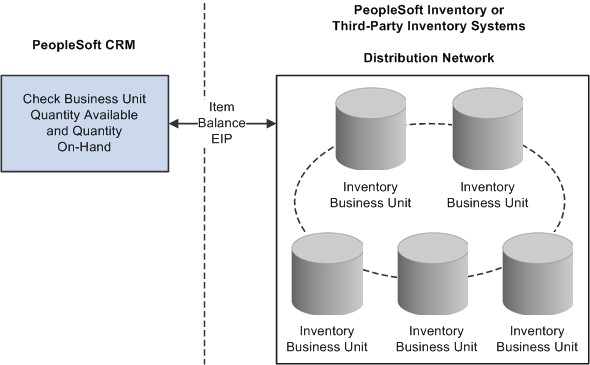

PeopleSoft CRM uses the Item Balance enterprise integration point (EIP) to retrieve quantity available and on-hand balance information in real-time from the inventory business units that are included in the distribution network that is defined for customer support or field service operations. The sequence of business units reflects their order in the distribution network.
Note. When integrating with PeopleSoft Purchasing and Inventory, you define a distribution network of inventory business units for each business unit in PeopleSoft CRM that can request material for service orders or as replacements or exchanges for material returns.
This diagram illustrates the integration between PeopleSoft CRM and your inventory and procurement system that supports checking quantity that is available and on hand in the inventory distribution network:
Data flow from inventory systems to PeopleSoft CRM
