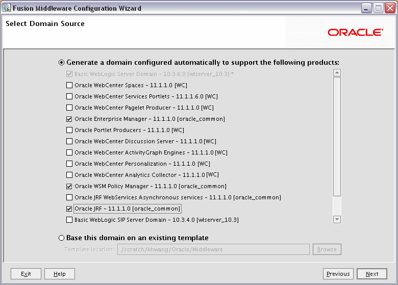

In the Welcome screen, select Create a New WebLogic Domain, and click Next.
The Select Domain Source screen appears (Figure 8-1).
In the Select Domain Source screen, do the following:
Select Generate a domain configured automatically to support the following products.
Select the following products:
Basic WebLogic Server Domain - 10.3.6.0 [wlserver_10.3] (this should be selected automatically)
Oracle Enterprise Manager - 11.1.1.0 [oracle_common]
Oracle WSM Policy Manager 11.1.1.0 [oracle_common]
Oracle JRF - 11.1.1.0 [oracle_common] (this should be selected automatically)
If you accidentally deselect some of the targets, make sure that the following selections are made in this screen:
Oracle JRF
Click Next.

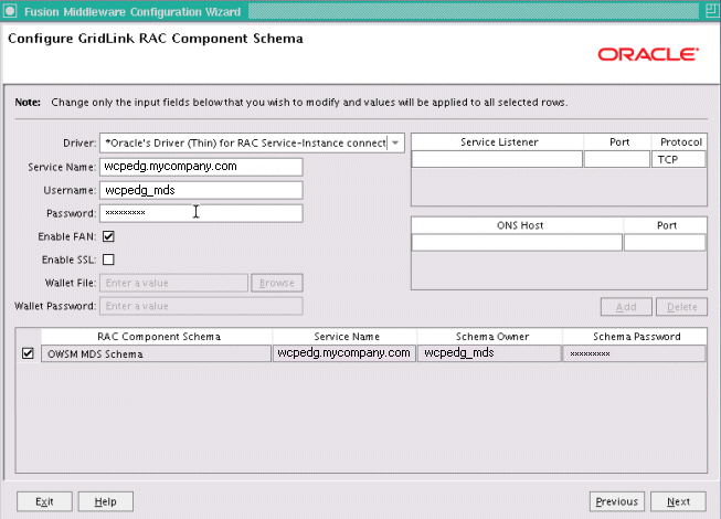

The Configure Gridlink RAC Component Schema screen displays (Figure 8-2).
Figure 8-2 Configure GridLink RAC Component Schema
In this screen enter values for the following fields, specifying the connect information for the Oracle RAC database that was seeded with RCU:
Driver: Select Oracle's driver (Thin) for GridLinkConnections,Versions:10 and later.
Service Name: Enter the service name of the Oracle RAC database in lowercase letters, followed by the domain name. For example, wcpedg.mycompany.com.
Username: Enter the complete user name (including the prefix) for the database schema owner of the corresponding component.
Password: Enter the password for the database schema owner.
Select Enable FAN.
Make sure Enable SSL is unchecked (alternatively if SSL is selected for ONS notifications to be encrypted, provide the appropriate wallet and wallet password).
Service listener: Enter the Oracle Single Client Access Name (SCAN) address and port for the Oracle RAC database being used. The protocol should be TCP.
Oracle recommends that you use SCAN addresses to specify the Service Listener (and OSN Host) so you do not need to update a GridLink data source containing SCAN addresses if you add or remove Oracle RAC nodes. To determine the SCAN address, query the remote_listener parameter in the database using the TCP protocol:
SQL>show parameter remote_listener; NAME TYPE VALUE ----- ------ ------- remote_listener string db-scan.mycompany.com:1521
For database versions that do not support SCAN:
For Oracle Database 11g Release 1 (11.1), enter the Virtual IP and port of each database's instance listener, for example:
custdbhost1-vip.mycompany.com (Port 1521)
and
custdbhost2-vip.mycompany.com (Port 1521)
For Oracle Database 10g, use multi data sources to connect to an Oracle RAC database. For information about configuring multi data sources see Appendix A, "Using Multi Data Sources with Oracle RAC".
ONS Host: Enter the SCAN address for the Oracle RAC database and the ONS remote port, as reported by the database:
[orcl@db-scan1 ~]$ srvctl config nodeapps -s ONS exists: Local port 6100, remote port 6200, EM port 2016
For Oracle Database 11g Release 1 (11.1), enter the host name and port for the database's ONS service. For example:
custdbhost1.mycompany.com (Port 6200)
and
custdbhost2.mycompany.com (Port 6200)

When the servers are started, verify that the GridLink data sources are correctly configured for the MDS schema and that the ONS setup is correct. Perform this procedure for every GridLink data source created.
To validate the GridLink data source configuration:
Log on to the Oracle WebLogic Administration Console.
In the Domain Structure tree, expand Services, and select Data Sources.
Click one of the new data sources.
Click the Testing tab, select one of the servers, and click Test Data Source.
Click the Monitoring tab and select on one of the servers.
Click the ONS tab, and then click the Testing tab.
Select the server and click Test ONS.
If both tests are successful, the configuration is correct. If the ONS test fails, verify that the ONS service is running in the RAC database nodes:
