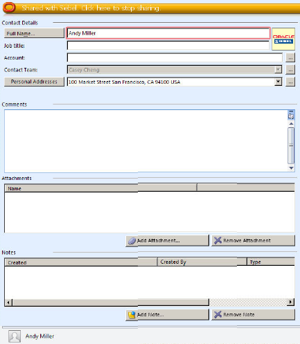

Figure 12 illustrates a portion of the contact form that Siebel CRM Desktop displays before you remove the notes section.
Figure 12. Notes Section of the Contact Form
