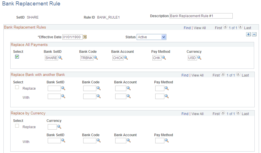

Bank Replacement Rule Page
Use the Bank Replacement Rule page (BANK_RPL_RULE_DEFN) to define bank replacement rules.
Image: Bank Replacement Rule page (1 of 2)
This example illustrates the fields and controls on the Bank Replacement Rule page (1 of 2). You can find definitions for the fields and controls later on this page.
Image: Bank Replacement Rule page (2 of 2)
This example illustrates the fields and controls on the Bank Replacement Rule page (2 of 2). You can find definitions for the fields and controls later on this page.
Use the Select check box to select the bank replacement options that you want to include in the bank replacement rule.
Replace All Payments
| Bank SetID, Bank Code, and Bank Account |
Enter the identifying information for the bank account from which you want to pay all payments in the pay cycle. This bank account will replace all original bank accounts for the payments selected to run in the pay cycle. |
| Pay Method |
(Optional) Select a replacement payment method. Available payment methods include:
This payment method will replace the original payment method on all payments selected for the pay cycle, as long as the original payment method is System Check, EFT, ACH, or Giro-EFT. Payments with any other original payment method specified will still be paid in that original payment method. If you do not specify a payment method, the payments will be made using the payment method specified on the voucher. Note: If the payment will be made using the original payment method, and that payment method is not available for the replacement bank, the system will generate a bank replacement exception and the payment will be dropped from the pay cycle. See Bank / Method Page. |
| Currency |
(Optional) Specify a replacement currency. This currency will replace the original currencies specified on all payments selected for the pay cycle. The currency conversion uses the payment date to determine the exchange rate. If you do not specify a currency, the payments will be made in the currency specified on the voucher. Note: If you do not specify a replacement currency and the currency on the voucher is not valid for the replacement bank, the system will generate a bank replacement exception and the payment will be dropped from the pay cycle. |
Note: You cannot select any other replacement options when you select Replace All Payments.
Replace Bank with Another Bank
Select to have all payments from a specified bank account (and optionally, payment method) paid from a replacement bank account (and optionally, payment method).
In the Replace row, enter the identifying information for the original bank account that you want to replace. Do the same in the With row for the replacement bank account.
The bank SetID, bank code, and bank account are required, but the payment method is optional. If you opt to replace the payment method, the same conditions apply as when you specify a replacement payment method for the Replace All Payments option.
Note: The replacement bank account must support the currencies supported by the original bank account. If the original currency on a voucher is not valid for the replacement bank, the system generates a bank replacement exception and the payment is dropped from the pay cycle.
Replace by Currency
Select to have all payments in a specified currency paid from a replacement bank account.
Enter the currency and the identifying information for the replacement bank account. Payment method is optional, and if you opt to replace the payment method, the same conditions apply as when you specify a replacement payment method for the Replace All Payments option.
Note: The currency must be valid for the replacement bank account.

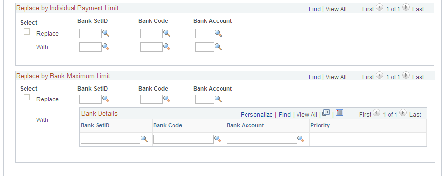

Replace by Individual Payment Limit
Select to assign an alternate bank account to any individual payment that exceeds a monetary amount limit that is predefined for the original bank account.
Enter the identifying information for the original bank account in the Replace row, and enter the identifying information for the replacement bank account in the With row.
Note: You set up the maximum amount for an individual payment from a bank account on the External Accounts - Account Information page.
Replace by Bank Maximum Limit
Select to assign an alternate bank account to any payments that remain after the monetary total of accumulated payments from a single bank account exceeds a defined monetary limit for that bank account.
Enter the identifying information for the original bank account in the Replace row, and enter the identifying information for the replacement bank accounts in the With grid. You can enter multiple replacement bank accounts for each original bank account that you specify. The Pay Cycle process assigns payments to each replacement bank account in the order that you add them to the grid, moving on to the next replacement bank account when an earlier bank account in the order has reached its maximum payment limit.
When you save or refresh the page, the Priority field is populated with a number indicating the processing order. The first row has priority 1, the second has priority 2, and so forth.
