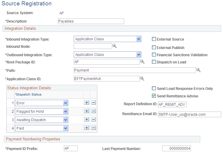

Source Registration Page
Use the Source Registration page (PMT_REGISTRATION) to register a subsystem to integrate with PeopleSoft Financial Gateway, and define high-level registration details.
Image: Source Registration page (1 of 2)
This example illustrates the fields and controls on the Source Registration page (1 of 2).

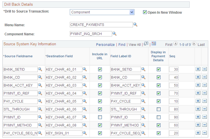

Image: Source Registration page (2 of 2)
This example illustrates the fields and controls on the Source Registration page (2 of 2).
We deliver PeopleSoft Payables with defined integration values, as shown in the page screenshots. Your organization's integration values may be different, based on your business needs.
You should avoid editing any of the delivered values, except for these:
  • Dispatch Status: Add any required payment dispatch statuses.
  • Display in Payment Details: Select or deselect check boxes to determine field display on the Review Payment Details page.
  • Seq (sequence): If you select a field for display, entering a sequence value determines the display order. You can edit this value.
