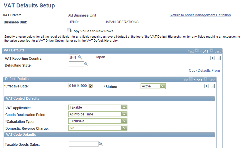

VAT Defaults Setup Page
Use the VAT Defaults Setup page (VAT_DEFAULTS_DTL) to access VAT defaults to the journal line for the general ledger business units, source, and account.
The default fields are available on the VAT Defaults Setup page for the business unit, the source, and the account based on the page where you select the VAT Default link.
Click the VAT Default link on either the General Ledger Definition - VAT Defaults page, the Journal Source - Definition page, or the Define ChartField - Account page.
Note: The default values on this page are dependent on the VAT driver that you select. This example uses the BUS_UNIT_TBL_GL VAT driver.
Image: VAT Defaults Setup page (1 of 2)
This example illustrates the fields and controls on the VAT Defaults Setup page (1 of 2). You can find definitions for the fields and controls later on this page.

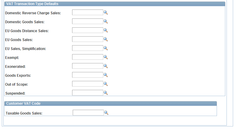

Image: VAT Defaults Setup page (2 of 2)
This example illustrates the fields and controls on the VAT Defaults Setup page (2 of 2). You can find definitions for the fields and controls later on this page.
Note: The VAT Defaults Setup pages are described in detail in the PeopleSoft Enterprise Global Options and Reports, "Working with VAT."

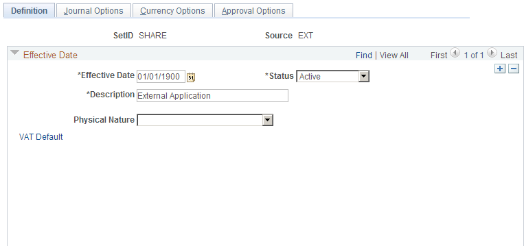

Journal Source Definition Page
Use the Journal Source - Definition page (SOURCE1) to specify whether the source is for goods or services and select the VAT Default link to define additional central VAT defaults.
Image: Journal Source - Definition page
This example illustrates the fields and controls on the Journal Source - Definition page. You can find definitions for the fields and controls later on this page.

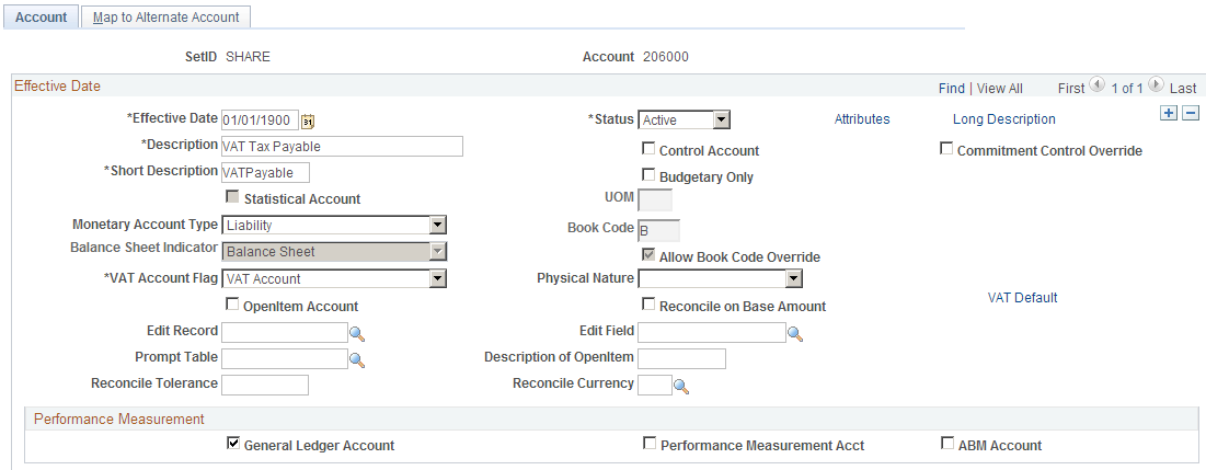

Setting Up VAT Defaults for an Account
Use the Account page (GL_ACCOUNT) to specify whether the account is for goods or services and select the VAT Default link to define additional central VAT defaults.
Image: Account page
This example illustrates the fields and controls on the Account page. You can find definitions for the fields and controls later on this page.
