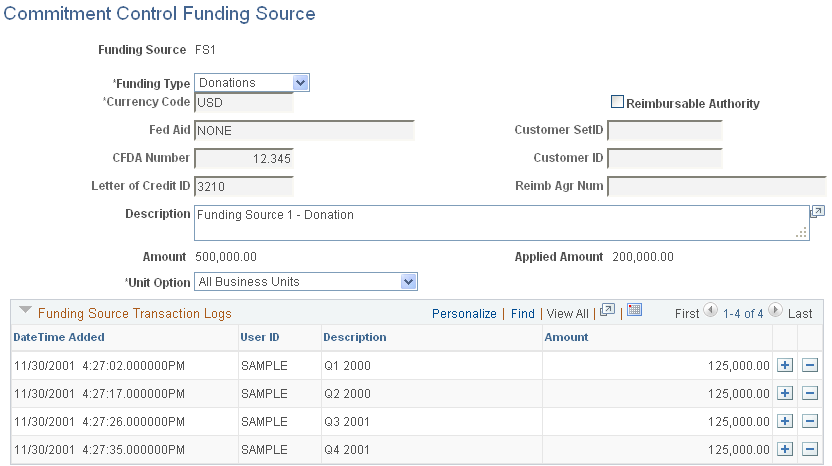

Commitment Control Funding Source
KK_FUND_SOURCE
select Commitment Control, then select Define Control Budgets, then select Funding Source, then select Commitment Control Funding Source
Identify funding sources and enter funding amounts.

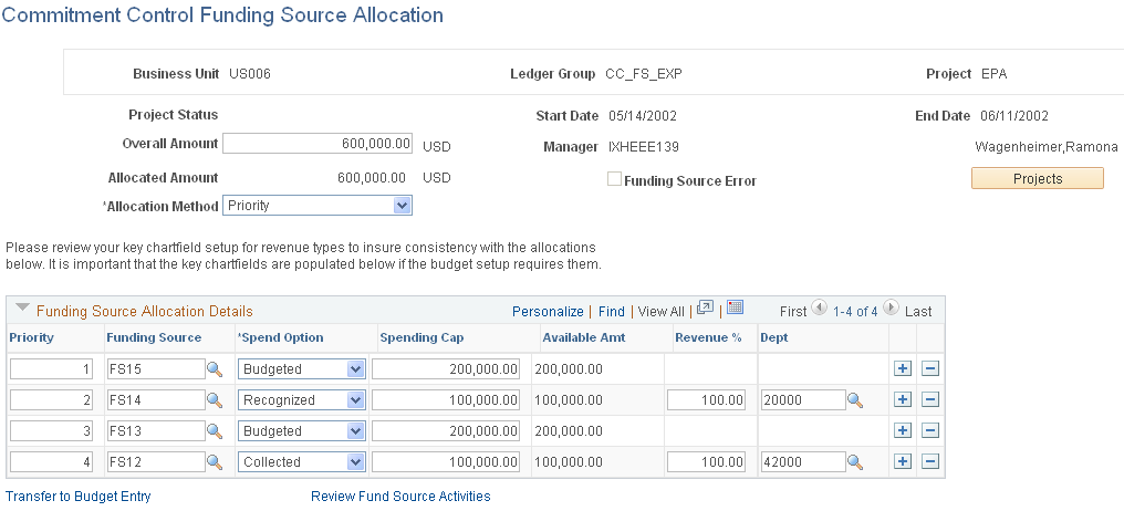

Commitment Control Funding Source Allocation
KK_FS_ALLOCATION
select Commitment Control, then select Define Control Budgets, then select Funding Source Allocation, then select Commitment Control Funding Source Allocation
Allocate funding source amounts to a budget and identify spending options.

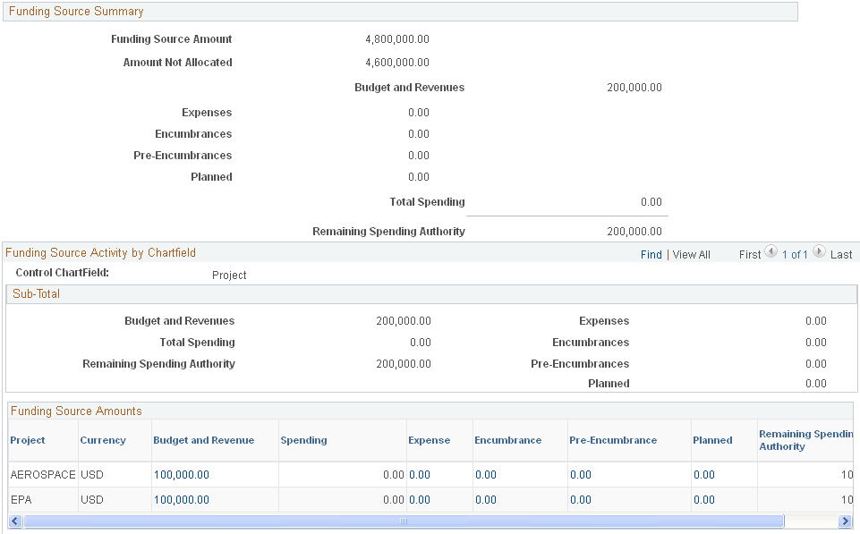

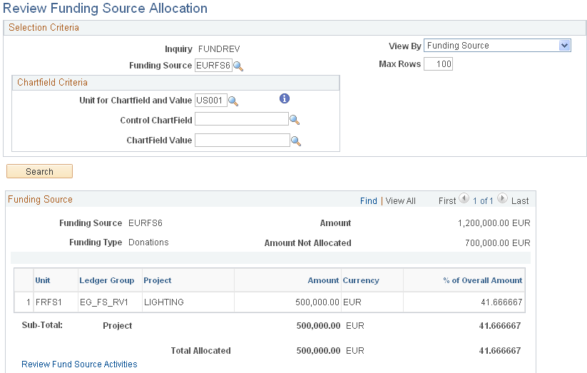

Review Funding Source Allocation
KK_FS_INQA
select Commitment Control, then select Review Budget Activities, then select Review Fund Source Allocations, then select Review Funding Source Allocation
View the allocation of funding sources for expenditure budgets (control ChartFields) and recognized and collected revenue by funding source or control ChartField.

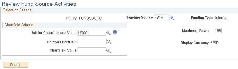

Review Fund Source Activities
KK_FS_ALOG_INQ
select Commitment Control, then select Review Budget Activities, then select Review Fund Source Activities, then select Review Fund Source Activities
You can also click the Review Fund Source Activities link on the Commitment Control Funding Source Allocation page.
You can also click the Review Fund Source Activities link on the Review Fund Source Allocations page.
View spending activities at control ChartField and ChartField value for a specific funding source.

  4. Define funding sources on the Commitment Control Funding Source page.
    Enter funding source amounts and adjustments on the Funding Source Transaction Logs grid. The page calculates the total funding source amount by aggregating the amounts that you enter on the grid and also displays a running total of the amounts applied using the funding source allocation page.
    Define fund sources by all business units or control access to fund source information by defining a funding source by a single or multiple business units that are accessible to selected users of your choosing.
    Using the Installation Options - Commitment Control page, you can activate and use three user-defined fields to report and track fund source information.
    When activated, the two additional character fields and one date field are available on the Funding Source Definition page. The fields are for information only and do not programmatically affect the allocation process or spending against funding allocations.

  6. On the Commitment Control Funding Source Allocation page, enter the overall spending amount approved for the budget and allocate funding sources and amounts for each Control ChartField for which you require the use of funding source tracking. Use one of the following methods to allocate funding sources:
    • Percentage: You can define funding source amounts as a percentage of the overall spending amount, and establish a spending cap amount for each funding source.
    • Priority: You can choose to allocate and expend against the overall spending amount by priority. Establish a spending cap amount for each funding source.
      For example, you decide that you want to first spend against FS5 (fund source 5) and then by FS1 (funding source 1), and so on according to the spending priority that you define.
      The page automatically sums up the spending caps and puts the sum in the Allocated Amount field. For both methods, the allocated amount has to be equal to the overall spending amount for the budget processor to be able to use the allocation. If the allocated amount is greater than the overall spending amount, you cannot save the page. But if the allocated amount is less than the overall spending amount, you can save the page, but the budget processor is not able to use this allocation because the Funding Source Error flag is activated in such cases.
      Note: The percentage and priority methods are mutually exclusive and the two methods cannot be used in combination for the same funding source allocation.
      You can save a funding source allocation for which you have not yet fully completed the allocation; however, the system will not process expenditures against the funding source allocation until you have reopened the Commitment Control Funding Source Allocation page and fully allocated the overall spending amount that you assigned to the funding source allocation. You cannot override a partial allocation or a zero priority number error generated by Budget Processor.

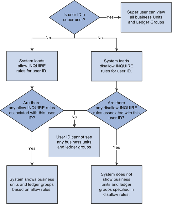

Commitment control security augments the security provided by PeopleSoft applications and PeopleTools for row-level security for business units and ledger groups. However, the displaying of results for funding source inquires is primarily based on commitment control security setup.
Funding source inquires reference the commitment control Budget Inquire (INQUIRE) security event and your particular related securities setup and rules to determine which business units and ledger groups that are found by any given search criteria are displayed in the search results for a particular user ID.
Access to data for funding source allocations and activity inquiries depends on both commitment control and row-level security. However, the total allocation amount and amount not allocated, which is the total defined funding source amount less the sum of the allocations that were already set up across business unit and control ChartField, are calculated regardless of row-level and commitment-control security.
This diagram shows security behavior and the allow and disallow rules as applied to inquiry.
Image: Inquiry security
Inquiry security flow chart
Inquiry security
See Understanding Commitment Control Security.

Commitment Control Funding Source Page
Use the Commitment Control Funding Source page (KK_FUND_SOURCE) to identify funding sources and enter funding amounts.
Image: Commitment Control Funding Source page
This example illustrates the fields and controls on the Commitment Control Funding Source page. You can find definitions for the fields and controls later on this page.
When you select Specify Business Unit, use the add or delete buttons to add or delete business units in the Business Unit grid to provide access to funding source when you are doing funding source allocation.
Each row in the Funding Source Transaction Logs grid is additive and not alterable. To adjust the total funding source Amount field, add or delete a row. Add rows as needed by selecting the add button; however, only five fields are displayed at a time. Use the scroll to see additional rows. The Date Time Added and the User ID fields are populated by the system when the row is added. Date Time Added is an informational field.
Enter a description and amount for each row that you add.
Note: Business units, which have prior funding source allocations, cannot be deleted from the funding source page.
See Commitment Control Funding Source Allocation Page.
Use the Commitment Control Funding Source Allocation page (KK_FS_ALLOCATION) to allocate funding source amounts to a budget and identify spending options.
Image: Commitment Control Funding Source Allocation page for priority allocation (1 of 2)
This example illustrates the fields and controls on the Commitment Control Funding Source Allocation page for priority allocation (1 of 2). You can find definitions for the fields and controls later on this page.
Image: Commitment Control Funding Source Allocation page for percentage allocation (2 of 2)
This example illustrates the fields and controls on the Commitment Control Funding Source Allocation page for percentage allocation (2 of 2). You can find definitions for the fields and controls later on this page.
Note: Review your key ChartField setup for revenue types to ensure consistency with the funding source allocations. The key ChartFields must be populated if the budget setup requires them. Funding source allocation is not effective-dated, while the budget definition is. The budget definition can have a row with a secondary key such as department and another row with a secondary key such as program. In such cases, the Allocation page shows both department and program on the revenue rows. Confirm that you have the appropriate secondary key value entered, because the system does not make this determination for you.
To access this page for an existing funding source allocation or to create a new allocation, enter the business unit, the funding source-enabled expenditure ledger group, and the project, or control ChartField, to which you are allocating funding sources.
See Understanding Entering and Posting Commitment Control Budget Journals.
Review Funding Source Allocation Page
Use the Review Funding Source Allocation page (KK_FS_INQA) to view the allocation of funding sources for expenditure budgets (control ChartFields) and recognized and collected revenue by funding source or control ChartField.
Image: Review Funding Source Allocation page
This example illustrates the fields and controls on the Review Funding Source Allocation page. You can find definitions for the fields and controls later on this page.
Use the View By field to choose the inquiry perspective that determines how you want to view inquiry results.
View by the Funding Source Inquiry Perspective
From the funding source perspective, you can:
  • View inquiry results by funding source for all Control ChartFields, and all ChartField values for all funding sources.
    To do so, select Funding Source from the view by drop-down menu. If you leave funding source, control ChartField, and ChartField blank, the result includes all funding sources, all control ChartFields, and all ChartField values for which you have funding source allocations set up.
  • View inquiry results by funding source but limit the results to only a Control ChartField of interest, all its control ChartField values, and all funding sources.
    To do so, select Funding Source from the view by drop-down menu. Select a business unit from the prompt for Unit for Chartfield and Value field, select a control ChartField from the prompt, and leave the ChartField Value field blank.
  • View inquiry results by funding source but limit the results to a specific fund source, control ChartField, and ChartField value.
    To do so, select Funding Source from the drop-down menu. Select a business unit from the prompt for the Unit for Chartfield and Value field, select a Control ChartField from the prompt, and select a valid value from the Chartfield Value prompt.
  • View inquiry results by funding source but limit the results to Control ChartField values of interest and all applicable funding sources.
    To do so, select the funding source from the drop-down menu, select a control ChartField, and specify a control ChartField Value while leaving the Funding Source field blank.
View by the Control ChartField Inquiry Perspective
From the control ChartField perspective you can:
  • View inquiry by Control ChartField for all Control ChartFields, all control ChartField values, and all funding sources.
    To do so, select the Control ChartField from the view by drop-down menu and leave the Funding Source, Control Chartfield, and the Chartfield Values fields blank.
  • View inquiry by Control ChartField for a particular Control ChartField, all values for the Control ChartField, and all funding sources.
    To do so, select Control Chartfield from the view by drop-down menu. Select a business unit from the prompt for the Unit for Chartfield and Value field, select a control Chartfield from the prompt, and leave the Chartfield Value field blank. Also, leave the Funding Source field blank.
  • View inquiry by Control ChartField for a Control ChartField, a particular control ChartField value, and all funding sources.
    To do so, select Control Chartfield from the view by drop-down menu. Select a business unit from the prompt for the Unit for Chartfield and Value field, select a control Chartfield from the prompt, and select a valid value from the Chartfield Value field prompt. Leave the Funding Source field blank.
  • View inquiry by Control ChartField for a Control ChartField, a control ChartField value, and a funding source.
    To do so, select Control Chartfield from the view by drop-down menu. Select a funding source. Select a business unit from the prompt for the Unit for Chartfield and Value field. Select a Control Chartfield from the prompt, and select a valid value from the Chartfield Value prompt.
Review Fund Source Activities Page
Use the Review Fund Source Activities page (KK_FS_ALOG_INQ) to view spending activities at control ChartField and ChartField value for a specific funding source.
Image: Review Fund Source Activities page (1 of 2)
This example illustrates the fields and controls on the Review Fund Source Activities page (1 of 2). You can find definitions for the fields and controls later on this page.
Image: Review Fund Source Activities page (2 of 2)
This example illustrates the fields and controls on the Review Fund Source Activities page (2 of 2). You can find definitions for the fields and controls later on this page.
Fund Source Available Amount Drill-Down Page
Use the Fund Source Available Amount Drill-Down page (KK_FS_BUDREV_DRL) to displays the available amount for a funding source by control ChartField, business unit, ledger group by currency for budgeted, recognized, and collected revenue.
No further drilldown is available from this page.
Access the Fund Source Available Amount Drill-Down page (click the Amount link under Budget and Revenue on the Review Fund Source Activities page).
Image: Fund Source Available Amount Drill-Down page
This example illustrates the fields and controls on the Fund Source Available Amount Drill-Down page. You can find definitions for the fields and controls later on this page.
This page displays the budget and revenue amounts that are available to the funding source by business unit and ledger group.
Drilling Down to Planned, Pre-encumbrance, Encumbrance, and Expenditure Activity
