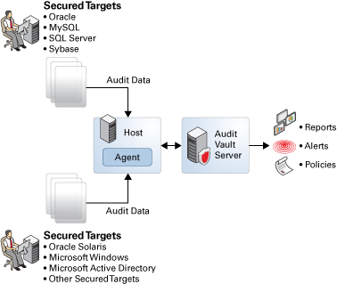

The following figure shows how Oracle Audit Vault and Database Firewall collects Oracle Solaris audit records from designated secured targets. A secured target is any system that stores audit records or data.
Figure 2  Oracle Solaris and Audit Vault
image:Graphic shows how Oracle Solaris and Audit Vault work together to handle alerts and create reports according to audit policy.
A host system is designated to run the AV agent that communicates with Oracle Audit Vault and Database Firewall. The agent enables Oracle Audit Vault and Database Firewall to receive and process audit data from secured targets. The agent reads the audit records from a designated audit trail on the secured target. These audit records are encoded in the native binary format. The agent converts the data to a format parseable by Oracle Audit Vault and Database Firewall. Oracle Audit Vault and Database Firewall receives the data and generates reports for administrators and security managers as required.
The agent can be installed on a secured target instead of on a separate system. Multiple hosts with agents can also be configured to connect to the Audit Vault server. However, when registering secured targets, indicate a specific system with which the AV server communicates to obtain audit data.
