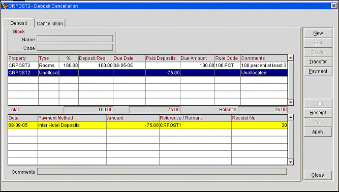

Accept advance deposits across properties. Advance deposits can be accepted for reservations at another property. OPERA's Inter Property Account processes make the deposit information immediately available at the property where the guest will be staying.

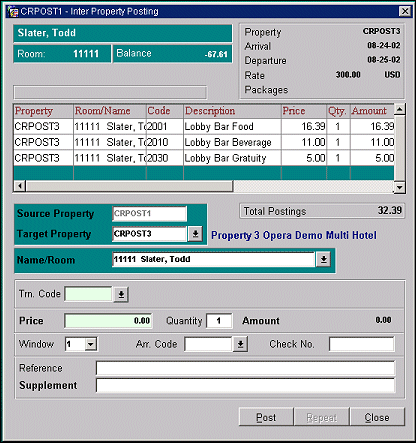

Select Cashiering>Cross Property Posting>Inter Property Posting. When you are prompted for your Cashier login and password, enter the information as you usually do. The same login ID and password you normally use may be used for posting cross property transactions. Once you have logged in, the Inter Property Posting screen appears.
The top portion of the screen shows information about the account belonging to the guest to which you are posting transactions. These view only fields do not populate until you have selected the guest for whom you wish to post transactions.
Name. The name of the guest to whose account transactions are being posted.
Room. The guest's room number.
Balance. The guest's current account balance as shown on the guest's Billing screen. This balance will change dynamically to reflect the transactions you post to this guest's bill.
Property. The property where the guest is staying. The target property.
Arrival. The guest's arrival date.
Departure. The guest's departure date.
Rate. The guest's room rate.
Packages. The codes for any packages attached to the guest's reservation.
The grid in the center of the screen displays the transactions as they are posted. Total Postings shows a view only running total of postings made to the guest's account during the current session.
The lower portion of the screen contains the fields for new transaction information. To post a transaction, provide the appropriate information and select the Post button.
Source Property. This view only field auto-populates with your default login property. You cannot change this value.
Target Property. Select the down arrow to list all properties in your cross property posting cluster. The List of Cross Posting Capable Resorts includes properties meeting these criteria:
Your own property is not listed here because you cannot use cross posting to post transactions to guests at the local property. When you select a property code from the LOV, the descriptive name of the property appears to the right of the field.
Name/Room. Once a property has been selected, the Name/Room field becomes active. Select the down arrow to display the In House Guest Search screen for the Target Property you selected. Only guests and posting masters with a current reservation status of CHECKED IN or DUE OUT are displayed on this screen. When you make your selection, the guest's name and room number will be shown in the Name/Room field.
Trn. Code. Select the down arrow to display the display the Transaction Codes list of values. These are the transaction codes configured as "manual" post for your own property. When you have selected a transaction code for this posting, the description appears to the right of the field. (The description, along with any information you enter in the Supplement field, will appear in the Supplement field on the guest's Billing screen.)
Note: You may not post paid outs, payments, or room charge via cross-property posting.
Price. Enter the unit price of the transaction. You may enter positive or negative values.
Quantity. Enter the quantity of the transaction. The system defaults to 1. Both positive and negative values may be entered here.
Amount. The total amount of the transaction (Quantity x Price).
Window. Choose the Billing screen window in which the transaction is to be displayed. You may choose to place all transactions in window 1 or enter another window number. If the window does not exist, OPERA creates it. If routing instructions have been defined for this guest's Billing screen, the transaction is automatically placed in the appropriate window.
Check No. If your system has a POS interface, the POS information is posted here. You may also enter a check number manually.
Arr. Code. Select the down arrow to choose an arrangement code for this transaction. The arrangement code can be used to format transaction information on the guest folio.
Reference. Enter a comment regarding the transaction (e.g., the F&B ticket number if you track those tickets). This field is meant for consistent information capture.
Supplement. Enter a comment regarding this transaction, if needed. The comment, along with the description of the transaction, appear in the Supplement field on the guest's Billing screen.
Post. Posts the transaction to the guest account.
Note: Should the amount not meet the Minimum or Maximum amount that may have been set for the transaction code, then a message is displayed notifying the user what the minimum or maximum amount for the transaction code is. The user can then select to continue to post with the current amount or stop the posting completely.
Repeat. To repeat a posting either exactly as before or with changes, highlight the entry you wish to repeat in the grid area, make changes as necessary to the transaction information fields, and select Repeat.

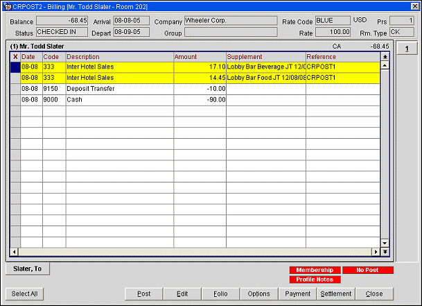

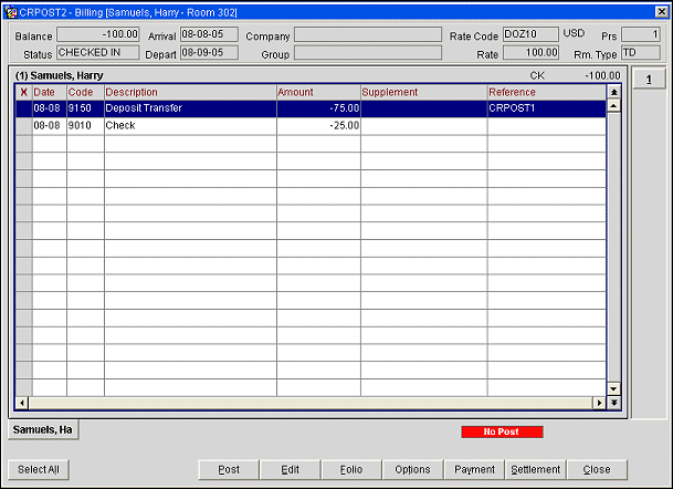

As soon as a charge is posted from the source property to a guest’s bill at the target property, the charge appears on the guest’s Billing screen at the target property highlighted in yellow with the Reference column showing the property where the posting originated. (See Billing Screen below.)
The guest's Billing screen at the property where the guest is staying immediately reflects cross property transactions and advance deposits. Postings for services consumed at other properties are highlighted in yellow for easy identification. In addition, the Reference field for transactions posted at another property shows the property ID. You may sort on the Reference field to see at a glance all cross property postings by source property.
Note: When the cursor is placed on a cross property posting, the Adjust and Split right-click option buttons are unavailable.
Cross property postings always display as single-line items, regardless of whether the charge is inclusive or exclusive of tax and other generate charges. For example, if the guest charges $10 worth of Restaurant Food, and Restaurant Food transactions have a generate 6% tax, the transaction on the guest's Billing screen will show as a single Inter Hotel Sales entry for $10.60 rather than a $10 Restaurant Food entry and a $0.60 Tax entry.
Note: If taxes are associated with a posting, they are recorded in the Inter Property Account. Such taxes are shown on the Cross Postings - Payments/Reconciliations screen Total Owed to Other Properties tab and Total Owed From Other Properties tab. Taxes will also be broken out for property reporting purposes.
The Transaction Code and Description fields show that the transaction is an Inter Hotel Sales transaction. These are internal transaction codes defined by your property to indicate cross property postings. The Supplement field shows the description of the transaction code as entered at the source property. The field also includes any supplemental information that may have been added at the time the posting was made.
Note: When cross property phone charges are posted to a guest's Billing screen, the Reference field shows the property ID, the originating room number, the phone number dialed, and the duration of the call.

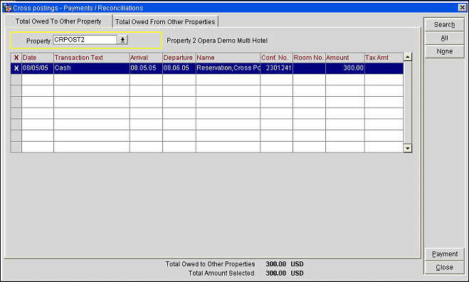

The Cross Postings Payments/Reconciliations screen provides features for managing the Inter Property Account, which is central to the Cross Property Posting feature:
The screen has two tabs. One identifies monies owed to other properties by your property (Total Owed to Other Properties) and the other identifies monies owed to your property from other properties and shows payments that are forthcoming (Total Owed From Other Properties).
Once a tab has been selected, choose the property you wish to work with by selecting from the Property list of values. This LOV shows the other properties in your cross property cluster. The full name of the property you selected appears to the right of the field.
This tab lets you review outstanding amounts that your property owes to other properties in your cross property posting cluster. The grid shows all outstanding transactions originating at the property selected in the Property field. These transactions were posted to the accounts of guests residing at your property for services consumed at that property. Use this tab to select the transactions to make payment to the property where they originated. You may also use this tab to select the transactions for which you intend to make payment.
Enter your search options and select the Search button.
Property. Select the down arrow to choose a property to which inter-property posting amounts are owed. Available if outstanding postings are owed to at least one other property.
The grid displays the following information.
X. An X in this column indicates that you have selected the transaction for payment. To select an item, click in the X column or highlight the item and press the spacebar. Use the All and None buttons to select all transactions or to un-select all transactions. Once you have selected one or more transactions, the Payment button becomes active.
Date. The date when the transaction was posted.
Transaction Text. The description of the transaction code, as provided by the originating property.
Name. The name of the guest to whose bill the charge was posted.
Conf Number. The guest's reservation confirmation number.
Amount. The amount of the transaction.
Note: If tax is included in the cost of the transaction (that is, if the transaction is inclusive), the value in the Amount column already includes that tax. If the transaction is exclusive of tax, the tax amount will populate the Tax Amt. column. When an exclusive transaction is selected for payment, the tax will automatically be selected for payment as well.
Tax Amount. The tax amount, if any, associated with the transaction.
Total Owed to Other Properties. The combined total amount of the outstanding transactions displayed on this tab.
Total Amount Selected. The combined total amount of the outstanding transactions you have selected for payment.

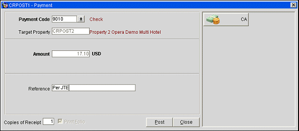

Select Yes to proceed. The Payment screen appears.
When you have entered the appropriate information, select the Post button to proceed. The transactions you selected for payment are removed from the grid and only the remaining outstanding transactions are displayed.
The Payment screen includes the following information:
Payment Code: From the list of values, select the transaction code for the payment method you wish to use. The description of the code appears to the right of the field.
Note: Payments for the Inter Property Account are to be settled via cash or check; no credit cards or A/R settlement are permitted.
Target Property. View only. The property where the transaction(s) selected for payment originated. The name of the property appears to the right of the field.
Amount. View only. The total amount of the transactions selected for payment. The currency appears to the right of the field. Only positive amounts may be posted. You are required to post against the exact total amount selected on the Cross Postings - Payments/Reconciliations screen's Total Owed To Other Properties tab.
Reference. Enter any reference information you wish in this field. This information will be printed on the receipt, but will not be visible to the target property when reconciling this payment.

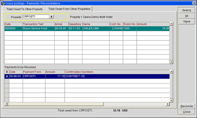

At the target property, users can access the Cross Postings - Payment/Reconciliation screen Total Owed From Other Properties tab and see that a property has posted a payment. This record includes the payment posting date, the paying property’s code, and the total amount. (See Total Owed from Other Properties Tab, below.)
Select the Total Owed From Other Properties tab to review information about what outstanding transactions your property has posted to the accounts of guests at other properties in the cross property cluster, and what payments are scheduled to be received by your property from those other properties.
The Total Owed From field at the bottom of the screen shows the full amount the selected property owes to your property (this field shows the combined total of all items listed in both the upper and lower grids).
As payments are processed by the properties that owe you monies (see Total Owed To Other Properties Tab, above), transactions in the upper grid are removed from the upper grid and included in a Payment To Be Received record in the lower grid. Each record in the Payments To Be Received grid can cover payment of one or more individual cross property transactions.
Property. Select the down arrow to choose a property from which inter-property posting amounts are owed. Available if outstanding postings are owed from at least one other property.
The upper grid shows outstanding postings for services consumed at your property by guests staying at the property shown in the Property list of values field. The lower grid shows any payments you may expect from the other property to cover transactions you posted for their guests.
The upper grid shows the following information:
Transaction Text. The description of the transaction code.
Guest Name. The name of the guest to whose bill the charge was posted.
The lower grid shows the following information.
X. An X in this column indicates that you have selected the payment record for reconciliation. To select an item, click in the X column or highlight the item and press the spacebar. Use the All and None buttons to select all records or to un-select all records in the Payments To Be Received grid.
Date. The date on which the payment record was issued by the paying property.
Payment From. The property from which payment is to be received.
Amount. The total amount of all transactions included in the Payment To Be Received.
Confirmation Numbers. A comma-separated list of the reservation confirmation numbers belonging to the guests whose transactions are being accounted for by the payment. Each confirmation number is followed by square brackets enclosing the amount of a separate transaction for that guest.
When the check or cash covering a Payment To Be Received item is in-hand, you may use the lower grid to reconcile the outstanding balances that exist in the Inter Property Account. To do so, choose the Payment To Be Received records to be reconciled and select the Reconcile button. (The Reconcile button is available when at least one Payment To Be Received transaction is selected in the lower grid.)
A message asks you to confirm that you wish to reconcile the selected payments. When you select the Yes button, the selected Payment To Be Received record will be removed from the lower grid and the Inter Property Account will be balanced for those outstanding transactions. Once reconciled, the received payment is recorded using your property’s Inter Hotel Payments code.
The Cross Property Posting feature allows you to post advance deposits for reservations at other properties in your cross property cluster, provided you have DEPOSITS user permission at the property where the reservation is being made. When deposits are applied across properties, OPERA reconciles them using the same Inter Property Account used for the reconciliation of cross property postings.
To apply an advance deposit to a guest reservation at another property, display the Reservation screen for the guest's upcoming stay at that property. (If you are starting from the Reservation Search screen, you must select the Advance button so that you can use the Property search criteria to find reservations at another property.)
From the guest's Reservation screen, select the Options button to display the Reservation Options screen. Then select Deposit/CXL. When the Cross Property Posting feature is active, your Cashier ID and password are valid for logging in to all properties in your cross property cluster.
The Deposit Cancellation screen appears. You may now post the advance deposit in the usual manner. (See Deposits for details on posting reservation deposits.)
From the Deposit Cancellation screen, select Payment.
The Payment Method for the deposit will be shown on the Deposit and Cancellation screen as the Inter Hotel Deposits transaction code set up for the property.
The deposit is immediately recorded as a credit to the guest by the property where the guest will be staying. When the guest checks in at the property where she has the reservation, the advance deposit appears on her Billing screen identified by whatever transaction code the property normally uses for deposits.

The guest folio displays cross property postings as a single line item in the posting section, regardless of whether the charge is inclusive or exclusive of tax. All taxes posted on the folio by another property appear in a separate tax breakdown section. The total tax for each property where the guest incurred charges appears on a single line in the tax breakdown section.
