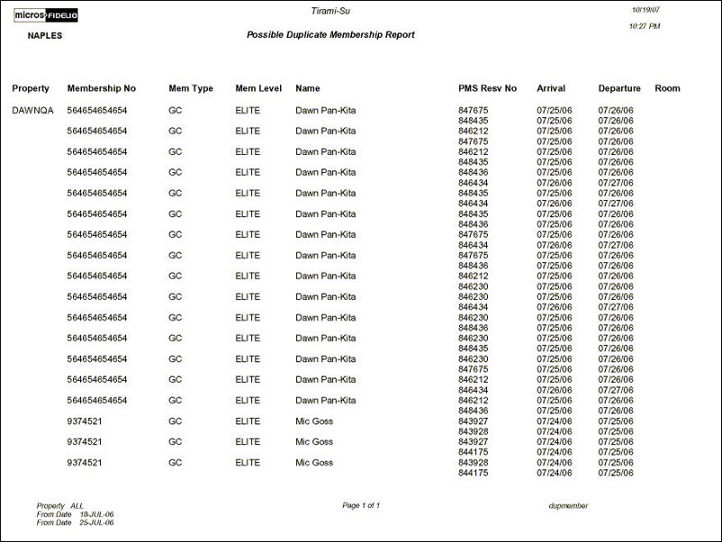

This report displays information to assist users in identifying when the profile, with a primary membership attached, has a Departure and Arrival date for the same day and/or multiple rooms with the same Arrival and Departure date. The report identifies those membership transactions which may need manual review by the client for point calculations for multiple room reservations and/or back-to-back stays.

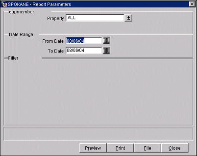

Property. Select the Property where Stay Records were inserted from.
From/To Date. Select the date range you want to view. The From Date is the arrival date and this is the parameter the system searches.
